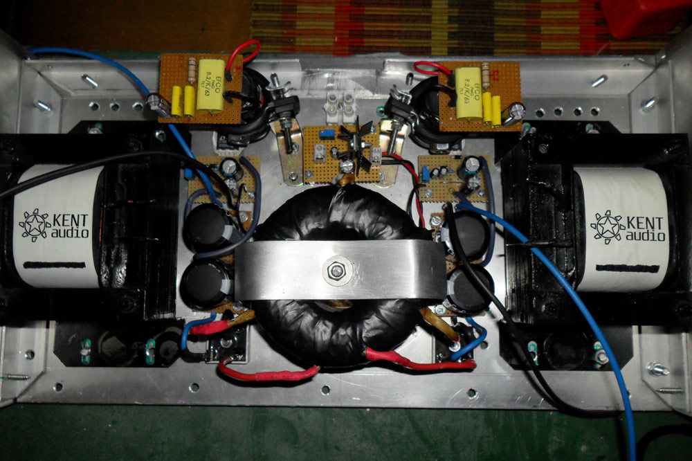

How does the choke loading compare to a simple resistor load (zen lite) or a CCS load in sound quality ?
I didn`t try any other load. I wanted to try the choke cos` I had them and they`re more efficient then ccs and a resistor load. The amp sounds very nice and transparent.

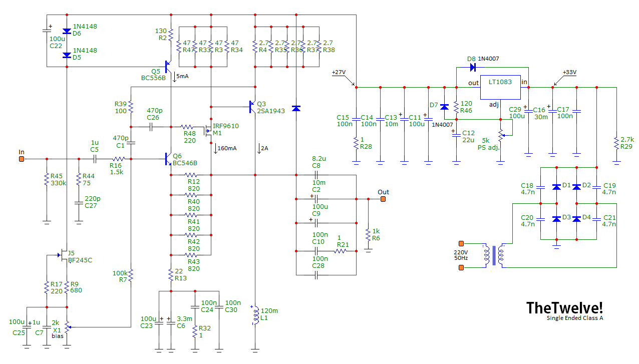

I`ve used the transformer I had so is 32Vpp with 2A bias in 8 Ohms load.
Bogdan, interesting schematics, with GNFB of a current type. I guess it has voltage gain around factor 7...8. Some things are not attractive to me, too much points with electrolytic caps, especially C5 in the NFB chain. Could you measure the value of output impedance?
I was also thinking that if the voltage of the output node wasnt too far above ground that the capacitors in the feedback could be eliminated with only a change in X1 (bias pot) value to give higher adjustment range.
Yes the voltage gain is 8x. C5 is film cap and it`s not in NFB chain. If you meant C6, I tried without it and the amp is thermaly unstable (bias depends on the Q6 themperature).
I don`t have the measuring equipment , but simulation says 0.0096 Ohms.
I also thinking that if the voltage of the output node wasnt too far above ground that the capacitors in the feedback could be eliminated with only a change in X1 (bias pot) value to give higher adjustment range.
The resistance of the coil is 0.9 ohms and that gives 1.8 Volts on the output with 2A bias, so in this case output cap is a must.

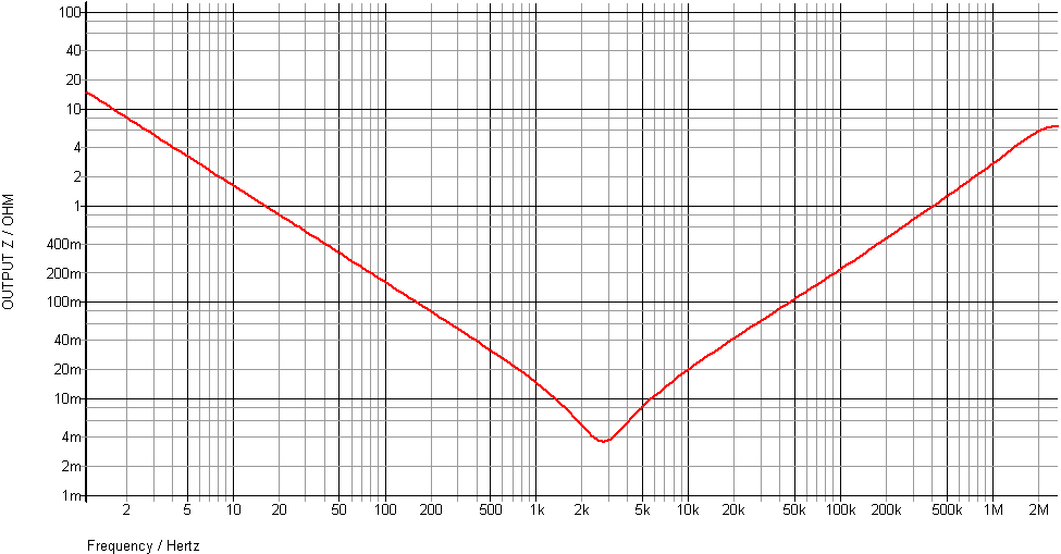

The compensation network values ruin the PSRR.
C1 need not to be higher than 47pF , while R39 should be better 1K
or even suppressed along with C26.
Other than this , the THD is quite low , wich is not surprising given
the high GNFB ratio , while the output Z has a minimum of about 4mR
at mid frequency and rise linearly on the low frequency side given the
capacitive coupling and the same on the high frequency side due
to inductive coupling.
Tried that, the amp oscilates in real life, with C1 47pF.
