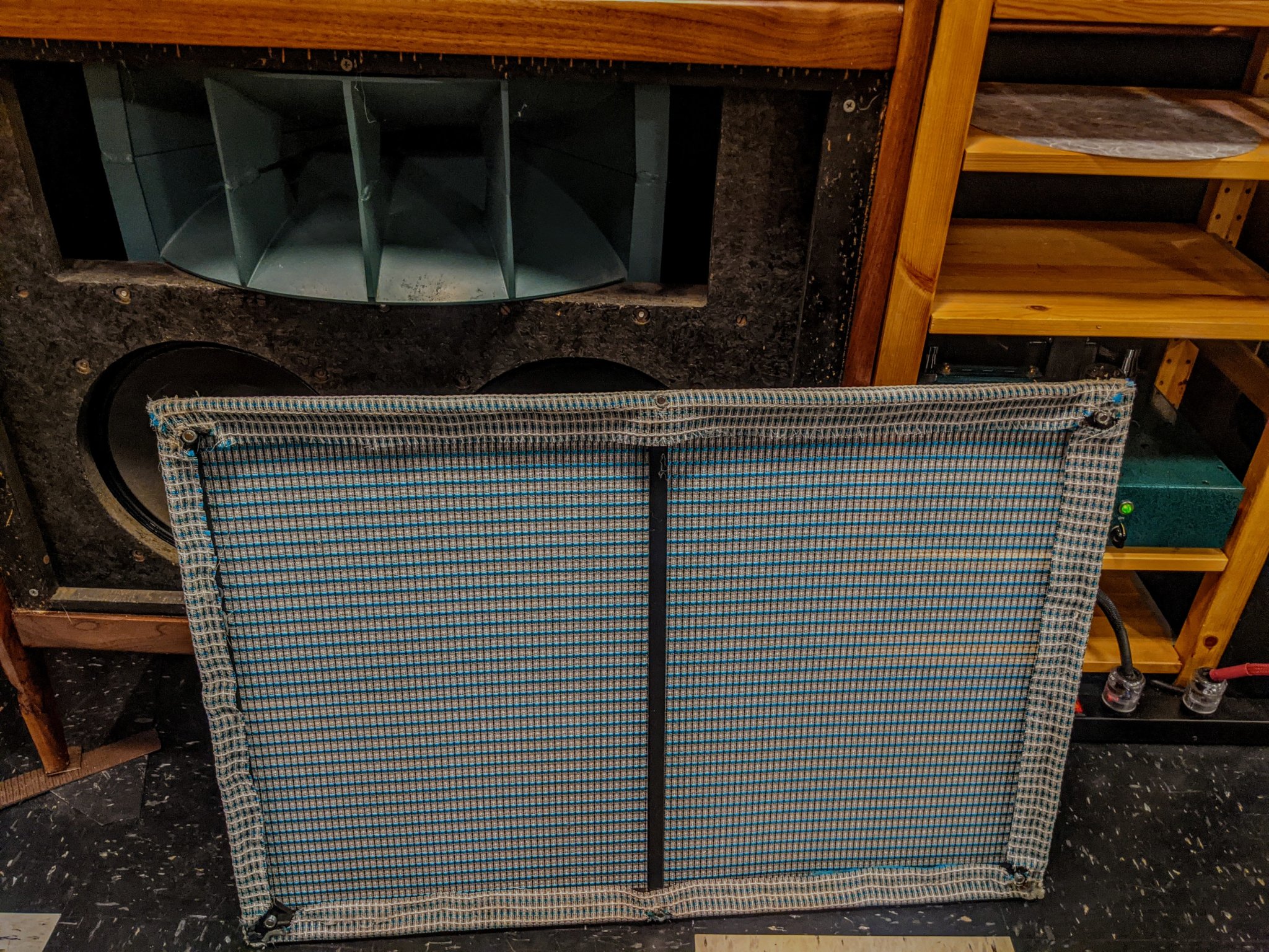

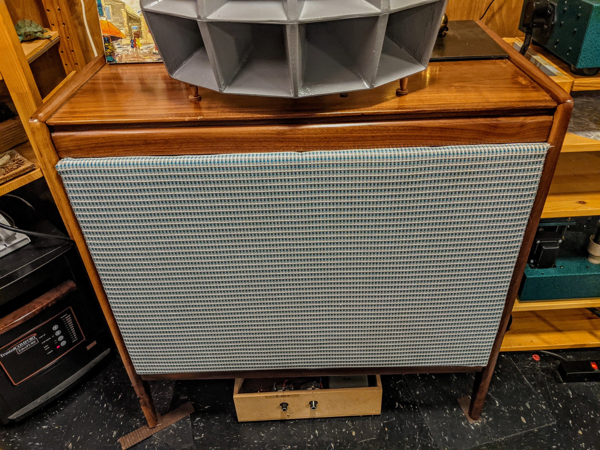

I used them for my Heathkit Legattos. Worked fine although attaching the speaker cloth was a challenge for me mostly due to my inexperience. I also used some round neodymium magnets mounted in the frame and screw-heads in the cabs for attachment. Looks OK from the front side.
