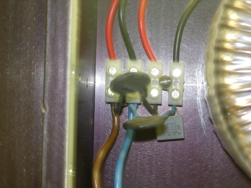

This is how i have done it. However I am a rookie at this so I would like to see other comments from experienced builders.

The power supply thermistors are not used for temperature sensing but for inrush current suppression. They limit surge current when powering up the amplifier by functioning as a power resistor which drops from a high cold resistance to a low hot resistance when heated by the current flowing through them. They do not need to be close to a source of heat.

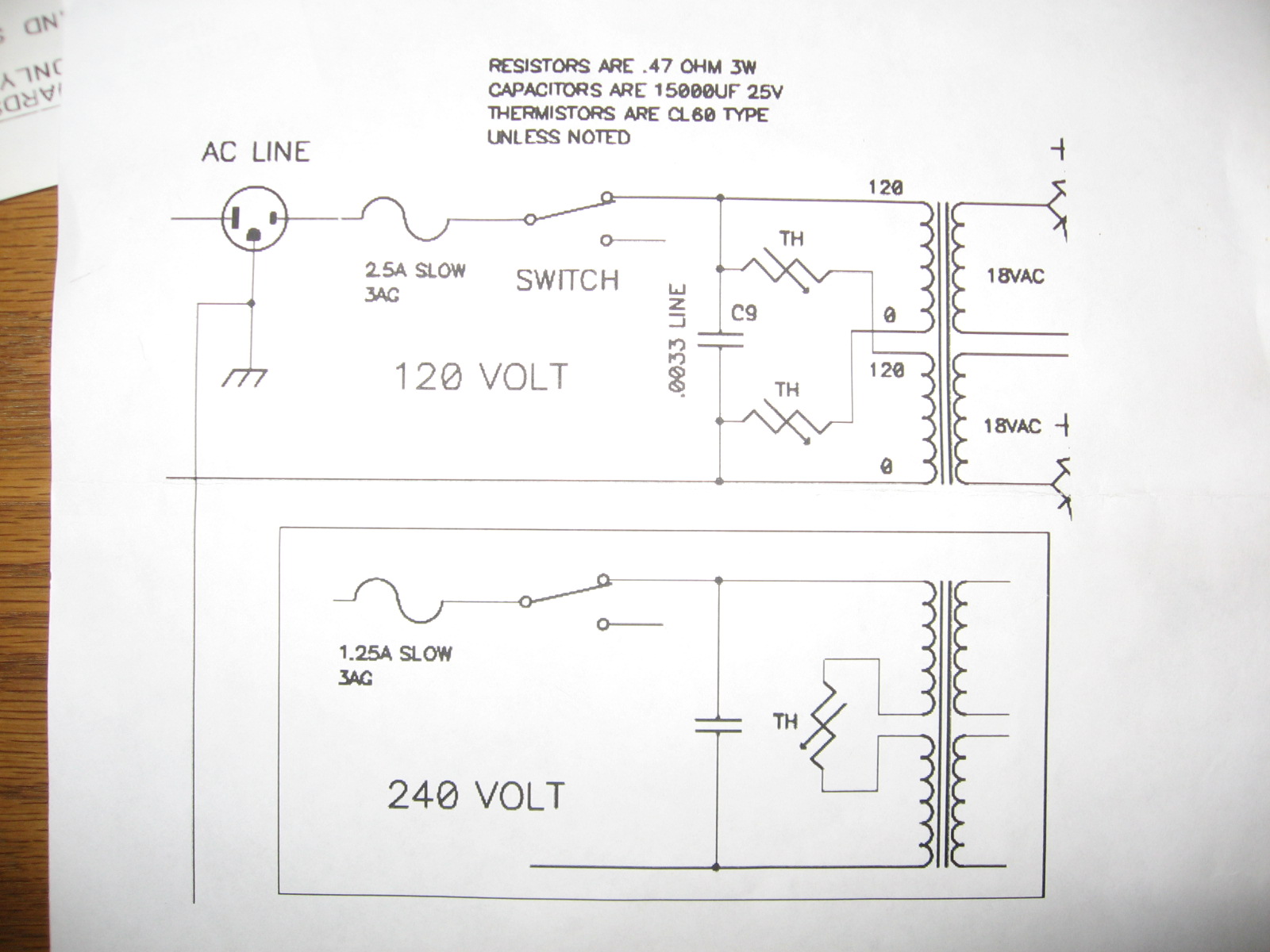

I used this schematic, I wish I could give credit to whom it belongs. (I think it was Papa's from the F3 power supply) I just copied it. You are correct, if you have a different soft start circuit, you do not need the Themistors (in the startup circuitry).

Additional question wrt thermistor and 240v transformer.
The PSU pic in the F5 doc that refers to 240v shows a dual 120v primary
(top part of pic)
If I only have a single 240v primary, is my alternate position correct (bottom part of pic) or am I going for a Darwin award?
tia for any life saving comments anyone would like to offer, else I guess I'll find out when I power the PSU part up tomorrow ;-)

This is how i have done it in my F2 clone. However i am concerned that 10 Ohms series resistance does not reduce the inrush current enough. With a 240v supply and 10 Ohms series resistance (ignoring the resistance of the primary winding for now) the inrush current is 24 Amps. i am using a 625VA toroid and when i checked the resistance across the primary winding including the series CL60 thermistor it measured 14 Ohms. Is there a better way to measure the series resistance of the primary winding?
I'd like to hear some experienced voices on this issue... is a single CL60 enough with a 240V supply?

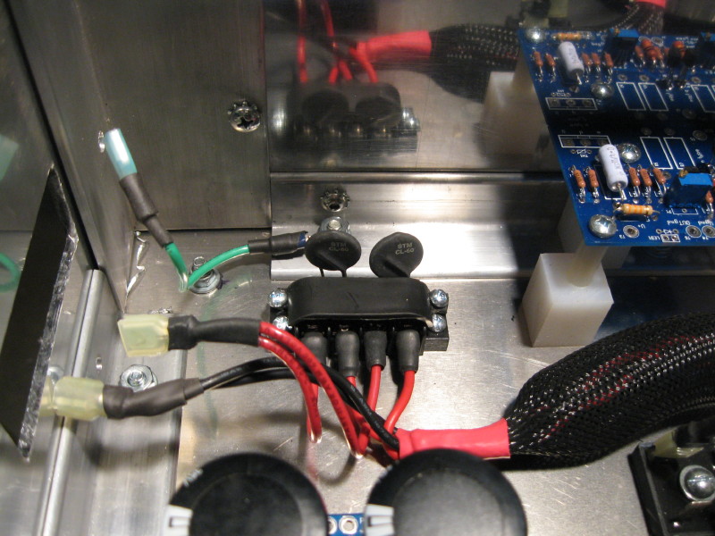

Here's another picture of the thermistors. I have both of them on the positive primaries. The very professional guard over the terminal block is part of a wrench display card from Sears. 😀

Sorry, my lack of clarity - there's no load attached :-( and the lightbulb is in series with the mains live (no variac so I wired up a The Dim-bulb Radio Tester).
Leaving it running for a while and I get a steady 25.4v ish each side of the supply (which I work out as right for 18v secondary * 1.414, and allowing for mains to wander about a bit)
