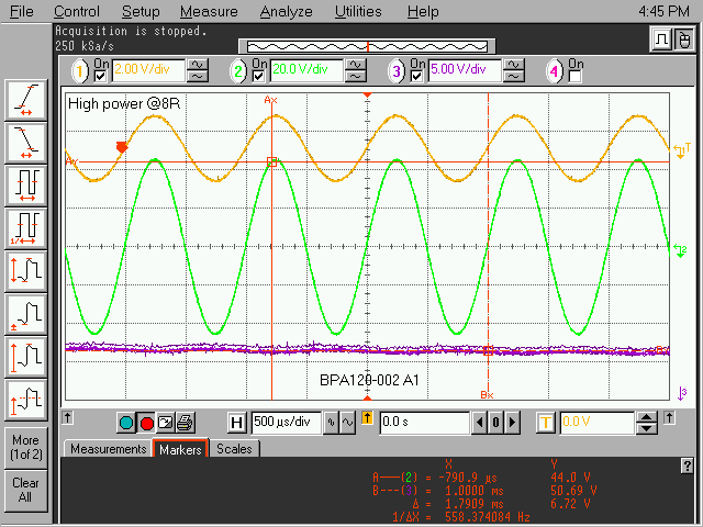

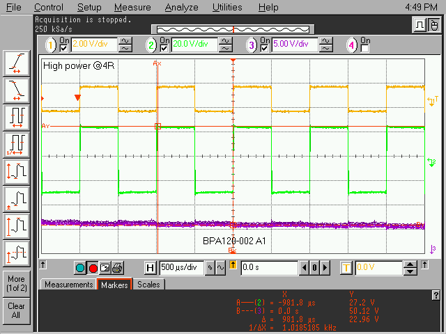

I don't have access to a distortion analyzer so with a HP 33120A Function Generator and an Agilent Infiniium scope, I took some measurements.
Some scope waveforms....
Yellow = Input signal
Green = Output signal across dummy load
Purple = PSU +ve rail
I must add that I haven't been able to fully characterize electrically the Vbias circuit based on the ThermalTrak diodes. It works but so far, I can't tell if it is doing a better job than a plain old VBE amplifier transistor.
I have access to a thermal chamber for testing electronic products but I'm not sure if heating up the entire module and measuring Vbias proves anything. It's the junction temp vs Vbias that really interests me.
Other than that, the module's was completed yesterday and it sounds very good. Can't say too much as it is hard to compare a mono module vs my stereo hifi setup. Work is going slow on the 2nd module...

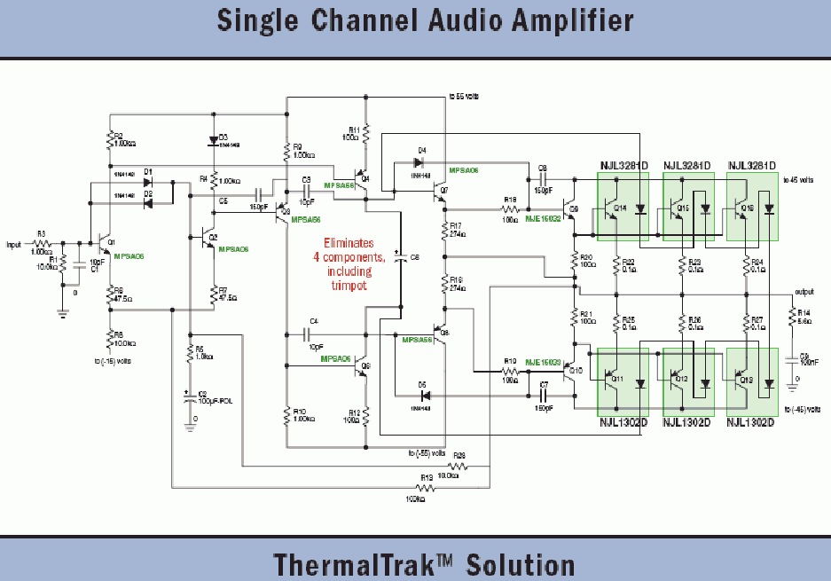

Noticed that the internal diodes for Q11,23 are not attached to the string. What might be the logic/reasoning for this?

acenovelty said:Noticed that the internal diodes for Q11,23 are not attached to the string. What might be the logic/reasoning for this?
Regards
It is probably because then the bias circuit would have gotten too high voltage = too much bias.
Each diode will add like 0.6-0.7 Volt.
The idle current bias in output is set by the voltage between Q5 BASE and Q25 BASE.
Depending how you design this bias circuit and type of output stage
you may only need to use 1-2 diodes in some cases.
(if you only have one output pair, you will only have 2 diodes)
Those two free diodes can be used for other thing.
For example a LED indicating a certain temperature,
either that amplifier has reached working temp at switch on
or a red warning LED for overheat.
Are these imbedded diodes different from the 1N4004's on the Leach LowTim amp? That amp and the Superamp use only 4 diodes. Prof. Leach mentions that 4 only made it convenient for them to come out on the same side of the heat sink.
Here Arius has used 3 diodes per side(6 total) and 4 transistors per side(8 total). Just trying to make sense of the logic or math involved.

Lineup is correct about me not using all 8 of the ThermalTrak diodes. Reasons:
1) 6 diodes is good enough to set Vbias accurately. Simulations confirmed this. It did not overcompensate (I think).
2) 6 diodes is what OnSemi had used in their appnote. So I could bypass the VBE transistor and just used the 6 diodes in a string to set Vbias - no adjustment.
3) I did not want to be forced to use 4 pairs of output devices all the time. 3 pairs is sufficient to deliver 300W into 2ohms. The 4th pair was added at my friend's (band player) insistence.
I regarded the embedded diodes as equivalent in function to the 1N4004's in the Leach amp.
The last two embedded diodes are unused. The 4th pair may be dropped (ThermalTrak's are cheap at OnSemi but pricey at Digikey).
There is onboard thermal cutoff and the status led will flash if that occurs. I thought of using one of the last diodes for temp sensing but I didn't want to deal with an opamp and its power supply hassle.

I found this OnSemi PDF Application:
Single Channel Audio Amplifier with 3 pairs of ThermalTrak
MJL3281A / MJL1302A driven by
MJE15032 / MJE15033 and predrives
MPSA06 / MPSA56
and a differential NPN input stage.
Power supply is separate +-55 Volt for Input/VAS and +-45 Volt for Power output stage.
This will naturally improve performance.
http://www.onsemi.com/pub/Collateral/BRD8043-D.PDF
