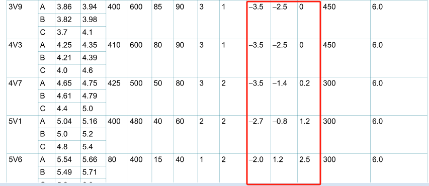

There seems to be a generally accepted notion that Zener diodes in the 5-6v range (highlighted in red) are the most thermally stable. I have read this on countless reputable websites and assumed it as fact for a long time. Where does this come from?
One possible source is NXP's datasheet for their BZX84 range. On this, the typical tempco changes sign between 5V1 and 5V6.
Vishay's data around 4.3V looks rather anomalous - the tempco jumps about a bit. Whereas on NXP the increase is smooth, above 3.9V. The red box highlights the min, typical and max tempco data in mV/K.

Ok thanks all it does indeed look like the Philips / NXP data is quite different.
It definitely pays to look at the datasheet, the difference between the two manufacturers is quite dramatic
I think this might be the answer, thank you...One possible source is NXP's datasheet for their BZX84 range. On this, the typical tempco changes sign between 5V1 and 5V6.
