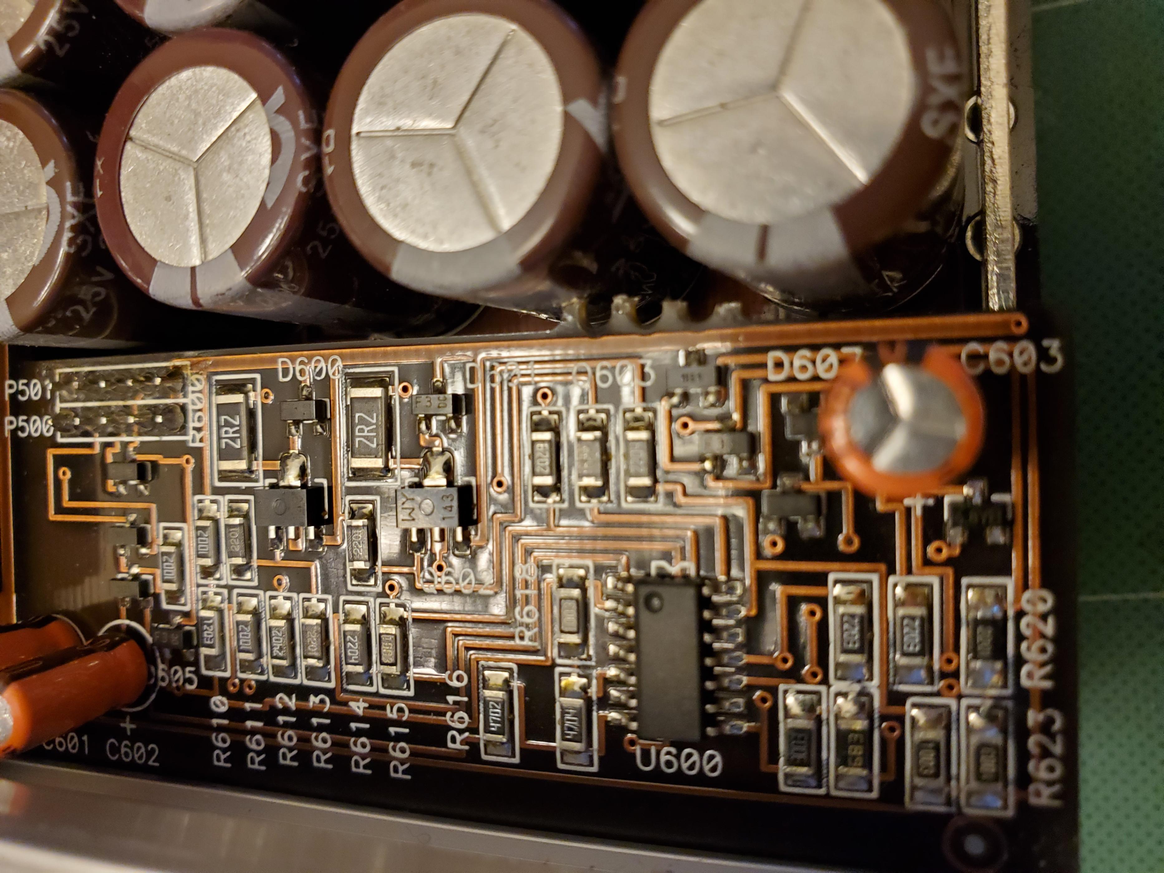

Hi Perry, I followed what you said and my results are the same. However, I managed to narrow the issue down to only one side of the board. It appears when I wiggle the side opposite the ground/battery + terminals there is no effect on the thermal light. When I wiggle the PCB both main and preamp section beside the ground/battery + terminals the thermal light goes on and off.
On a side note I noticed part of the PCB is touching one of the capacitors. I am not sure if this would pose a problem. See attached photo

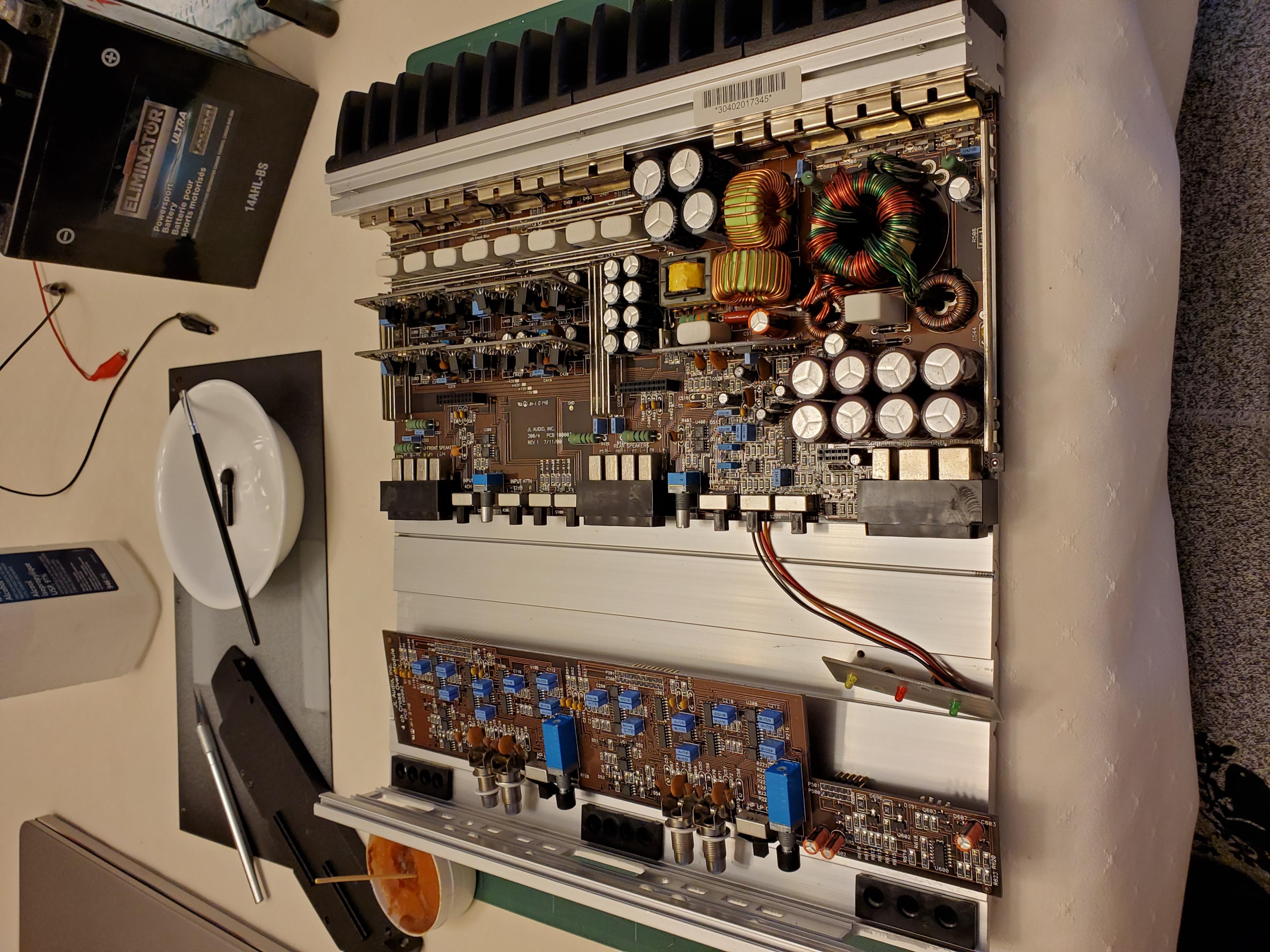

I did but left the FETs connected to the black fins part of the heatsink with their thermal paste. I separated the preamp board and there is nothing burnt on the backside of that.
