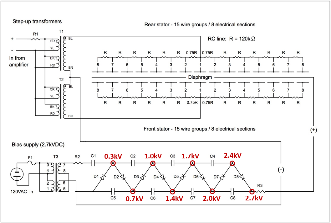

If you are using a typical multiplier section, you can change the voltage by just moving the charging resistor connection to a different point on the ladder. For example, if your multiplier section looks similar to CharlieM’s(attached pic), you can just move the connection of R13 to different nodes in the multiplier to step up or down in voltage.
As Wrinex mentioned, you need to have the connection from the HV supply thru the step-up transformer to the stators in place for the diaphragm to charge up properly.
