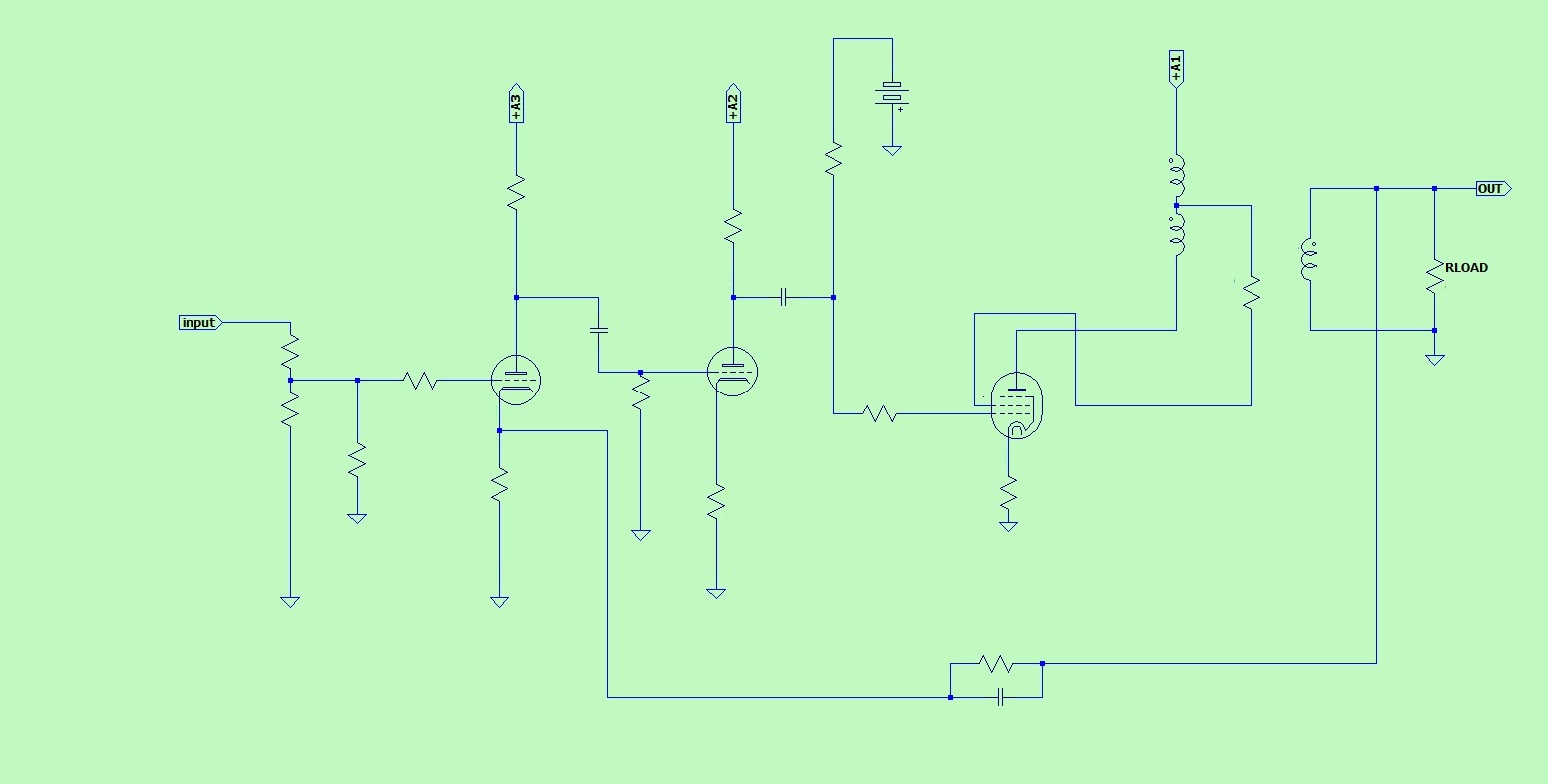

Hi, Please help me understand why people use SRPP, CCDA, cathode follower etc., while not using the attached configuration with two triodes in series and GNF.
This is also the one that when simulated gives me the lowest THD among all the previous ones that I have simulated, the one that has the most linear frequency response and also the highest input sensitivity.
(Let us use ECC83 only, pls)

You have lots of loop gain inside the FB loop, which explains the "good" properties, whilst a follower on its own has just the internal gain of the active device.
However, I suspect that your transformer has minimal parasitics in the sim. The reality would probably be less shiny, and stability issues could surface

This is the only reason I could see. Maybe that so large GNF (3 tubes + OT) gives too much phase rotations, thus risk of oscillation? But still searching, maybe old books. Strange nobody has never tested this, which appears the simplest and easiest....stability issues could surface
The circuit is not good for what we want from tubes , especially from a single ended ... Huge gain open loop and a lot of negative feedback . Big possibility of oscillation or instability . Not good for hi-fi or guitar amplifiers either .

You have three differentiating poles (2 caps and the transformer); avoiding motor-boating is probably possible, but it is not going to be easy

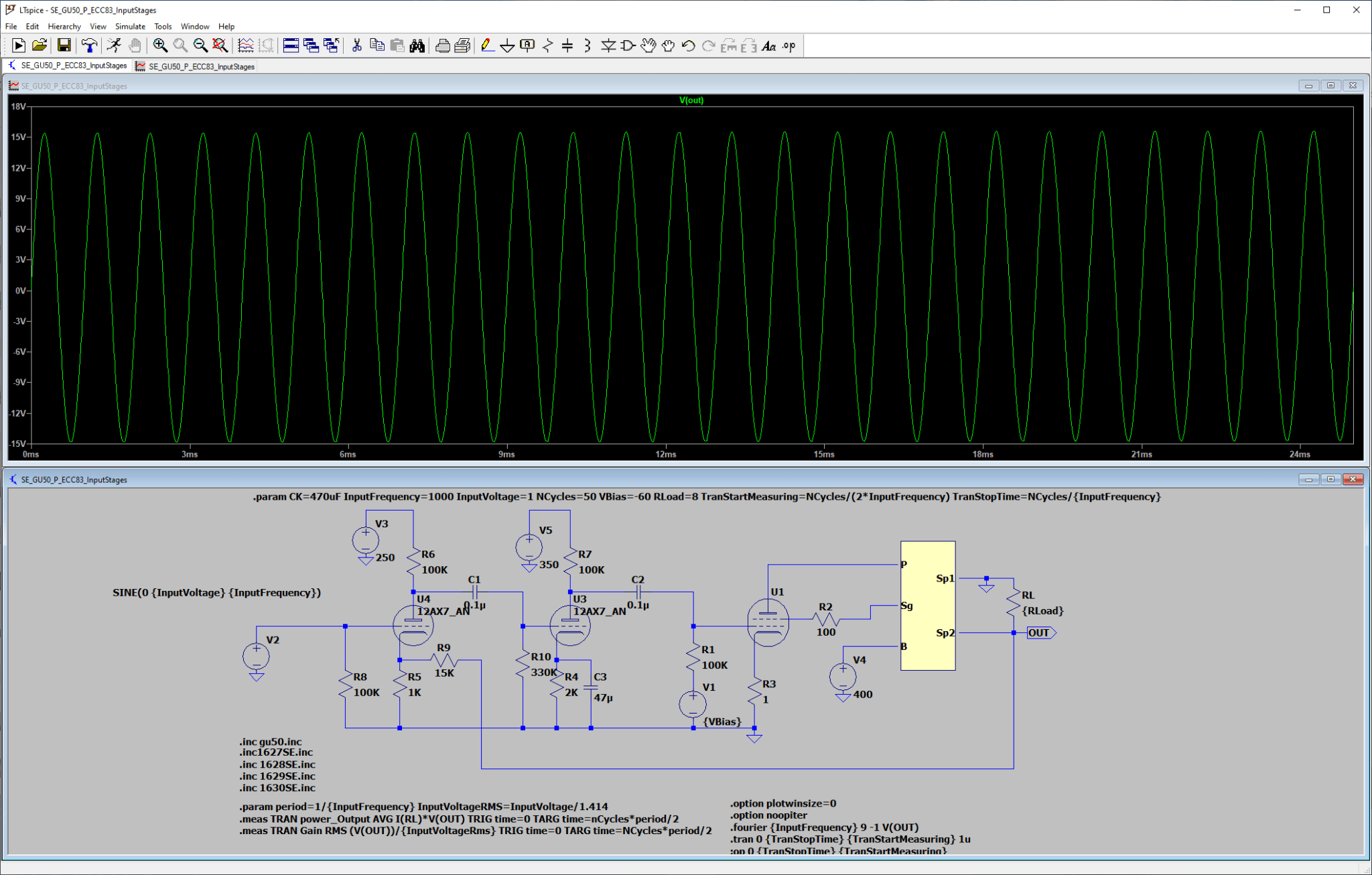

It even (sim-)works. Nothing optimised, just put together the usual resistor/voltage values for a 12AX7 🙂
I'd worry that without compensation it could oscillate at RF. The acid test is building it for real.Hi, Please help me understand why people use SRPP, CCDA, cathode follower etc., while not using the attached configuration with two triodes in series and GNF.

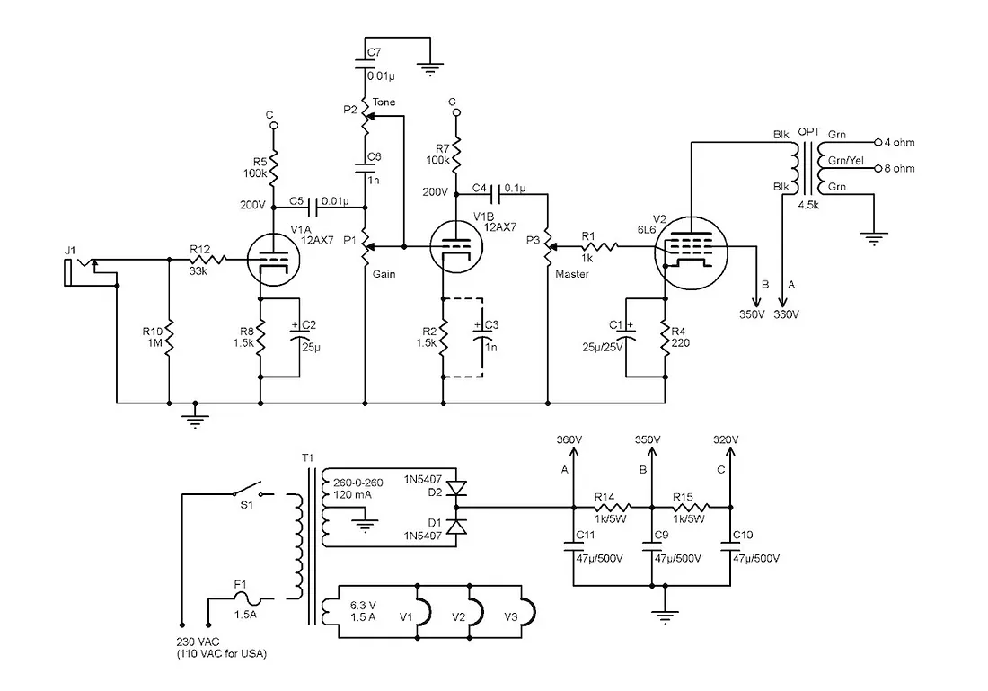

Here below I found a reference. Same scheme of ours simulated BUT WITHOUT feedback..... It is for a guitar, so it means non-hifi. And infact without GNF the sensitivity drops to 15mV at the expense of a huge THD.It even (sim-)works. Nothing optimised, just put together the usual resistor/voltage values for a 12AX7 🙂
https://miro.medium.com/v2/resize:fit:1100/format:webp/0*7O1yuvpRdPro_C4F.jpg
https://medium.com/audioxpress/you-can-diy-build-a-single-ended-guitar-tube-amplifier-40f23353dfb6

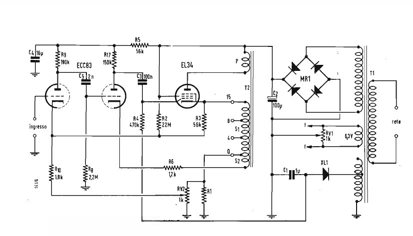

...and finally this is from 1958 : two ecc83 and one
It uses several loop of GNF and the OT is quite complicated (I cannot reporduce), but the overall concept should be directionally correct. The article says 0.3% THD at 9W!
It seems that you discovered America again 🙂 , secondary used in the cathode feedback loop has nothing to do with your setup .
The schematic in Post # 1 can very loosely be considered as a single ended Williamson push pull amplifier.
That is because it has global negative feedback, and . . .
3 low frequency poles:
Two RC couplings from plate to grid
One output transformer with primary inductance.
Get your low frequency poles adjusted, or expect motorboating.
And, watch out for high frequency oscillations too, there does not seem to be a dominant high frequency pole (other perhaps than the output transformer).
Build it with real output transformer and real wiring.
Simulations are often 100% correct, other times you have to do some adjusting of real circuits.
