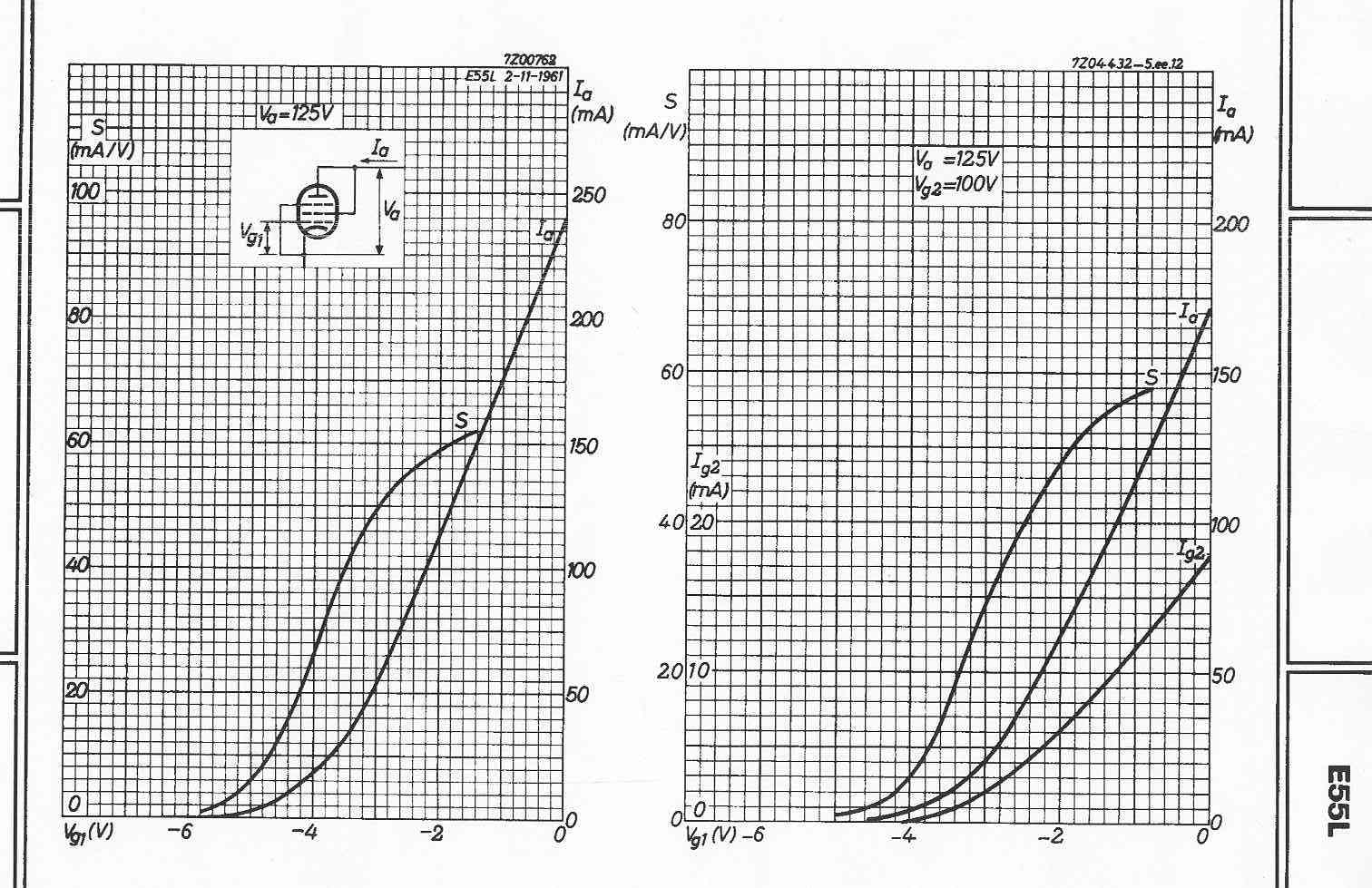

Seems that most attempts to use the WE Harmonic Balancer technique (P-P case considered here) only work for a limited range of signal amplitude. Which is not surprising if you look at the typical gm curve for tubes! S shaped. (1st pic)
At low amplitude the gm curve is curving upwards, indicating greater than square law V to I (gm being the 1st derivative of the V to I formula, so gm rule is 1 power less, so greater than 1.0 power here). At high signal level the gm curve is bending over, indicating less than square law V to I (so gm rule now less than 1.0 power here). So one WE HB fix will not work over the full range.
For class AB (P-P) the overlapped conduction region can be optimized so the expansive and compressive regions nearly compensate, until the class B region is reached, then compressive mode will dominate.
Class A will be dominated by varying amounts of compressive dist. The WE HB only tunes out one specific level of compressiveness. So falls short over the full signal region for power output. Useful for signal level stages though.
One does have another option for power fortunately (below, 2nd pic and 3rd pic, constant gm Twin/Crazy drive, 3rd pic is input V to I output):

The WE HB works for correcting compressive distortion (at least as normally used).
The square law portion of a tube gm curve would be expansive in SE. (it can sum to constant gm in overlapped class A P-P, but usually still becomes compressive at the peaks due to the gm rollover dominating.)
So the WE HB is useful for class A P-P mainly.

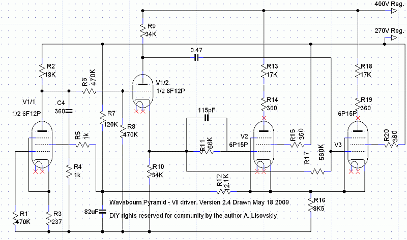

Well; you should ask SY, we observed one of my PP prototypes on his computer screen and saw -80 dB of 2'Nd order harmonic on power 40W (half a power). The rest was under the noise floor. Did I call it by some fancy merketing names like "WE compensation" or used other famous and well advertised name? No, I just called it an optimal engineering. Here is the driver schematic attached. It does not show output tubes and feedback resistors across them; and it does not show the global feedback loop from the secondary. Neither it shows MOSFET regulated power supplies.
Just one frame grid penthode stage, then Concertina that drives a LTP driver, and class AB output stage with local parallel resistive feedback by voltage from anodes. That's why quite power pentodes in LTP driver, to supply linear current swing to low input resistance of output stage.

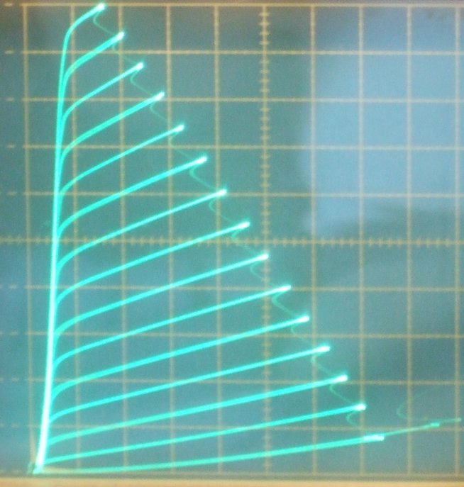

These kind of harmonic cancellation schemes usually work just for some low order harmonics (like 3rd, maybe 5th, for the WE HE), but likely mess up the higher ones. The compensation is never going to be exactly the inverse of the distorting function.
But if the higher order harmonics are already tailing off to begin with, then there are only low order ones left to fix. Just takes one tail resistor to see if its going to help or not. If one can minimize say the 5th H or 7th H by tuning the resistance, it could be useful.
To get more odd harmonics to converge/cancel over a wider range, one would likely need a non-linear tail resistance. Maybe a resistor and thermionic diode in series. One will need an army of Pixies to adjust each amplifier then. There is the 6JU8 with 4 6AL5 type diodes in the bottle. A jumper could select how many of them are used in series. And a variable CCS coming down from B+ could select the operating point (curvature) of the diodes. Probably will need to be re-tuned up every few months. If we had something like an analog EPROM (resistance function), computer tuned up at the factory.....
