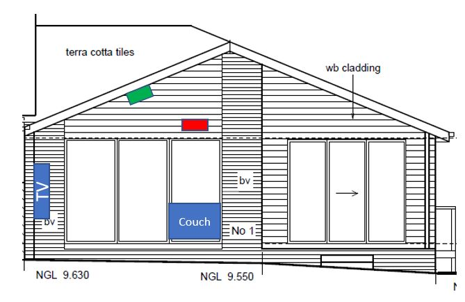

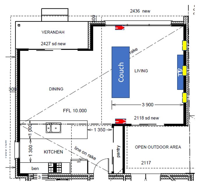

I'm looking for thoughts around speaker placement for the surrounds (plans and elevations attached)
Constraints
- TV will be wall mounted as per floor plan
- LCR Speakers are in-wall...likely Polk 255c-rt for center and 265RT for LR.
- Theater area is 5m wide x 4m deep (to back of couch).
- Roof is pitched internally i.e. cathedral (see elevations)
Surround placement
2 options come to mind for placement
  • placed on walls either side of the couch (with left above window). Marked red on plans
  • placed on the pitch (Marked Green on Plans)
What are the pros and cons of each placement?
Are there other options I should consider?
Potentially i could do both positions for 7.1 if there's improvement. In this case would it be worth the effort?
