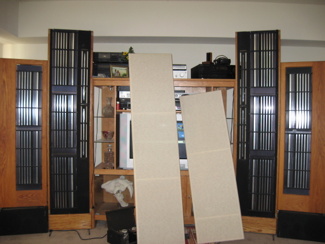

Apogee used a foil only 2 inch wide BUT its crossd over at about 3 Khz or lower to a 1/2 inch wide FO so it avoids the issue
you can still use the multi trace plastic and short all the traces together at the ends to get your low ohm
yes the 2 inch is better to go low but a 1 in will work too. The 1 inch requires you to get the gaps a little smaller and is therefore a bit harder to construct.
the last pr I built were 2 inch wide and only 30 inches long. They were in baffles 34 inches wide by about 38 inches tall. They played well down to 100 hz crossed to sub. But not to levels of a full floor to ceiling line
