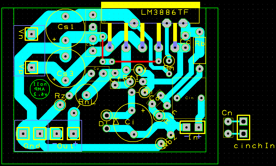

i'll suggest you to plan a new board with SMD resistors and caps if possible, it will make it further compact...
on the other hand i myself once was carried away with the idea of compact PCBs for both LM3886 and LM4780 and i designed them also, but later i had problems in soldering the parts and any replacement is further too difficult. DIY Audio Amplifier Blog: Evolution of PCB for LM4780 based amplifier.
DIY Audio Amplifier Blog: Lm4780 Single Sided PCB v3
So what i learned from that compact layout is no much useful if components are too close. In diy pcbs, the soldering becomes very difficult, soldering flux leakage is there & induce stray inductance on PCB which may deterioration of signal quality. Troubleshooting is more difficult.
So now i started planning little spacious layouts but maintaining shorter track paths.

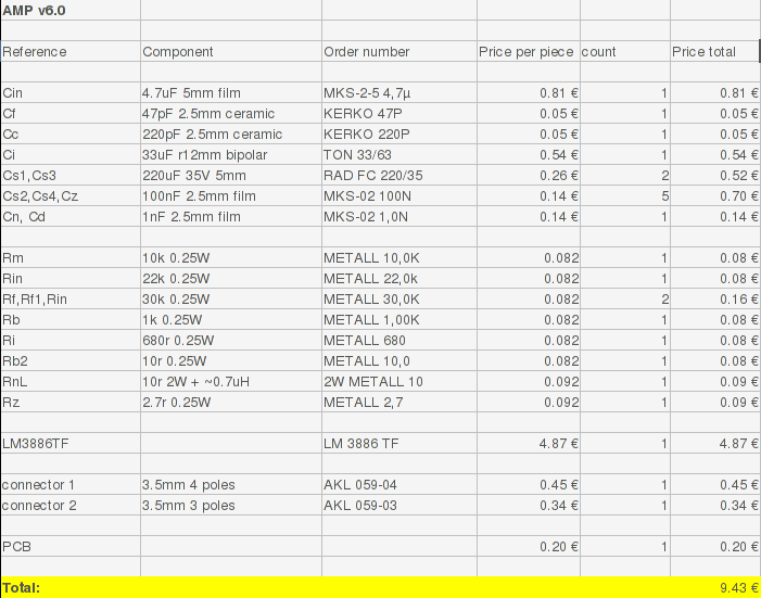

So 9 month later the Amp is still playing fine and its time for some more fine-tuning.
First, the gain has to be adjusted, it is a bit too low. From 33 now to 44.
That is, rf and rf1 will be raised from 22k to 30k.
Cn and Cd will be reduced from 100nF to 1nF for rf filtering. 100nF was way too much (as you can see in the rmaa test charts).
A few parts got shifted around, the LM3886 was moved a little higher.
So this is v6.0
And the updatet parts list.
cheers!

I would not fit Cn to the PCB. I would fit it across the signal input socket, hot to return. Maybe a value of 47pF instead of 1nF.
I would also experiment with Cd. Try a range from 330pF to 1n5F.
I am not sure you need Cc and Cd and Cn, That is three low pass filters on the input.
If keeping all three is best then again I recommend reducing Cc. At the moment there must be quite a cut in the high treble, with all three at the values you have used.
Why did you choose 680r (Ri) and 33uF (Ci) for the NFB bass roll off?
(edit: I have just read post101, surely not because 33uF is physically small)
I like the layout and the way you have included so many options.
It appears you are using only one common wire for all ground connections back to the power supply, if so, doing it this way will definitly increase THD and noise. And using an "isolation resistor" between the signal and power grounds doesn't really solve the problem, it just sweeps it under the rug. I strongly advise using separate ground connections for for the signal and power at minimum. I have the signal, power, and speaker grounds all individually connected to the power supply common ground on everything I design and build. It's the best way to do it, and even better, it's cheap and easy.
Miike
Miike
No.It appears you are using only one common wire for all ground connections back to the power supply,..........
I see the Power Ground coming from the two stages of decoupling coming back to the PSU Zero Volts. I also see the Zobel Return coming back to the PSU Zero Volts.
I see the PSU Zero Volts sending a single trace connection to the Signal Ground on the PCB.
The Signal Ground has connected to it:
1.) the voltage reference for amplifier Main Audio Ground
2.) the NFB lower leg
3.) the resistor defining Rin
4.) the capacitor defining the on board RF filter attenuation
5.) the indirect connections to both -IN and to +IN
6.) the connection for Signal Return to complete the input circuit.
What I see cannot be described by your phrase

Once agian, ALL of the low current and high current ground paths are routed to a single point (lower left corner on the PCB lay-out), and then A SINGLE WIRE is used to connect all of them back to the power supply common ground (0-volt if you prefer.) It would be better to run the low current and high current ground conections from the amp board to the power supply through thier own individual conductors. I always use at least three separate ground paths for my designs, one for the input and feedback (low current) paths, one for the local power supply de-coupling, and one for the speaker/output zobel path.
Mike
Mike
Check!
Cn on the RCA and Cc right on the input pins seem to be a good idea. Concerning Cd I think I just have to do some tests to see how it will perform with and without.
With a look at post #184 removal of both Cn and Cd led to a considerable amount of increase in noise.
Sadly I only have a creative soundblaster x-fi usb sound card at hand which will most probably limit my ability to test any change in THD and Noise.
Hmm well yes I did, the next bigger bipolar capacitor has a 14mm (+2mm) diameter so it doesn't fit.
However I don't quite get the idea behind the size of the capacitor. Ri and Rf + Rf1 set the gain and the combination of Ri and Ci set the aforementioned NFB roll off.
But since this is the negative feedback that ties into the negative input, 33uF should be plenty for the low level(?)
(As enzoR mentioned quite some time ago it is possible to use two monopolar caps connected at the negative leads to make one bipolar... there actually is room for a bigger Ci)
@Mike
Please take a look at post #159, the PSU doesn't have a common 0V point, so the "master" 0V is on the AMP board, no point in shifting it to the PSU.

AMP v6.1
Don't use a bi-polar.
A polar electrolytic is adequate. It is cheaper. It allows more capacity for the same size.
If you want to add protection to the electrolytic then add a diode across the cap or two diodes in inverse parallel. This protects the cap if the amp output ever fails to either supply rail.
Aim for at least half an octave below the passive high pass input filter.
Ok, here is what I got: (please excuse if my posts are overly detailed)
Passive highpass input Filter: Rin + Cin
So half an octave would be a perfect fourth with a ratio of 3:4. which would be 1.16Hz or lower.
I'm not quite sure why Ri would be the corresponding resistor since it is connected in series with Ci. But Rf or Rin results in a C of ~5uF which doesn't fit to the claim that 33uF is not enough.
Since I'm already using 220uF capacitors for the input pins, one of them will be used here as well.
As an additonal thought I'm thinking about a multichannel-Amp i.e. 5 or 7 channels.
The setup would be the same as with stereo, one PSU for two AMPs. All connected to one large toroid. Any thoughts?
Cheers!
