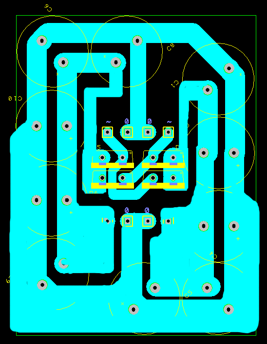

And here is the PSU, I used five 35V 4700uF caps since I've got a lot of them lying around, diodes are MUR860, Transformer will be 18V, 80VA.
This should result in +-25.5V, (8 Ohm) 30W output; 15W dissipation.
I see many people are using small around 100nF caps in parallel, what are they for?
Again, any input is welcome 🙂

Neat. I'd look at all those ground tracks though, a star is a much better solution.
+1 (here you probably want to turn the whole layout inside out, and keep the INs and OUTs on opposite sides)
dont forget 2x Cs! they really need to be close to the chip! the value and part quality is esp important for the power amp stability and the sound. Sorry but this blows up yer small PCB...deadbug style is looking good.
The power supply layout is just wrong....
Imagine the 50/60 Hz current pulses going from the diodes to the capacitors.
Now consider that the PCB tracks have some resistance, and see where you are taking the output from. Never share a track/wire that carries current pulses...
since your amplifier board doesn't show any decoupling capacitors, you may get into trouble. Not necessarily, but maybe!

@discrete I calculated for a maximum of 4.44A (thats as much as the transformer can handle) at 35um copper thickness and 200mm track length a width of 2.348mm so it should be fine, or am I missing something? (I actually used 2mm until now, so new design is mostly 5mm which should be more than enough)
So here is revision 1.1 of the PSU and the board. as Cs I used caps of the same size as on the PSU board.
...more like this (please excuse the freehand doodle).
Think of it as an RCRC filter, where the tracks are really small Rs.
A star for the ground would be another improvement.
You have omitted the decoupling specified by National for the chipamp.
Or do you intend soldering direct to the power pins and the ground pin?

No not really, The purpose of the decoupling capacitors is to shunt any residual ac noise on the DC power supply rails off to earth. By putting them as close to the chip as possible it will maximise their effectiveness.
from page 19 of the datasheet.
It is advisable to keep the output compensation
components and the 0.1 μF supply decoupling capacitors as
close as possible to the LM3886 to reduce the effects of PCB
trace resistance and inductance.
Note that the 0.1uF caps deal with high frequencies, the larger (assuming you have them) decoupling caps should also be close to the chip.

Chip amp power supply decoupling needs 2 caps per side.

@discrete, (thanks for your reply) I see now what you mean, but why would I want my PSU to behave like this? A quick number juggling tells me that this RC-filter gives me a cutoff around 7Hz... (23500uF, 1 Ohm <- wild guess). Also I want to avoid a ground-star to avoid jumpers... may seem silly but I like it to be as simple as possible.
Thanks for the program link, this is quite awesome!
I also looked through the data-sheet again, the tip concerning the decoupling was very helpful. as per NS the small one should be about 0.1uF, and the large one above 10uF. In my design I chose 22uF for the large one.
I saw many designs which use around 1000uF for this, is there any significant change in sound going from the advised 10uF to 100 times the value?
So you're set on having it smaller even though it might significantly degrade performance? Seems a shame to me.

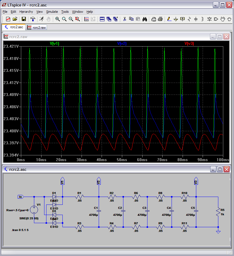

In the simulation below, do you want to feed your amplifier with V1, V2 or V3?
Using V1 is a good way to have mains hum on your speakers.
The PSRR of the amp chip may (or may not) bring this down to inaudible levels, but why not do it the correct way?
Using a star ground is left as an exercise for the reader 🙂.
