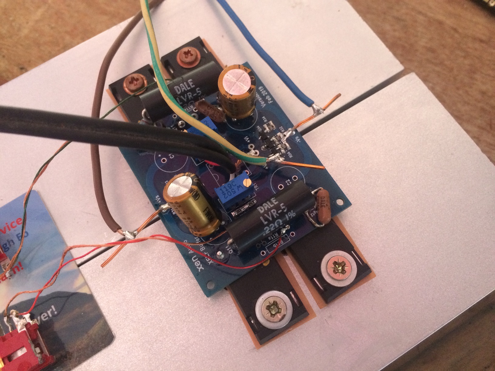

I downloaded the spice and tried replacing the opamp with an OPA1652, is it normal for the THD to rise a ton? Bias is at 200mA (R9 at 1.7k).

It's just the OPA1652 PSpice model I found on the TI website. I also replaced the Toshiba small signal BJTs with BC847B/857B but that had no effect really (which is good). Wonder what's going on...
XELF build went smoothly .
It sounds as great as you might expect, very smooth yet very musical and hugely resolving (captures 'weight' of the sound very accurately), not much more you could ask for.
About 200mA bias with ±8V supply.

At 200mA, the laterals like to have 5~10V headroom.
So 12V was what I used.
8V is a bit on the low side, but probably also OK for headphones.
You need to do AB test to see what suits you more.

For initial testing and listening a D10S DAC was used, switching after a few days to TDA1387 DAC with passive resistor I/V that suits the XELF a lot more .
This combo sounds just fantastic, though more interesting was how plainly obvious the flaws of the D10S become with the extreme resolution of the XELF.
I am using the super regulators for 8V supplies but plan to switch to UltraBibs, there will be even less technical reason for using the super caps with bibs, I can't really be bothered testing them, it would only be a test since there are other, better places I want to use them.
Naturally you would raise up the voltage from 8V but there is always complications, I need to change to a higher voltage but smaller and lower quality trafo from the current one, because of this it might be difficult to make a fair judgement on only how rail voltage is effecting the amp.
It can probably be pushed to 9-10V with current trafo and my input levels are usually very low so i'll prob just leave it.
According to the LTSpice sim increasing rail voltage causes THD to increase at higher frequencies.
If this is a real and understood indication of something happening at higher voltages (e.g higher capacitance) having any small additional reason to stick with a lower rail voltage would be nice.

I just had a quick run in Spice.
Bias is set to 200mA.
Load is 32R, 1Vrms at 1kHz.
THD with 12V rils is 0.0016%; with 8V 0.0022%.
Difference is insignificant.

Took a while but I've been experimenting with XELF as ZFB speaker buffer.
Initially it sounded poor (rough treble and lean bass) and better with the op amp (ne5532) to 'smooth' things out and improve bass, this was with 15V rails and 700mA bias, increasing rail voltage or bias did very little/nothing to help with these issues. Luckily it was a simple problem of not having enough supply capacitance.
Replacing some smaller parallel lytics with 2 x 33mF per rail helped immensely, I think Nelson said somewhere that you can never have too much supply capacitance so there may be further improvements to be had, .
In this state it sounds really good, better without the op amp, I think it's best speaker amp I've heard.

Well, for use with speakers, it is just a source follower using the lateral MOSFETs.
You will find some improvements using the Exicon double-die devices, and with a higher bias (say 1A).
No need to mention, power supply to suit.
If you want to drive this without any opamps in the signal path, you should go for a R2R DAC like the Miro AD1862.
And then use a high-gain / high-voltage discrete IV converter for the output.
You are then not restricted to 2Vrms out.
At least that is what I would do.
