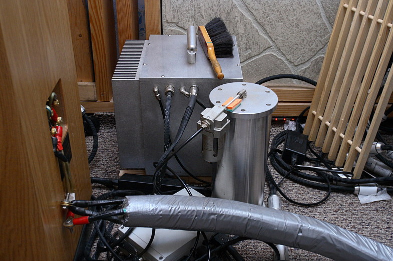

Crazy 100 kg amp
There is one crazy tube amp built in Russia, it weight 150 kg and outputs only 6W RMS. Designer of this monster is shizo-tweako who (as usual 😀), claims to be the only single man on earth who discovered how properly construct tube gears.😱
His last model "Maestro Grosso" has only 1.1% efficiency, and new one (in development) only 0.3%.
if the last go into mass production, Russia as the biggest oil/gas exporter may be forgotten once and forever😡
