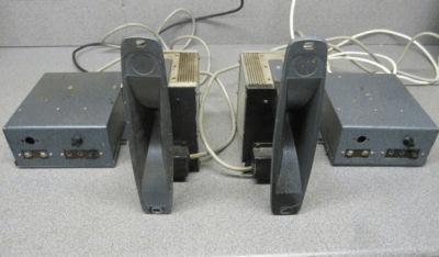

plasma tweeter
Ah! There's nothing quite like the pungent smell of ozone to keep you awake during late night listening sessions!
I remember the Ionofane, used by the British Broadcasting Company (BBC) in their monitoring loudspeakers back in the 1960s.
The air is coupled to an effectively massless plasma and not to a relatively massive dome or ribbon, making for unparalleled transient response.
The Ionofane is arguably the best tweeter ever produced.

I've seen one of these before...Ah! There's nothing quite like the pungent smell of ozone to keep you awake during late night listening sessions!
There you go Pedroga, I've started the ball rolling on your incredibly wide-ranging question. Let's see who else will join in!

Where was this connected?

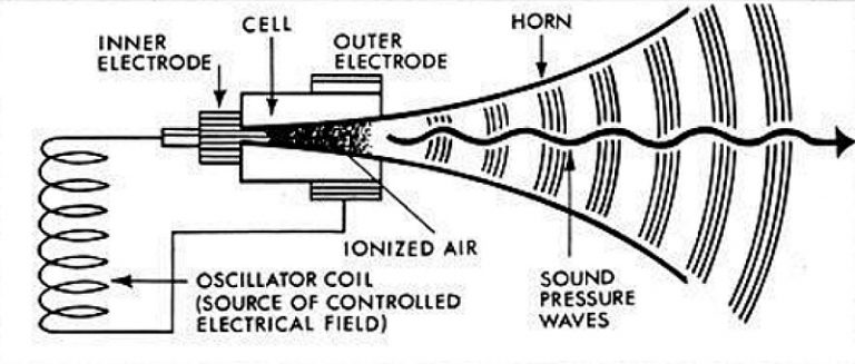

The Ionofane would have been connected to an amplifier via a high pass filter, just like any other tweeter.
A very high frequency (400 kHz) electrical discharge was used to ionise the air at the throat of the horn.

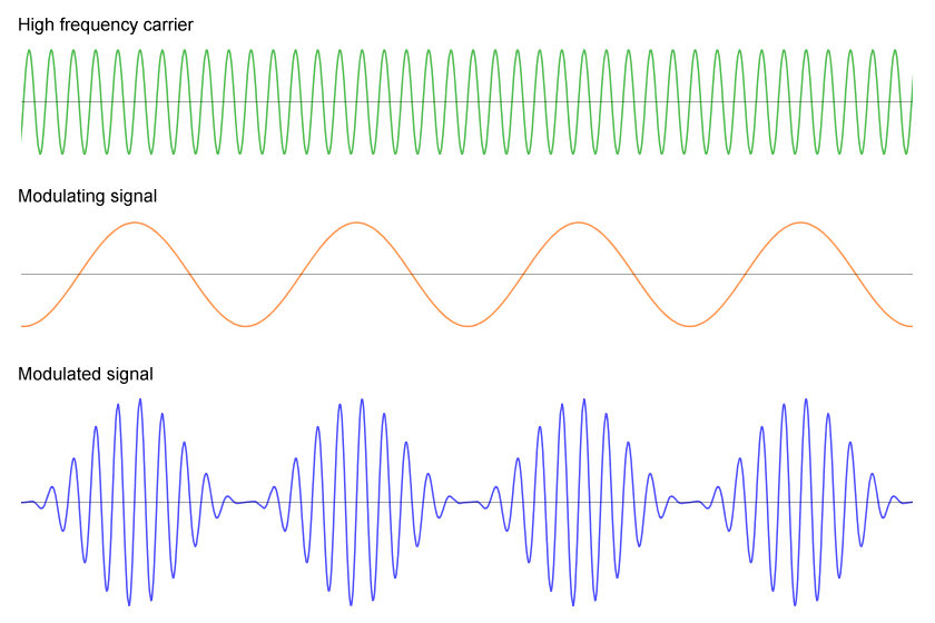

The signal from the amplifier modulated the electrical discharge at audio frequencies in order to produce sound.
It's similar to how an audio signal is used to modulate the high frequency electrical carrier wave in an AM radio transmitter.
