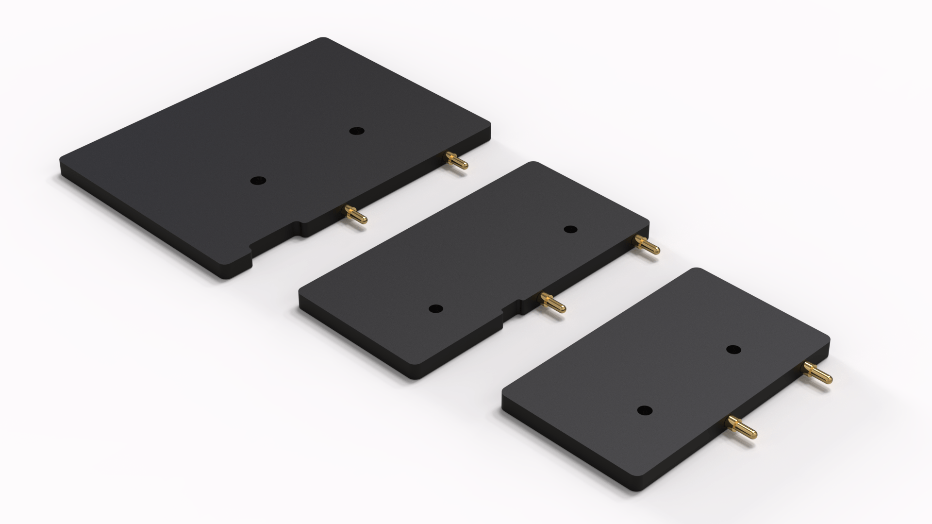

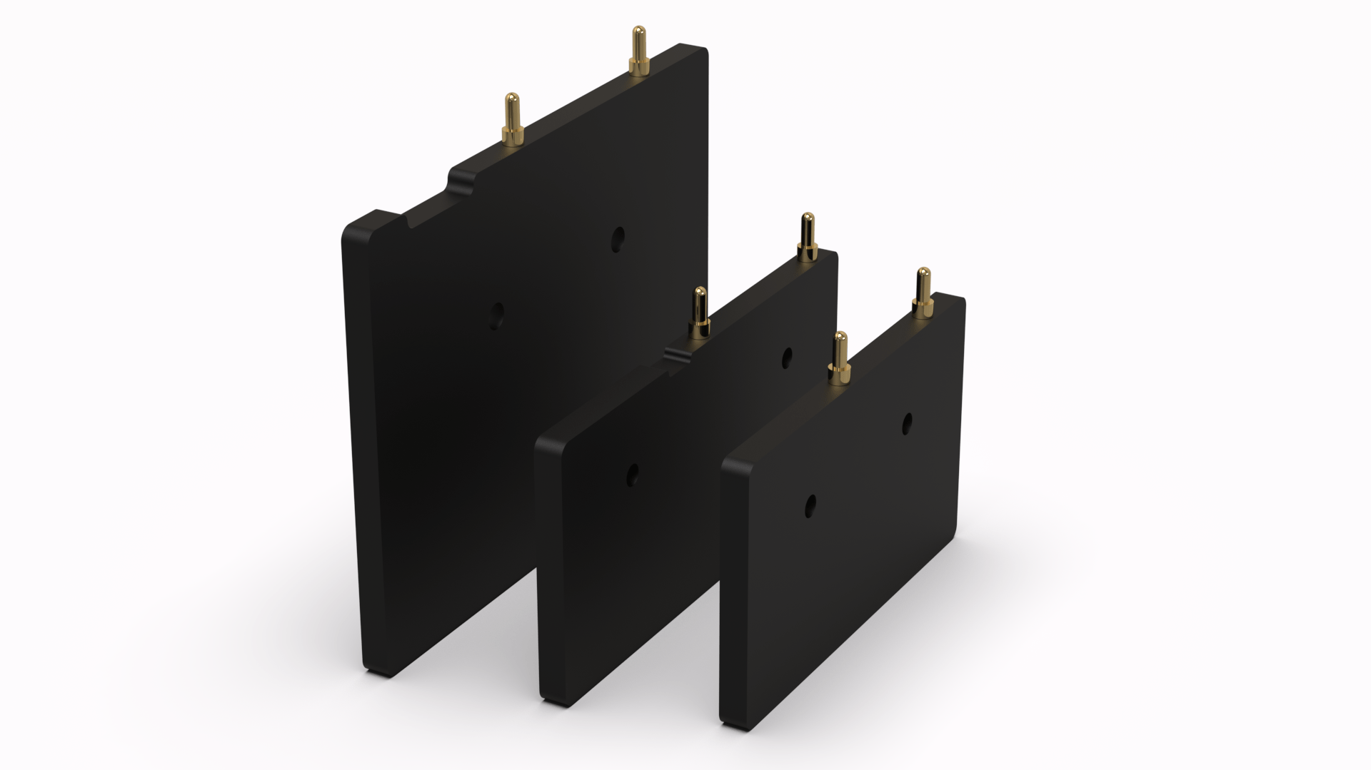

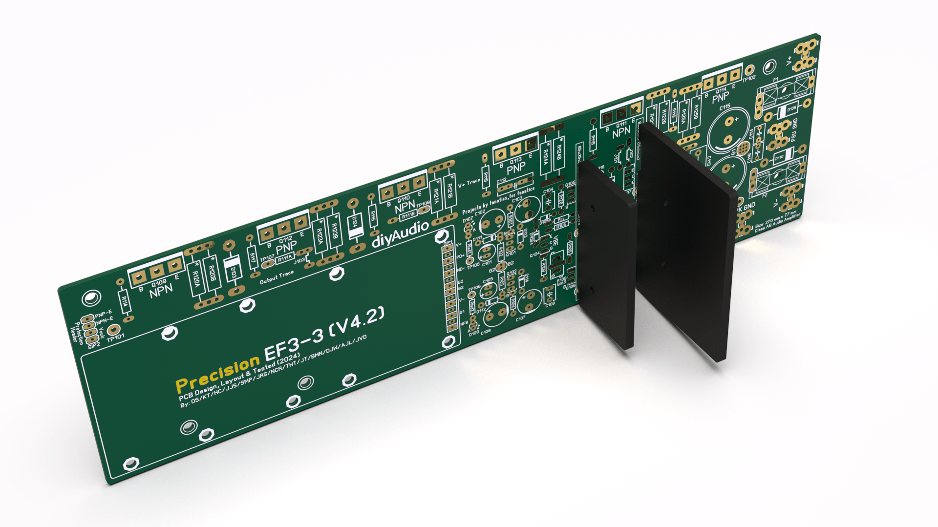

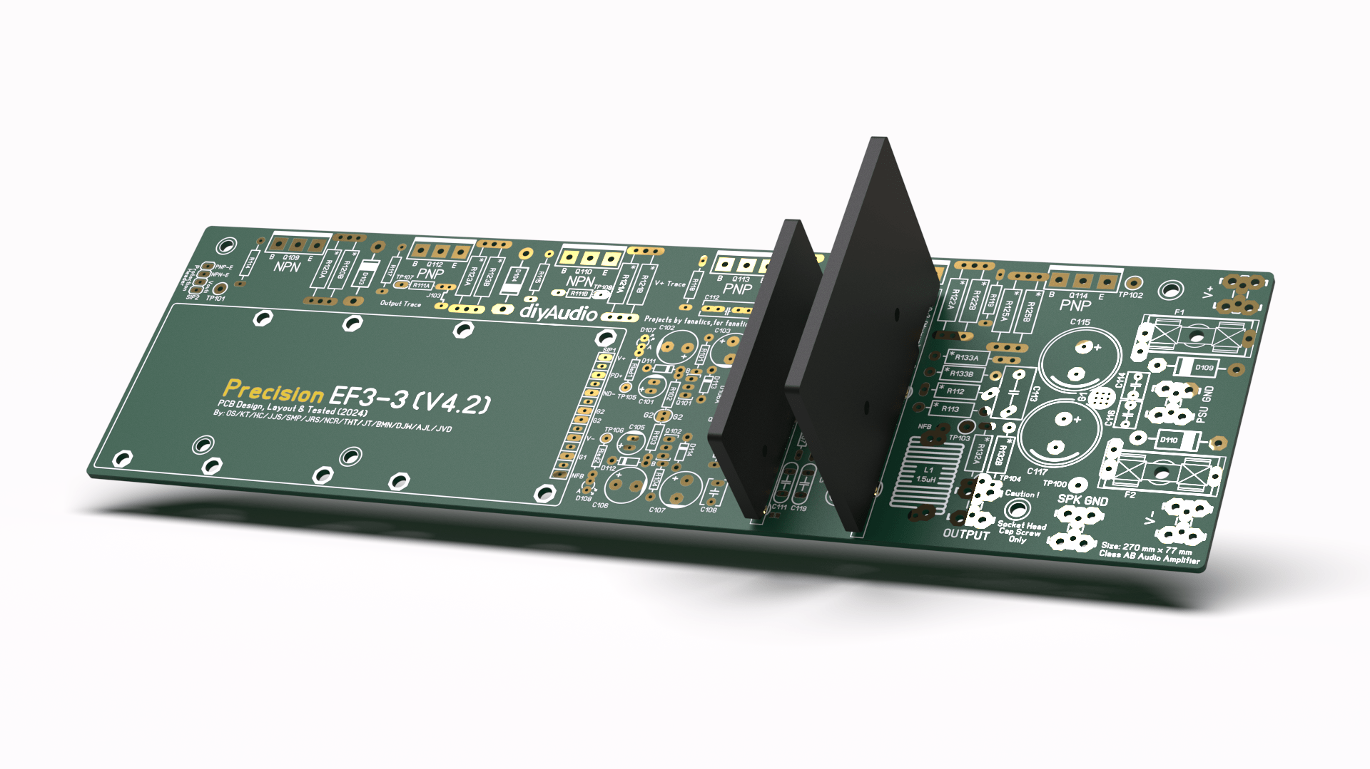

Just an update for anyone looking for the new heatsinks, they will be available at the same time as the PCBs. PM if interested! Thanks
Heatsinks are Matte Black anodized, tapped, and pins installed.
EF3-3 - Includes Driver, Predriver, and CCS/VAS Heatsinks - $55 USD
EF3-4 - Includes Predriver and CCS/VAS Heatsinks - $40 USD

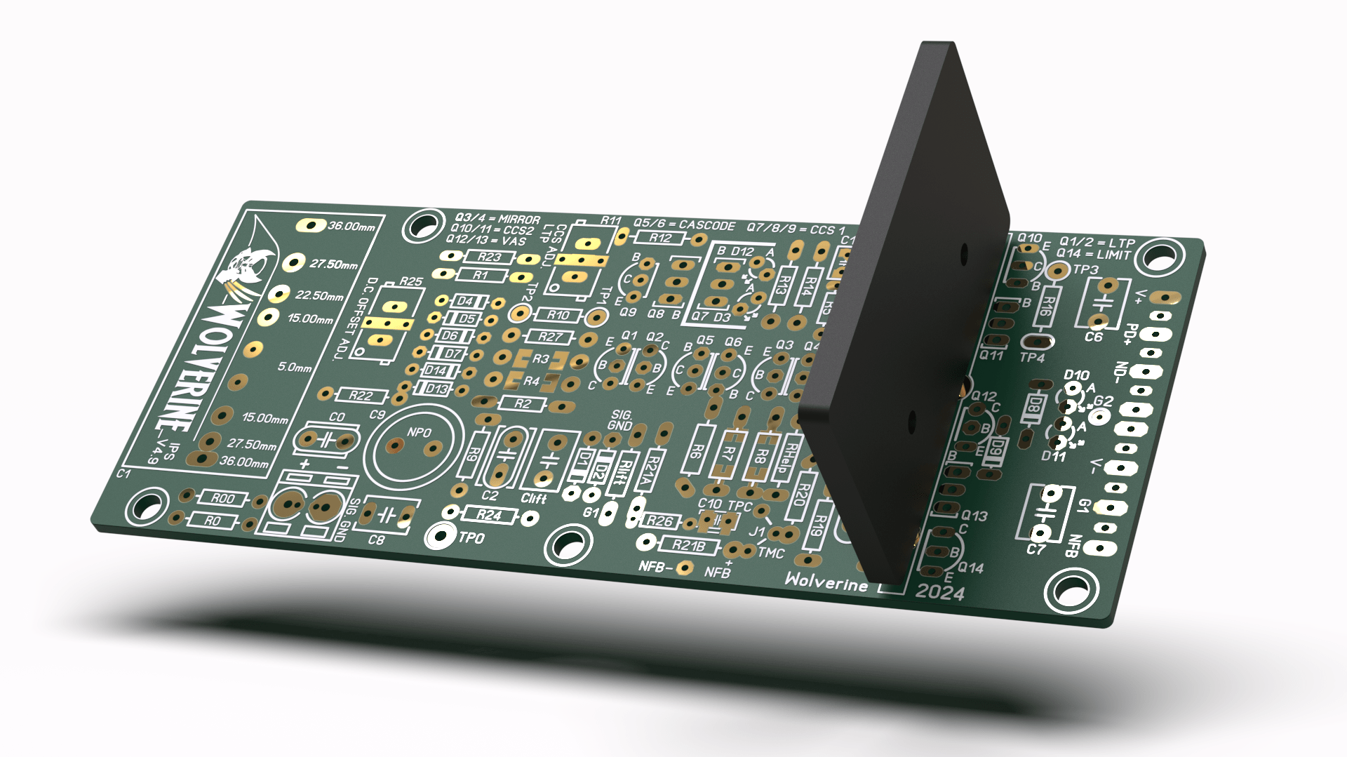

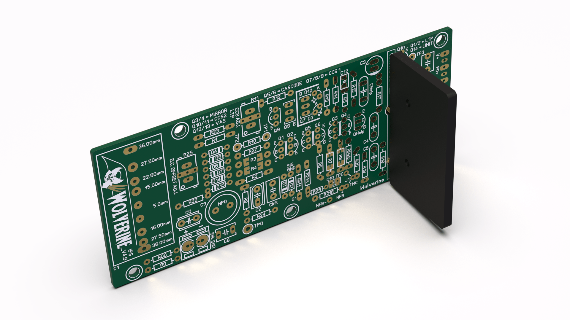

Typically unless you mount the pcb perpendicular to the heatsink the driver heatsink is not required as the driver will mount to the main heatsink.
Stuart, not sure if you saw this - what are your thoughts on using the EF3-3 bias resistors for an EF3-4 perpendicular setup? see; post 3510 wolverine build thread
The EF3-3 Driver heatsink will work on the EF3-4 if needed, but its highly recommended to mount them on the main heatsinksToo late to order another set of 4 pair boards with heat sinks?
No driver heat sinks for four pair boards?
If you need to perpendicular mount the pcb to the heatsink and your using the 3mm heatsink for the drivers then yes. Please use the EF3-3 values for the bias resistors. I'll check the build guide on this point and update it if necessary.for an EF3-4 perpendicular setup?
Hello everybody,
Really happy to see the group buy is going so well! This is just to let you know that the heatsinks of any of our 400mm deep (3U/4U/5U) Dissipante or Mini Dissipante chassis heatsinks can be customized to accomodate the Wolverine boards. It's a simple as adding this product to your cart and selecting the output in the dropdown menu https://modushop.biz/site/index.php?route=product/product&product_id=811
It only takes us a couple of days after you place your order to ship everything as each heatsink is drilled pretty quickly. In the next hours each member who partecipated in the group buy will receive a special coupon code from Stuart to get an extra discount
