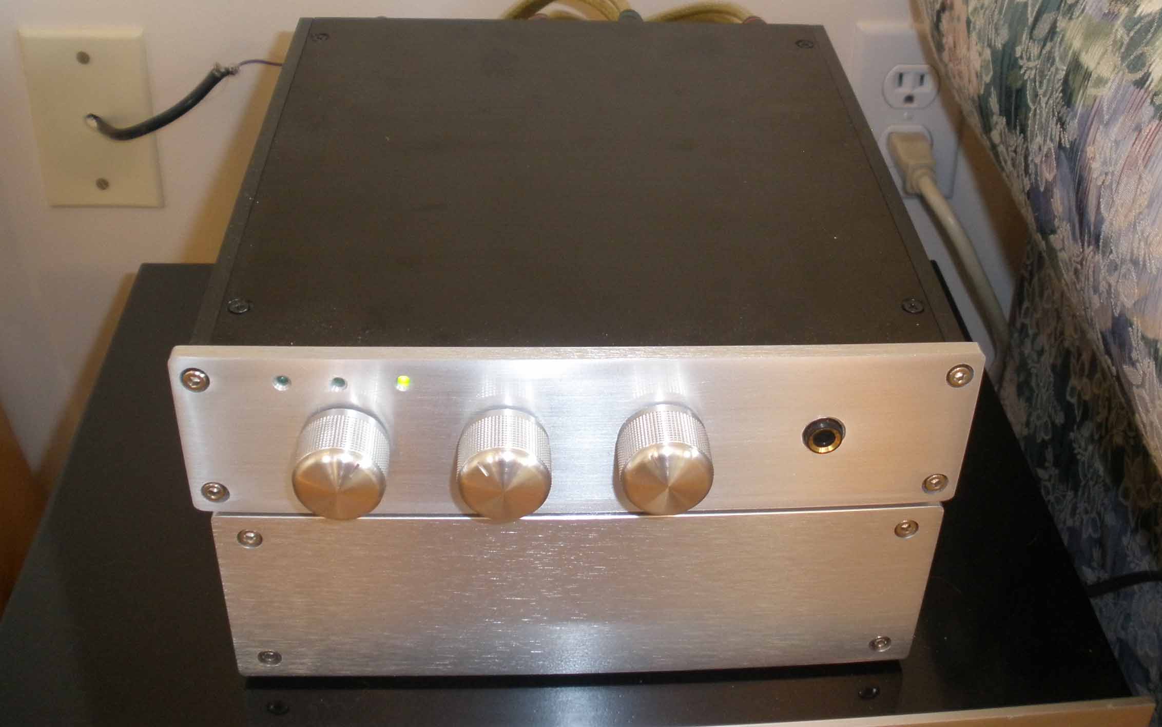

yes, I used Owen's earlier version of the board. Se to SE, changed the gain to 3, used 10k stepped controls for volume and balance. Put the power supply in an external case.
I am very happy
didn't measure. I rescued a Pioneer AM FM Tuner from the side of the road and the output from a Nexus tablet is pretty low as well. That is why I set the voltage gain to 3x.
The sound quality of the nexus is not bad but at high volume levels you can hear when I touch and slide fingers on the screen.
The preamp is matched to Owen's LME49830 Lateralfet boards
