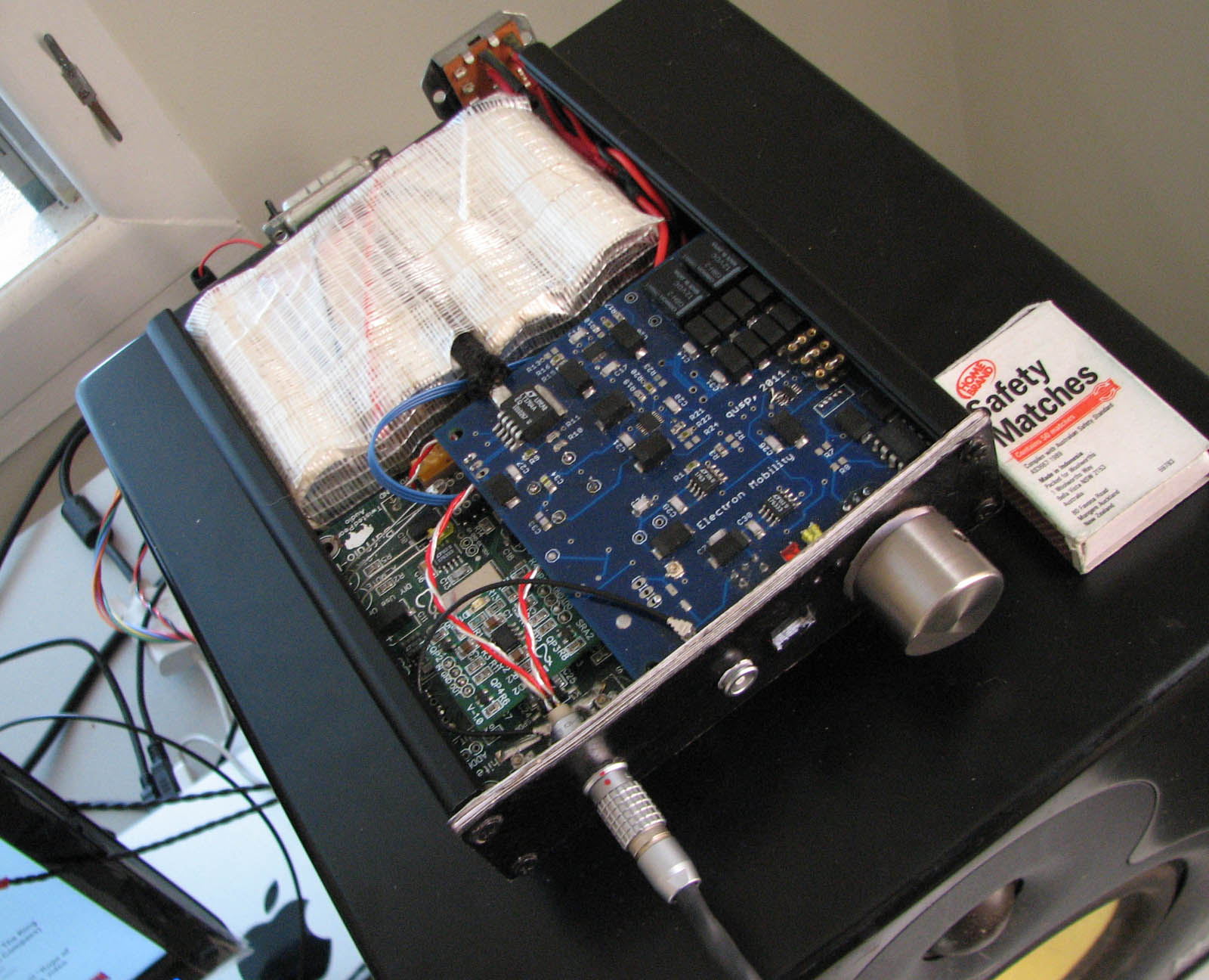

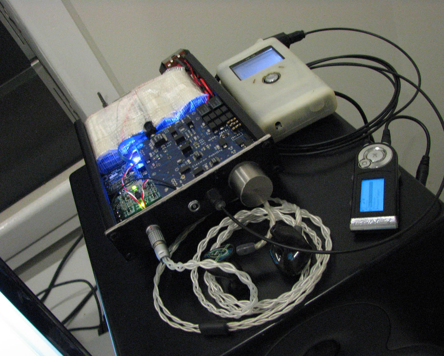

the AKM is a decent choice though, or perhaps the es9016 and modify 'the wire' to have suitable IV resistors. thats what I did with my 'portable' ES9018 + the wire BAL-BAL
the wire is under the blue reg/battery manager/volume control/toslink+BNC input comparator/mcu PCB. It is wired directly to the es9018 dac outputs with ASMP SMD Zfoil IV resistors on 'the wire'
you can see the bling stranded UPOCC silver twisted pair outputs to a Lemo 4 pin, I do have a few long held irrational beliefs left that arent going away any time soon. I still believe in OTT build quality, magic not so much.
