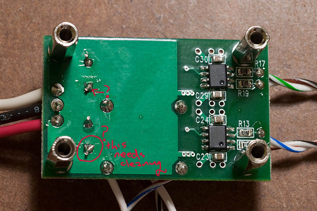

rellum - Well that's embarrassing! But well spotted! I'll fix it up later & report back with the results..
haha yeah well that'll do it. i admit I wasnt looking for something so obvious after the last issue. i would also suggest to try to remove some of the excess solder on your joints, overall there is far too much. in particular there is a blob on one of the power supply decoupling caps on the amp board underside
definitely clean off the one i circled with the ? and note or you will probably end up with the soldermask breaking down and causing a short. do this before you power up again

It worked! Sounds good out of my sacrificial headphones. Just need to case it up now. Thanks for the help guys!
cool!! no probs, did you get some of that solder off the decoupling caps i pointed at in the pic above? if you dont its likely to eventually short through the soldermask and die
yeah part of the cool thing about most opamps is they dont have a ground connection, so you can escape shorts etc sometimes if you catch it in time. did you have to replace the caps? personally i would have at least done that before powering it on again, as they will have taken most of the brunt
Yep, I cleaned things and removed some excess solder before powering it back on.
Regarding replacing the decoupling caps - so far, things sound ok (tested for about 10min), but I'm aware they might break down in the future. Does it have to be the Nichicon polymer capacitors or will an electrolytic do? Does anyone happen to have a few spares, otherwise I'll try ebay.

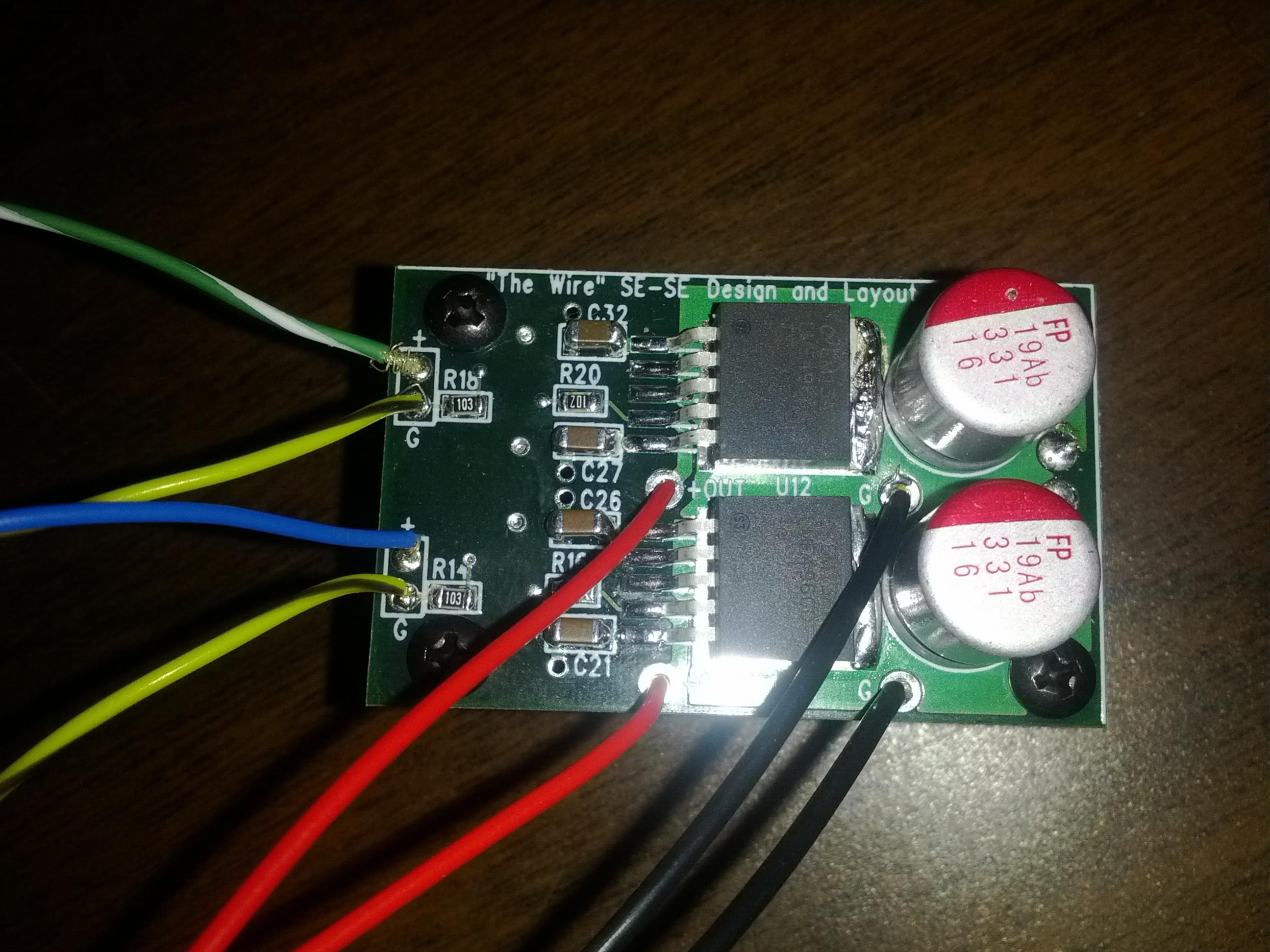

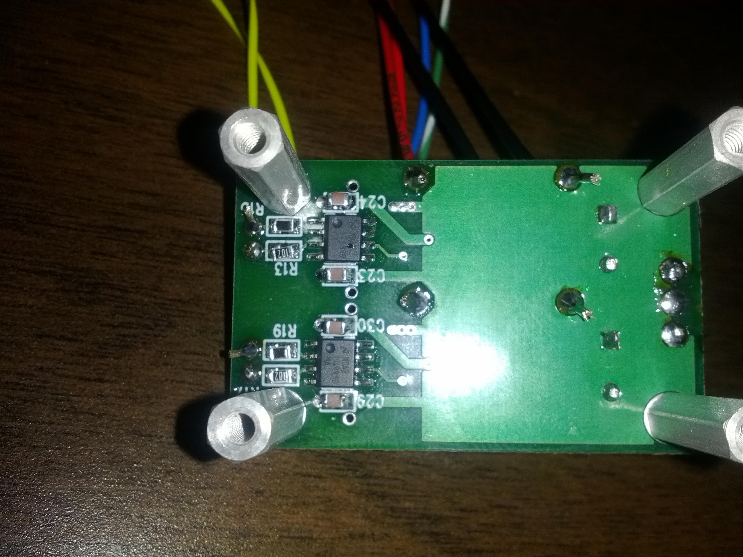

Hey all, so I am building the wire but am having some problems when everything is hooked up. all I hear from my testphones is a constant hum, doesn't change with attenuator.
I have dbl checked the psu and I am getting a good 13V + and -. However once I connect the psu to the se-se board I can't seem to measure any constant voltage.
So i think it might be something with the se-se board. do I need to adjust the psu when connected to the se-se board?
there are no obvious build errors that my eye can see but I've posted pics just in case.

just as just talk alone doesnt help, we need some information and preferably some sign that you have tested the board electrically. without the power supply connected, what do you get when you measure across the power inputs + to G and - to G and signal inputs and outputs L->G and R->G? in general though, the board is a bit messy and there is too much solder.
the main ground in the center of the board looks suspect on both the top and bottom, particularly the top. i havent looked at the layout for the planes, but is the top plane a ground plane, or power plane opc? if its a ground plane, people have to remember that the tabs on the buffers are at full power supply potential i.e. they are live so youve got 2 masive amounts of solder that are causing shorts, if its a power plane then thats ok (although i would clean it up) but the ground wire is definitely shorting.

hmm yea I seem to have a short somewhere. its very odd measuring across + to G and - to G are both giving me shorts. signal inputs and outputs seem to be shorting as well.
so I seem to be shorting everywhere🙂, but still unsure as to where it might be occuring. I have removed all wires from the se-se board and am still shorting everywhere.

well theres your problem a direct short? like zero or close to zero ohms? or you used continuity test so it triggers only with VERY low ohms? because you will get some connection on each of those except the output, as you will measure the resistance of the decoupling caps to ground and the 10k resistor to ground (not with the signal outputs though, they should be completely open) the signal inputs will each give you 10k and the power supply inputs should give you very high readings in the Mohms, like 3-4Mohms and will change as the cap charges. but if you are getting very low readings or direct shorts on all of these, then you do indeed have some pretty serious issues.
i'll have another look, but given you have problems on all of them, i'm going to call catastrophic soldering failure try to clean up the solder joints with some copper braid and flux, carefully or you will scratch the soldermask
