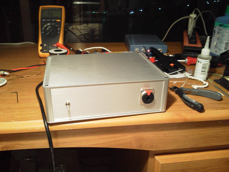

Some pictures of my amp.
Thanks,
D.
man, that looks great!
i hope owen will see this and eventually get excited again to finish up his second version that he has abandoned for some time at the moment 😀
but how do you use the headphone out if you didn't install a volume control? you have digitally controlled volume in the DAC section?
Yes, at the moment I mostly use it as balanced to SE converter. The arc on the back are output.

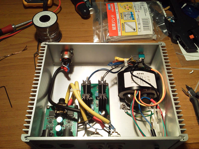

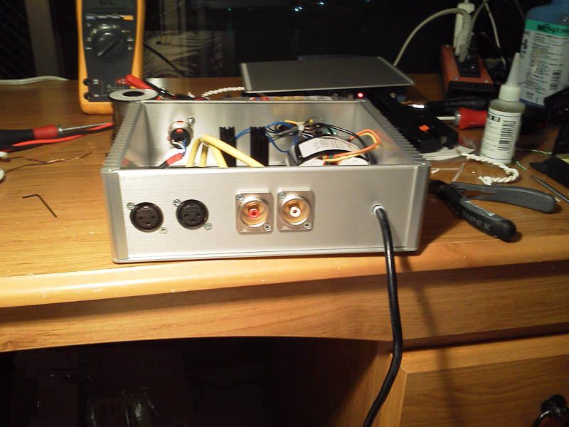

Very nice and neat build. May I ask where you got the chassis?
I'd love to know as well!
They sell these chassis, in various size in the local shops in Akihabara in Tokyo. The side panels are actually heatsinks, but they don't dissipate much. The nice thing is that they come in flat box, so it's very easy to work with the single panels compare to inside a box.
Unfortunatly, I could not find a solution to fully use both the onboard connectors of the board, and I did not want to have separate psu, otherwise the amp itself would be easily drag down by the weight of the cables.
Anyway, I strongly advice everybody to use the on board input connectors, as, as you can read in this thread, I was picking some oscillation with bad wiring. Like this, not a problem.
