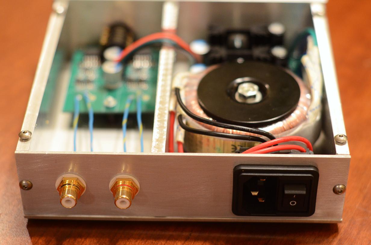

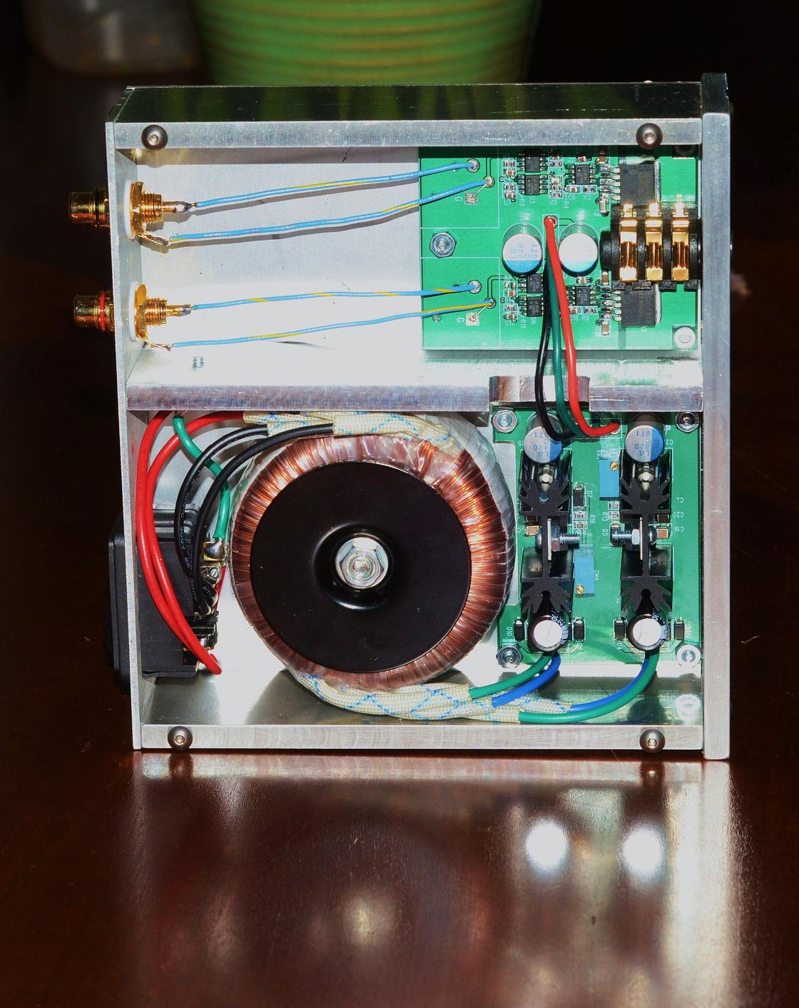

Hello all,

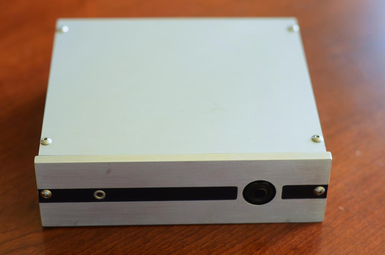

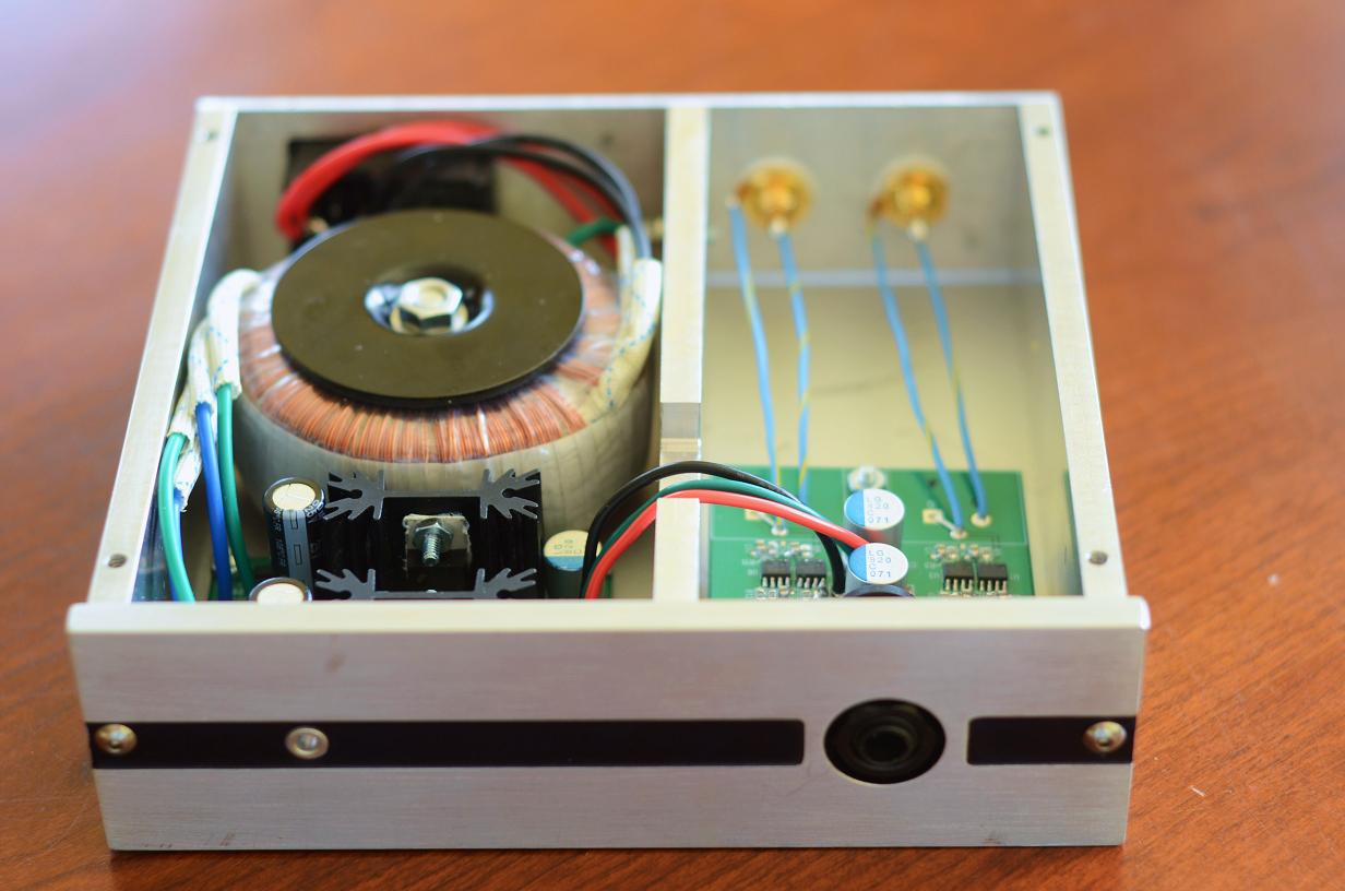

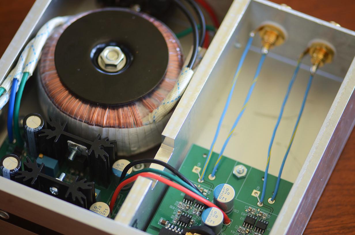

I haven't posted becuse I'm in Ireland this week, but I wanted to share some pictures of my completed amp.
Just to anticipate some questions:
I went single ended because all my sources are too.
I made the case from aluminum I had so no cost there, just my time.
My meter shows zero dc offset with a source connected, I'll check with a scope when I get back to the states.
Sounds great, absolutely wonderful.
You do not need R2 or R8 for single ended operation.
Again thank you Owen, I'm already considering buying another kit, maybe portable?
-Nelson

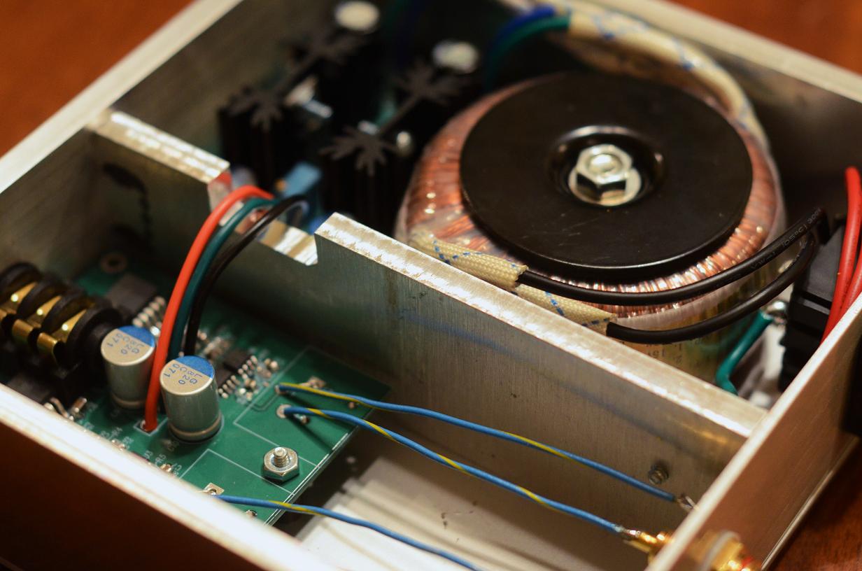

Looks great Nelson!
A couple of questions. What size transformer did you end up using? Also, did you wire up an LED or such on the power supply? I am curious as to the purpose of the hole on the front left hand side.

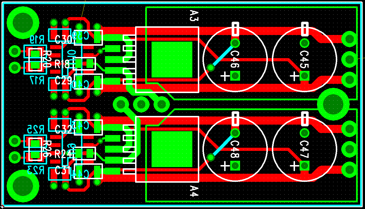

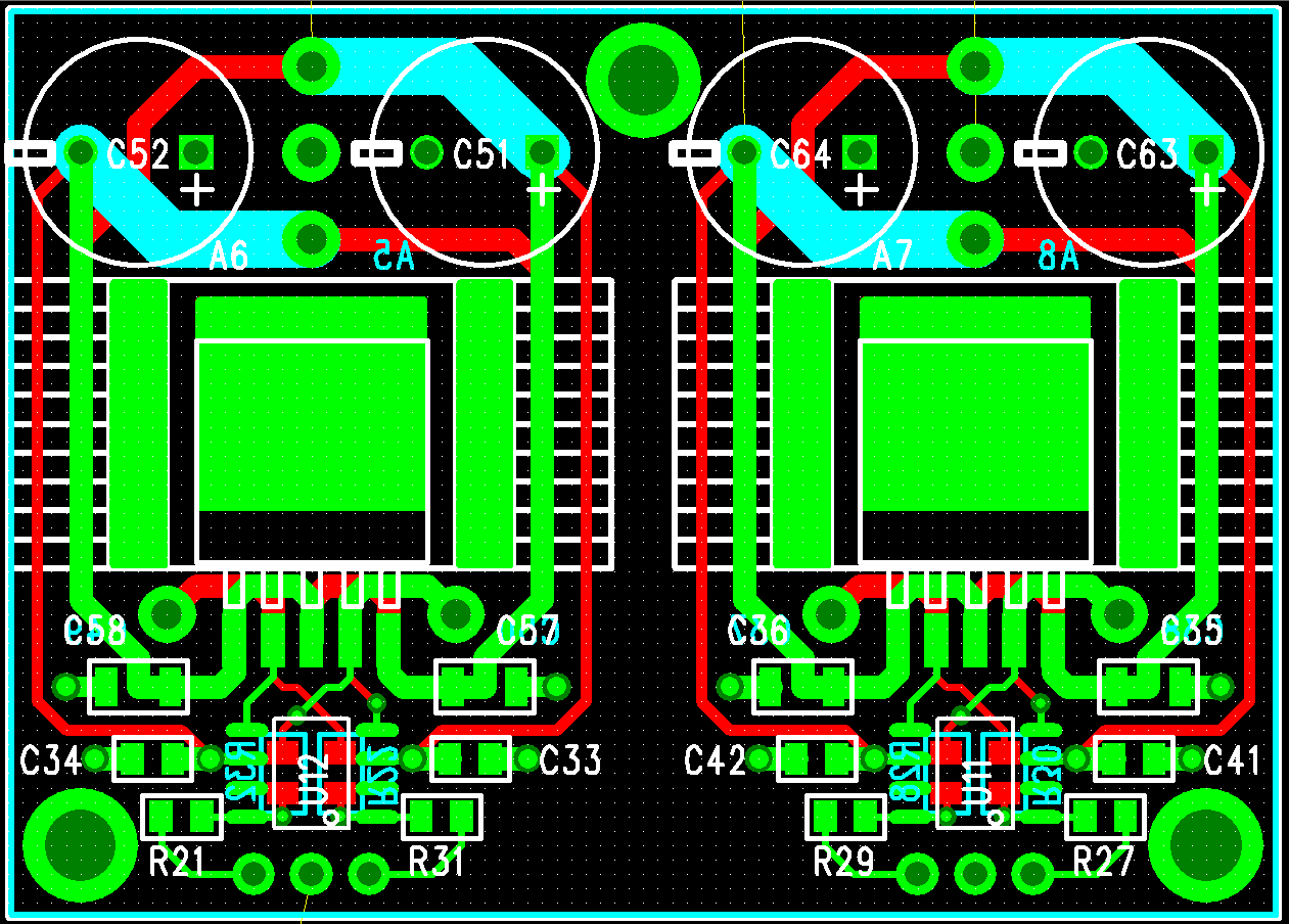

Well, as usual I'm running behind, but I've been hard at work in the background.
I really wasn't happy with the layouts I finished last week, as I I tried to keep to two layers, and things just weren't quite as nice as I wanted them to be. So I sat down, changed the entire design to three layers, and started over again. I'm glad I did.
I'm finished with the BAL-BAL and SE-SE boards, and I'm nearly finished with the BAL-SE board.
The PSU needs to be re-optimized for three layers, so that should probably take a day or two, but I think I'll be finished by the end of the week.
I've attached a screenshot of both the BAL-BAL version and the SE version as they are now. Here is the clarification for those screen prints:
Layer 1 = green - Analog signal layer
Layer 2 = teal - GND reference layer
Layer 3 = red - Analog signal layer (mostly PSU routing)
The ground pour on layer 2 is not shown, but it will be poured separately for left and right channels with 3 0R resistors to allow the end user to choose where grounds will be tied together (one at input, one at output, and one at PSU).
For the BAL-BAL version, I'm using TO-263 SMD heatsinks to keep thermals under control. Each phase of the output bridge is mirrored on both the front and back of the board, with the front end just below on the top layer. Without the heatsinks, there would not be enough copper plane to keep four output buffers cool enough. The PSU on all boards will be dual mono, with the option of removing some 0R resistors to separate the front end PSU from the buffers. This board is 2.2" x 1.6".
For the SE-SE version, there is plenty of copper so heatsinks are not needed. I really like the way this layout turned out, and at 2.2" x 1.25" it would be a perfect candidate for a portable setup. It gets full dual mono supply options and the same resistor GND selection as the BAL-BAL version.
I've also attached the schematic for all three amps and the PSU. Please feel free to check everything over and let me know if there are any comments, suggestions, or errors.
N-Brock:
That is a VERY nice job you've done with that enclosure! It's exactly how I wanted to do mine, and I really like the layout and dimensions you chose.
If you'd like, I'll send an SE-SE board your way free of charge since you're to first one to post a truly completed project. I really appreciate the feedback, and I know how much work goes into making a finished project like that. Kudos!

Looks great Nelson!
Thanks!
I used a 25VA transformer from antek, but only because their 10VA version was out of stock (and still appears to be).
Yes, the hole on the left is for power indication. I used a small incandecent lamp on the secondary side of the transformer. It shines through some blue plastic on the inside of that hole.
Wow, that's awfully nice of you. Could I buy the components and a PSU kit on top of that? After a bit of thought, I really don't need a portable headamp, but I think I'll try to make my next version as thin as possible. Should be fun.
Thanks,
Nelson
