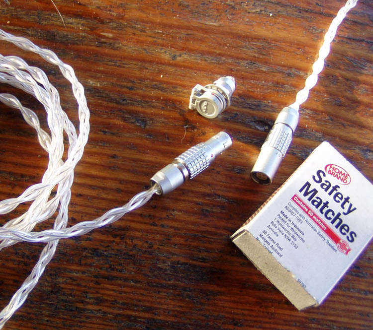

cool, any chance you could put an optional pattern for the dgn version of the opa1632? as in soic8 and dgn right on top of each other in parallel with a via in the middle for the power pad. its got higher current capability and a better connection for vcom. plus i have a small rail of them and ths4131 in that package already 😀
as for connectors, i like lemo or hirose hr10, the hr10 is becoming a bit of a standard for balanced headphones, as is 4 pin xlr, but i think even 4 pin xlr is a silly size for a headphone connector. i like lemo the best (see bottom attachments for it fitted to my jh13 cable and early pics of the portable sabre, but i'm probably on my own here a bit, i think everyone would agree they are the superior connector, but you wont find a headphone other than diy using one and they are a bit pricey.
the hirose hr10
and panel socket are also excellent and quite a bit cheaper, not as sexy though, or compact (though still much more compact than xlr. if not i would suggest if you could just leave it as throughole 2.54mm pitch header type connection, i could just make my pcb mount lemo above fit without putting others that arent keen on reterminating their headphones out.
the hirose hr10
