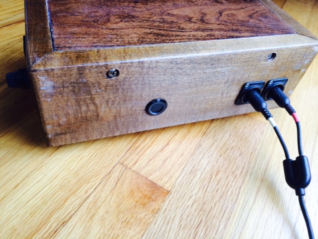

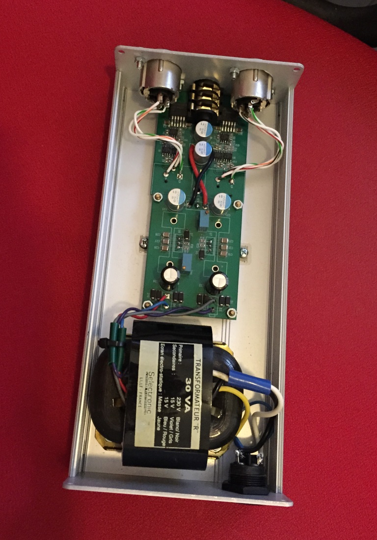

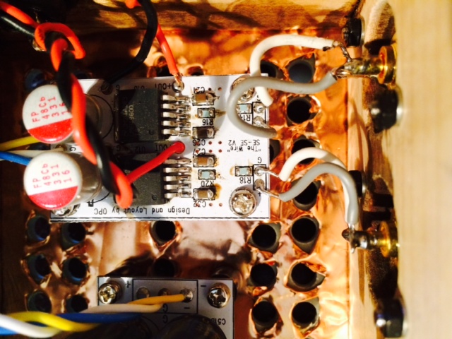

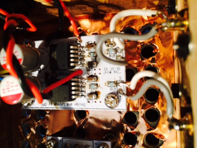

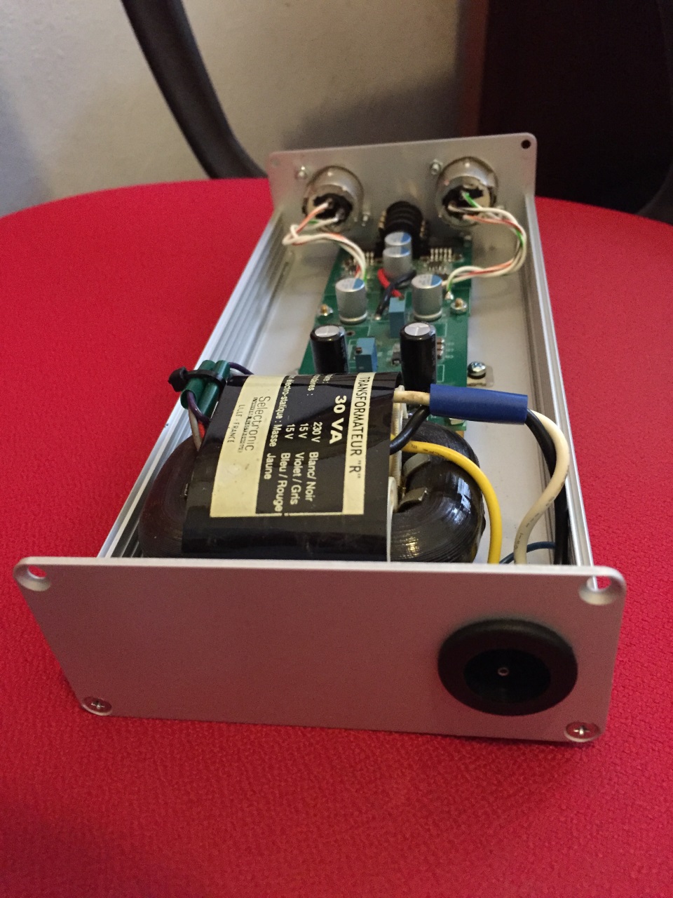

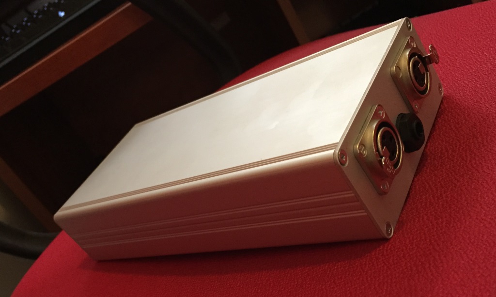

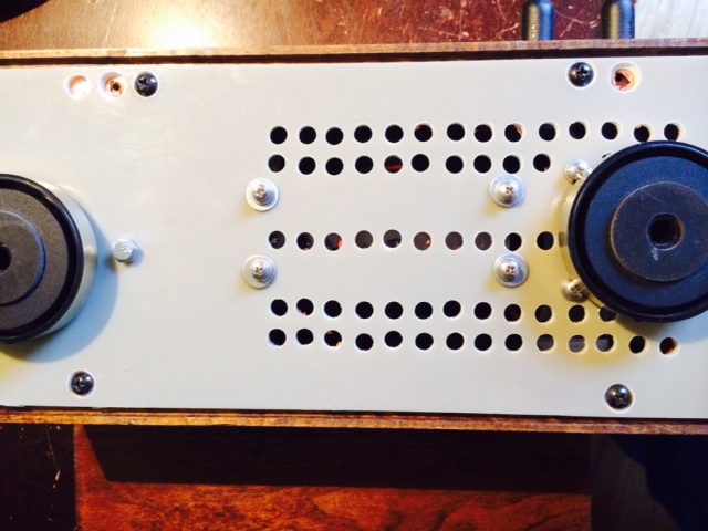

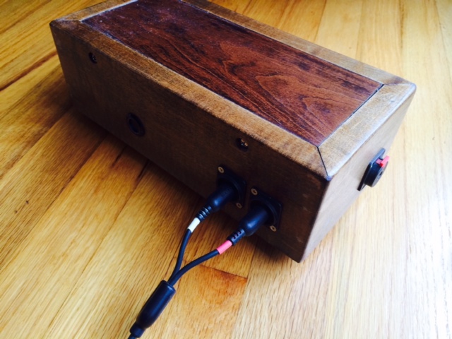

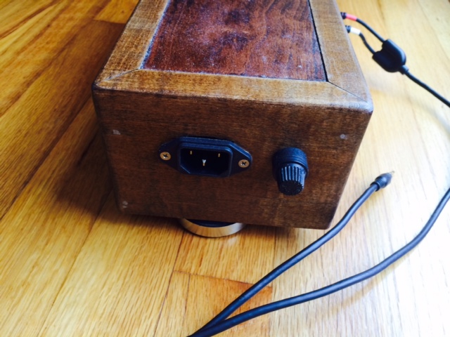

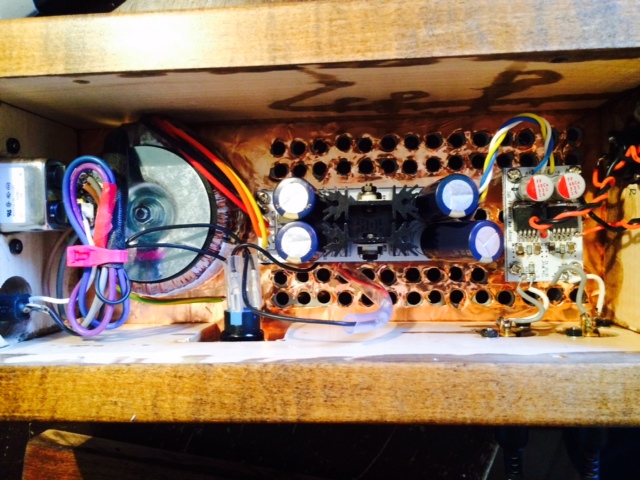

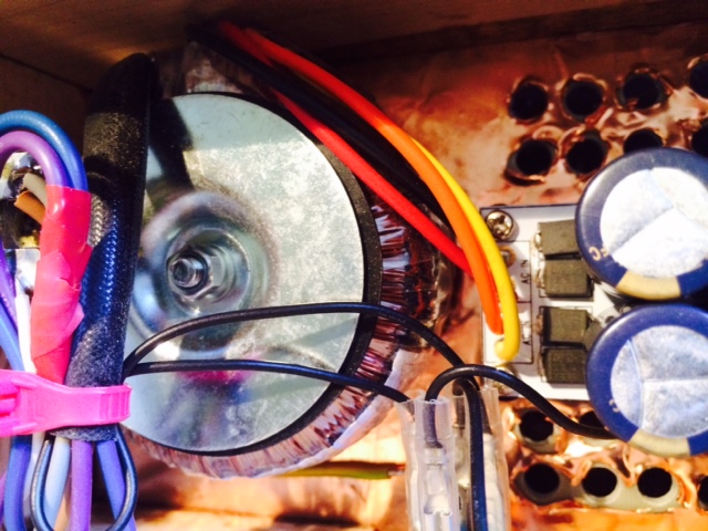

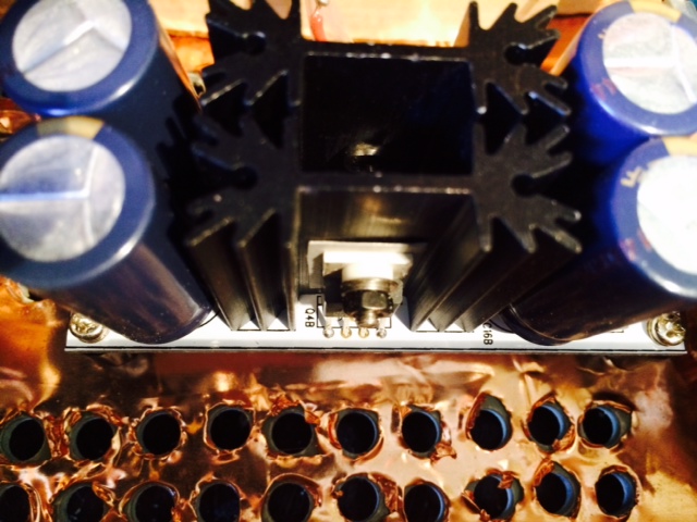

Last year I made few attempts to build a tube headphone amp using DHT's. For certain reason, I didn't get the sound that I wished for...and also the size made me abandon the project.
Browsing DIY Audio site, I was attracted by OPC's simple design of the "Wire" headphone amp. I've never build with SMD's before and I can say that the soldering was a little challenging. However, Owen's boards are very well made and everything worked at the first try.
I am very happy with the sound of this superb headphone amp. I am using it between my iPad and Sennheiser HD595 and I can tell that my listening experience was brought to a lovely level. The dynamics are excellent, dead quiet, channel separation is amazing, strong base, and very detailed mids and highs.
Thank you Owen. Happy Holidays!

Beautiful implementation!
This is exactly how I always intended "The Wire" headphone amps to be used.
I've sullied mine with a stepped attenuator, but I plan to build one just like yours once my DAC is done 😉
Enjoy!
Owen

Wow, Paul, love the case! Nice job. Plenty of room to add a USB/I2S card and DAC, which is what I want to do. Where did you get the case? I assume you had to engrave the text into the front and rear panels, or is it just paint? Hard to tell from the photos.
All done 🙂
