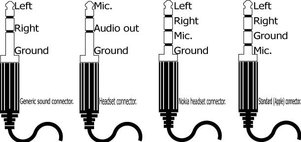

The Wire and V-Moda XS
I am a happy builder and user of The Wire with Sennheiser HD600.
The amp also correctly worked with a number of cheap headphones I used for testing it before connecting the HD600.
I have also portable V-Moda XS. I connected them to the Wire via a plug adapter from 1/8" to 1/4" but the sound level is very low and clearly low-fi like a distant sound from an old radio. On the contrary the V-Moda correctly work with the C-moy amp I also built.
I changed the adapter without success.
Please note that the V-Moda have a cable with microphone for smartphone use which adopts the Apple 1/8" jack.
I replaced the cable with standard 1/8" to 1/8" jack I already have but the V-Moda does not work at all, even with the C-moy.
have you any idea of the problem?
Thank you

What you could also do would be to use a 4-contact headphone jack on your Wire that would mate correctly with your headphones' plug - it would work just the same with regular 3-contact plugs since you'd leave the 4th contact open. You would probably be limited to using headphones with 1/8" plugs though, I'm not sure if they make 1/4" jacks (and 1/8" to 1/4" adapters, which you'd need to be able to use your V-Modas) with 4 contacts. Or use a 4-contact jack to make an adapter like multisync suggested.

Hi northernsky,
You described the sound as "clearly low-fi like a distant sound from an old radio" which to me says you don't have a proper GND connection between the GND pin on the headphone jack and the GND in The Wire.
When this happens, you end up only hearing the delta between the L and R channels as the two channels of the headphone are driven in series between L and R through the common ground.
This is most likely being caused by the 3-4 pin adapter you're using, so perhaps the new cable you just ordered will fix that.
The alternative is to add a 4-pin jack to your headphone amp just for these headphones, and wire it in parallel with the existing jack.

I got the audio only cable and now The Wire is properly driving the V-Moda too.
Thank you for the wonderful amp
