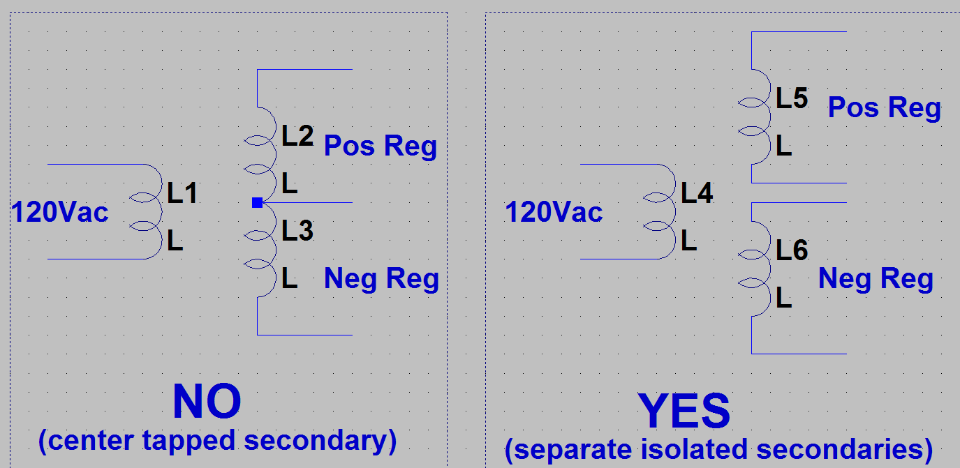

Well, I soldered and checked everything twice, but same result. I also noticed that the voltage regulator is getting hot after only few seconds. It's the side, where Owen's fix is. I mean the shorted C6-pad. Could this be the failure? How can I check if it's still shorted?

Hi Guys,
Just wanted to clarify that I got everything sorted with Stammheim offline.
He was using the same phase of the transformer output on each AC input which effectively short out one of the regulators (the positive one).
This serves as a nice reminder to everyone that it is imperative to use a proper dual secondary transformer and to fully float both AC inputs! A center-tapped transformer will not work with these amplifiers.
I will draw up a diagram when I get the chance to show the external connections and how they need to be made for additional clarity.
Hopefully Stammheim can report back when he gets both unit back up and running.
Thanks to everyone for their help and suggestions.
Owen

But why???
Here is a picture. 🙂
Instead of using a positive regulator chip and a negative regulator chip, opc used two negative regulator chips. But they are very very good negative regulator chips, better than the positive compliment, and you don't loose anything wiring it up that way. But the two secondaries have to be completely isolated, not center tapped.
So you shouldn't have any continuity (infinite ohms) on your ohmeter when measuring from the two secondary wires for the positive regulator to those for the negative regulator (transformer not connected to the circuit yet, of course).

Yes I know about the negative regulators, Owen wrote about the fantastic result using this regulators. But it should be no barrier to use two amps with one transformer.
The transformer himself is OK and powering each amp fine, but only one connected.
