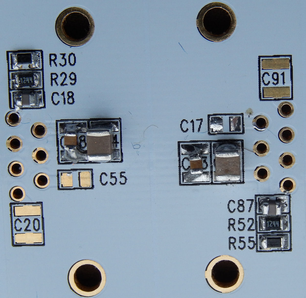

Started soldering my PSU and noticed that the caps specified in the BOM do not match the outlines on the PC board for caps C17, C55, C28, & C93. The pictures of your build show them properly fitting the out lines. I also saw from a previous post that there was a discrepancy between the BOM and the schematic but thought the error had been corrected. I have a feeling C17 & C55 need to be swapped with C28 & C93. I hope not as I have already soldered C28 and C93.😡😡😡

Hi Jim,
Are you following the BOM and Schematic posted here?:
I believe everything is correct there. C93 and C28 should be 0805 capacitors at either 1uF or 0.1uF. This value is not overly critical.
Can you post a picture of exactly what you're having problems with to avoid confusion?
Owen

Thanks for the reply. I am using the same BOM as you have just posted. The attached photo shows C28 and C93 not correctly sized on my board. The parts for C17 and C55 are the same size as C54 and C85. (same part) The picture you posted of the PSU a few pages back show C28, C54, C93,and C85 as all being the same size. Hence my dismay.

I just had a look at my boards and it does indeed look like C28 and C93 are in fact 1210 rather than the 0805 listed in the BOM. And C17 and C55 are 0805 footprints rather than 1210 as listed in the BOM. Looks like a swap of some sort.
Alright... it looks like there is a mistake, but I don't have the layout in front of me to confirm.
Please hold off on soldering until I post the correct location this evening.
Looking at the board in the picture from Jim, it looks like the two 0805 parts need to be moved to C55 and C17 locations, and the two side-by-side 1210 parts should both be 22uF 1210 caps.
I will check what happened tonight, but I suspect I put the REF DES in the wrong spot on the PCB itself.
In the meantime, you should be able to work with the info above to proceed if you'd like.
Owen
