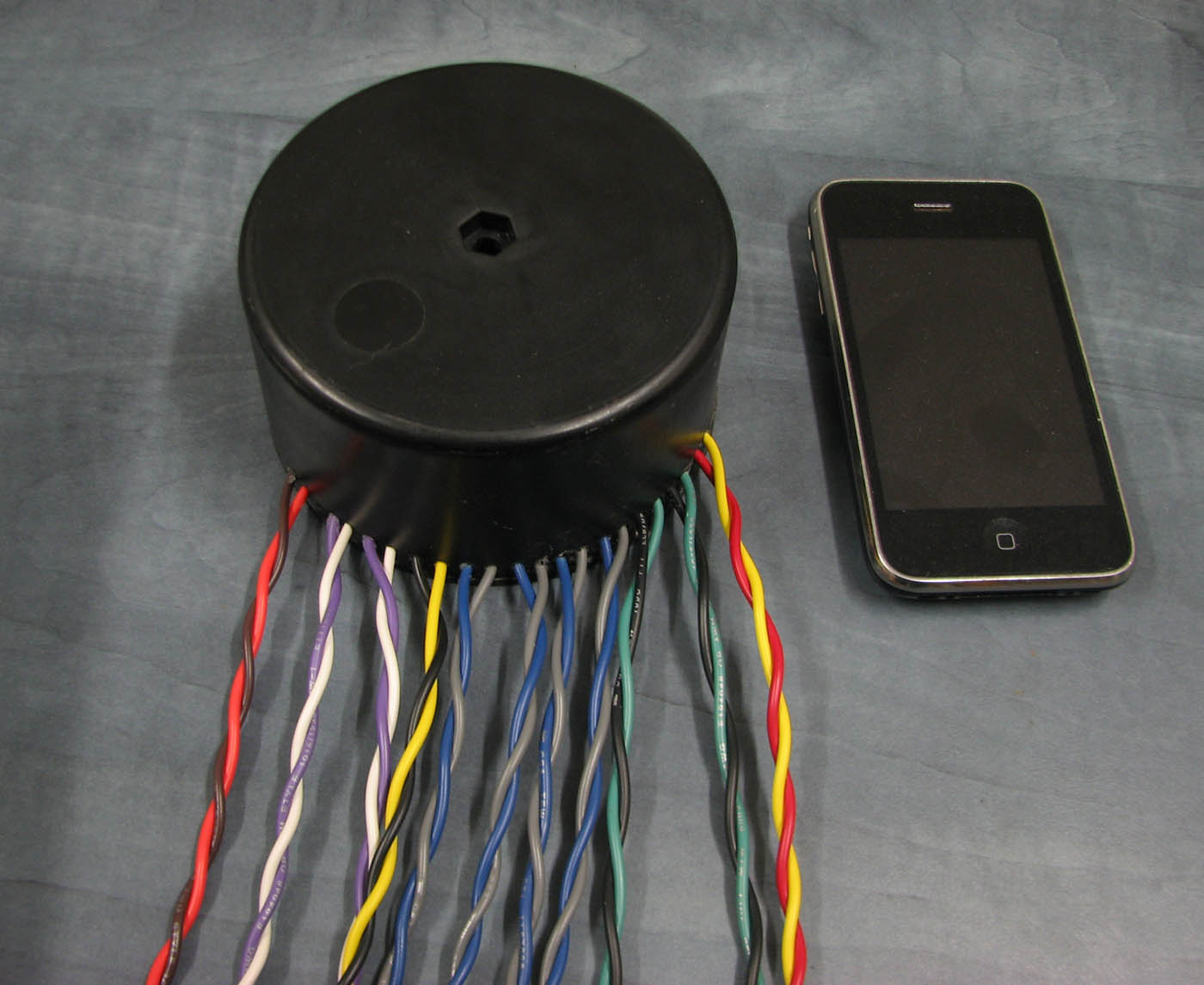

Hi Guys,
I'd like to apologize to my 230V friends, I have no idea what I was thinking when I wired it up like that. I was in such a hurry to get it finished, that I think I looked at it and in my head was thinking "if you need 230V you can just buy a 230V transformer" which is obviously non-sense.
A pair of jumpers on the board would have alleviated this issue...
So here's what I propose:
1. Buy the dual 9V output and just put 240V across the primary in parallel. This would need to be thoroughly tested by someone is AUS, as there's a chance it will saturate the core of the transformer. The actual voltage isolation isn't an issue as the primary is already adequately isolated for 240V, and the change in voltage on the secondary is negligible when it comes to insulation capacity. This would give you dual 18V outputs, so you might need to change over to 35V caps on the primary, but the combination of heavier gauge copper on the secondary and more voltage would mean you'd probably get better voltage regulation and more power output.
Digi-Key - TE2257-ND (Manufacturer - L01-6361)
2. Cut the end of the board off just past the two secondary inputs on the board, and mount a transformer to the chassis base where the old board used to be. This would allow the use of a larger transformer (50VA) in the same space the board mounted one used to occupy. I use a shear to cur boards, and it leaves a perfect edge if you're careful.
3. Buy a small 25 VA non-potted toroid and just mount it through the bolt hole on the board:
Digi-Key - 237-1326-ND (Manufacturer - VPT30-830)
The above will work, but if you can find one that is taller and not as large a diameter, then that would be better.
4. Mount a much larger toroid off-board and just wire it in the way you need it.
5. Have a custom toroid made that is potted and has the correct pinout. I'm not sure how reasonable this is with the smaller numbers here, but if you can find someone to do it, then go for it!
If someone is willing to test #1 then I'll pay for a toroid, but it will have to be proper test that looks at the current waveform on the primary. We should be able to see if it's saturating the core based on the profile.
For the heatsinks, I would probably suggest sticking to the top of the board, and not the bottom. The thermal resistance through the PCB is probably worse than it is through the packages, but the larger surface area probably makes it better overall. The real target needs to be the top copper plane on either side of the buffers. That means the heatsink proposed by HYPERTUNE really is the best proposal, and will be more than enough to keep the heat in check.
I would still strongly suggest a good TIM and would be interested in a few strips of the keratherm. It would be best to apply a strip across each row of devices, and another strip across each copper plane on the edge of the board. Use thin material that has high compliance for best results.
If you really want to go all out, perhaps HYPERTUNE could also machine an aluminum bottom plate/sink with threaded holes so that the heatsink could be bolted down onto it, sandwiching the devices between two hunks of aluminum. This would definitely be the best thermally, but requires more machine work and more TIM.
Owen

ahh of course, i was 'thinking' the heat was being sunk to the ground pour, but the tabs of the buffer are live which is the top and then the middle ground and the bottom neg, so of course the bottom will have more thermal impedance, we just need to try and interface with the top copper as well as just the epoxy parts as Mark and you have suggested. i was never suggesting not using Mark's sink, it would be silly to turn such a great offer down, i was just still thinking out loud since we dont have any final design from him yet that it would be better to sink to the bottom and turn the entire unit upside-down, so the fins are at the top; this of course is a fools errand in light of your assertion
Hey Mate, look dont worry i know this was a last minute thing adding it to the plates for the board-house on a whim without an announcement and i'm sure you didnt expect it to continue the theme of selling out in 24hrs.
So Owen: of your options, due to myself and i'm not sure anyone else on this side of the pond having the gear you mention to test core saturation, although i suppose it could be spiced i would think it a pretty complex model.
due to this fact, this actually makes me lean towards the custom trannie or regrettably offboard, but i really want to keep the self contained goodness of the design. Richard will do a small order no worries, he specializes in one off custom orders so a small group will be no problem at all. He over-sizes the cores, but he also models and thoroughly tests his products and supplies a certificate of the pot testing, insulation testing, load and no load testing, duty cycle, efficiency etc all on an individual basis, very thorough and i have no doubt that he will be able to tell me if this is viable without passing step one.
so i'll contact him tomorrow and i guess i'll get in contact with HYPERTUNE to see where hes at and discuss what might be the best way forward WRT to TIM from Keratherm; then i'll send off an enquiery to them as well. so you are interested in enough material for all 4->6 of your amps?

I'd be interested in a pair of the 230V primary transformer from SumR. I'm somewhere on the fence between custom transformer and opc's Option 3 stated above.
For me, Option 3 is more a fall back position if price of the custom transformer is going to compromise me being able to buy the rest of the gear for this build.

If you specify the primary side of the transformer to have wire leads rather than fully pcb mount you can hook up mains however you want.
yeah i'll mention this to Richard, if i'd known i might have got opc to use his board shear and chop it off so i can just use the potted 50va sumR trannies i already have

I'm favoring a single transformer, shielded, off board for 2 amps. $17.50 + Shipping
Antek - AS-0515
http://www.antekinc.com/pdf/AS-0515.pdf

Wouldn't you need 4 secondary windings for a single tx supplying 2 amps?

The transformer you linked only has dual secondaries though. Wouldn't you need one with quad secondaries if you want it to power two channels? Unless you plan to hook the secondaries up in parallel to the two boards.
I understand there may be benefits to "mono" configuration. I don't think the compromise is so great. They have suitable transformers for mono blocks...they don't meet the size constraints for on-board use.
I would actually prefer both channels in a single enclosure. A bit bigger transformer, maybe 80-100 VA with quad 16-17 VAC secondaries would be my ideal transformer for this build I think.
a transformer with 4 secondaries does not need to be huge at all. not dual mono technically, but close enough. this is for a dual differential dac for all but the main analogue (IV) supplies
