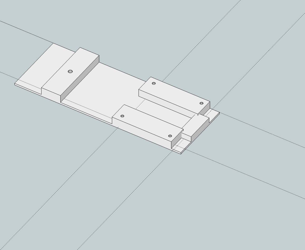

I know we've all had a few discussions about heatsinks already, now spread over both threads and many months, but after working it through over email, qusp and I came to the conclusion that heatspreaders underneath the pcb and attached to an enclosure would probably be the ultimate solution. I think this is a variation on one of your earlier suggestions.

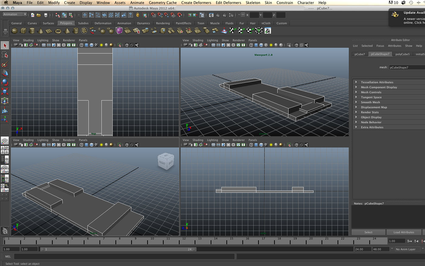

I've attached a model that I drew when thinking up ideas for a custom floor that was going to be made by hypertune but is on hold till we find out exactly what's going on there. I believe a similar result could be had with aluminium bars, that is essentially the backup plan that qusp and I have.
I have dimensions for the attached diagram, though the mounting holes are more diagramatic in their location everything else should fit and has space allowance for the components mounted to underside of the pcb.
Thought I'd share it and see if it helps with any alternative ideas you come up with. It's been frustrating experience so far and qusp, opc and I have all invested significant effort in trying organise to get hypertune over the line with this and we've had no joy so far.

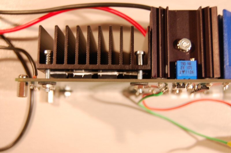

Chris, Your approach kicks my analysis back in gear with my first cup of coffee. 😉
Over in the other thread, exa065 provided a view of his solution in post #444:
I share this to aid in our discussion. Help me work through my speculation to assure us all that I understand. 😉
My thoughts in my last post have the sink positioned just as exa065 does.
The bars I posted on above would obscure from view the ends of the buffers in exa065's photo.

Your below board schema have 4 areas of contact: 1 under each row of buffers, 1 under the op-amps and 1 under the transformer. I like your approach.
I was going to order aluminum stock this morning. That is now on hold for further discussion. 😉
Do I understand?
Do I understand?
You've got it perfectly Ed!
The idea was driven to try to avoid ventilation being necessary for the buffer heatsink and to minimise enclosure size/height (enclosure becomes the heatsink like you've said) since we're still doggedly marching down the path of the mini-block!
Without having it machined from a single block I am not sure how to secure the bar for the opamps in place other than to rely on friction. Any ideas?

Note the data sheet gives a range of thicknesses. Direct measure of one of the LME49990 is 0.063". I think this is suitably close to 1/16" to allow heat sink compound to fill the gaps.
Select stock where the difference in thickness is equal to the thickness of the op-amps.
For registration I would extend the op-amp spreader to engage to outermost corner holes of the board.
Relief would have to be provided so the op-amp spreader and the buffer spreaders don't foul one another.
This becomes a simpler install than the fiddling I was going to do.

if you guys have a proper cad file, can you post it? I wouldn't mind seeing what sort of quotes I can get from local machine shops.
nah just Maya and its not finished as i've been unwilling to spend any more time on it till it was definitely going to happen. I could output something they could use if it were, HYPERTUNE has just emailed me back, says he'll run them tomorrow or Monday! so lets see how that pans out, nobody make any purchases for alternatives just yet.
I do have a model for the heatsink hes going to run thats suitable if it comes to that. but nothing final for the floor based one
