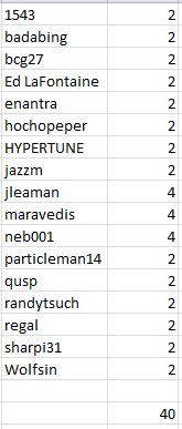

I compiled a list of all the requests so far, and we're at exactly 40 boards.
I was a little ambitious earlier when I said I was going to keep 10 boards, so I'll raise the cap to 44 boards. That means there are 4 left up for grabs, and it's first come first serve.
