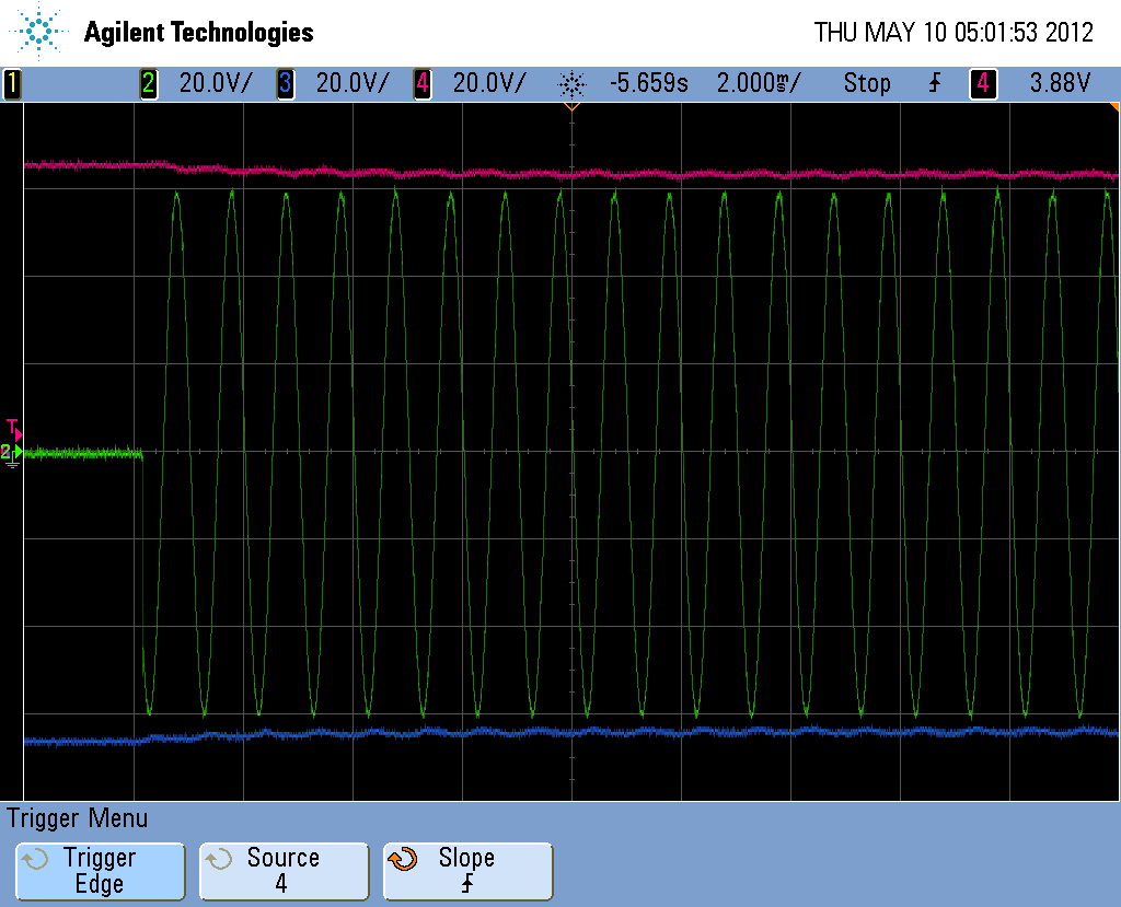

npdot:
Thanks very much for sharing your results! I'm a little puzzled about your results between setup 1 and 2, so I'll see about re-checking them here. My initial design for this used standard IRF mosfets with a full thermal compensation circuit, and that amplifier showed obvious deltas with higher LME voltage, but it looks like the laterals don't show quite as pronounced a difference.
I have noticed that with the non-lateral fets you could literally bang the output right into the rails given a high enough delta between the LME rails and the output (usually between 8V and 15V higher depending on the FET). With the lateral fets, you don't get the same behaviour presumably due to the higher ON resistance.
Still, from what I remember I was getting closer to the rails than that... Usually within 4-5V without any clipping, and often less than 4V if you use 1% THD+N as the "clipping" level.
See the attached scope screenshot for reference.

npdot:
Out of curiosity, how do you define "1VRMS below clipping"?
Is clipping:
- The first visual sign of a distorted waveform on a scope?
- The point where THD climbs above 0.1%?
- The point where THD climbs above 1.0%?
- The point where THD climbs above 10%?
- The moment distortion climbs above 0.003%?
I'm just curious because all are technically acceptable but there is obviously a lot of variance in output levels.

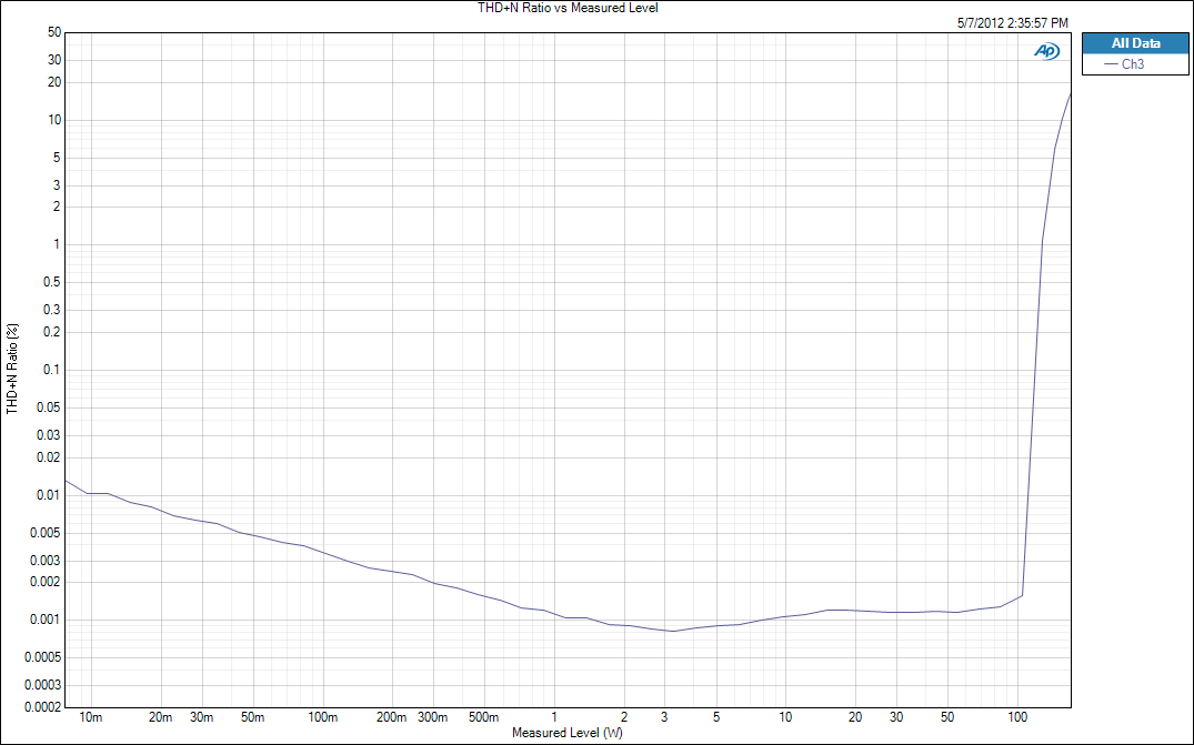

If you look at the attached image for the amp with the DPS-400 power supply, you could say the "clipping" level is anywhere between 100W and 175W depending on how you define it.

Shouldn't we all have access to nice test equipment, and just with a push of a button get HD graphs like this:
(Linked from Adrian Kingtons website)
Thanks for your explanation.

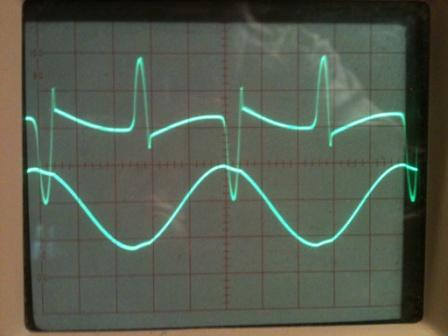

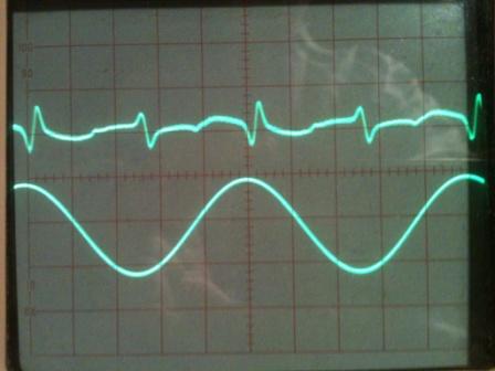

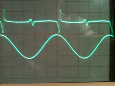

AndrewT,
Here are the scope traces for my test #1 scenario. The bottom trace is the amp output; top is the residual from the analyzer. You will notice that in the 1% case, the residual and the notches in the output waveform correspond. For the 0.1% case only one of the notches is still visible. For 0.01% the notches are completely invisible in the trace. The distortion residual, however, shows where the clipping notches would be seen if the scope could resolve them. The scope settings are the same in all three pictures.
Neel
Neel
AndrewT,
Correction: The last picture is with the residual trace magnified x2.5 from the others.
Neel

I cannot see the flat tops on either the 0.1%, nor the 0.01% distortion waveforms.
I can see flat sections near the top of the 1% waveform. But I would not call them flat topped. The straight bits are sloped and seem to start after the top and then carry on down the slope.
Why are the flat bits not at the top?
When I look at clipped waveforms on any of my amps I see the flat tops at the top.
The clipping is at an angle, not a flat top, and not symmetrically centered on the wave form. I will post a more pronounced example. I have seen this many times with many different amps. Perhaps someone can provide an good explanation.
could it be due to using the LME and it clipping first?
or
to a too small transformer VA?
or
to too small smoothing capacitance?
or
to a very high impedance on the primary side of the transformer?
or
That behaviour is completely unlike any I have witnessed.
or
