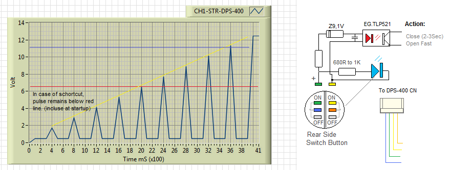

Yes, can be as DPS-500/S same scheme remote control. 4pins connector.
Ideal for E-Switch,circular button with led. "Led have active functions"
pulse at start for 1-3Sec. or pulse for protection. off immediately.
I'm waiting for the test Opc (not knowing if.. it's a good SMPS) :)
but for any adjustment considering the type of amplifier. particularly in the startup sequence.
After test, i explain why this smps not use chip pwm.
Regards
Well, colour me interested!
So Roberto it latches on after 2-3sec pulse on control wire? What is the voltage required on control circuit?
after 1-3 sec, permanently illuminated. if you mean voltage of led,it drive up to blue led. (3-4V via resistor) on this pins. but, after startup sequence, in this pins, are present 12-14V. it is possible use also for driving mini-relay for protection on amplifier. some use this with photodiode eg. tlp521, then obtain..delay on start and fast switch-off of relay.

What he wrote there is a big deal for anyone looking for a very clean and simple solution to overall startup, shutdown and speaker protection.
All you would need is a single relay on the loudspeaker output, with the coil wired up to this supply. If I'm understanding AP2 correctly, then this would delay the turn on of the relay by 3 seconds which would eliminate any chance of turn on transients, it would open the relay in the event of a supply failure (short on output etc...) and protect the loudspeaker in the event of supply problems, and it should presumably open the realy on shutdown.
Now that's built in convenience!
AP2: Can you better explain exactly how this scheme works? Is there a datasheet that explains the ins and outs in detail?

I think the ability to connect a switch with light (remote control) directly on the SMPS can simplify installation and make it clean, no other pcb to add.
but if someone wants to use this function, then it is simple.
Notes: The main reason for this circuit , similar to a ramp generator, the SMPS to provide an effective protection, especially during startup. Indeed, one problem is just when the short circuit is already there When switch-on.
Regards
