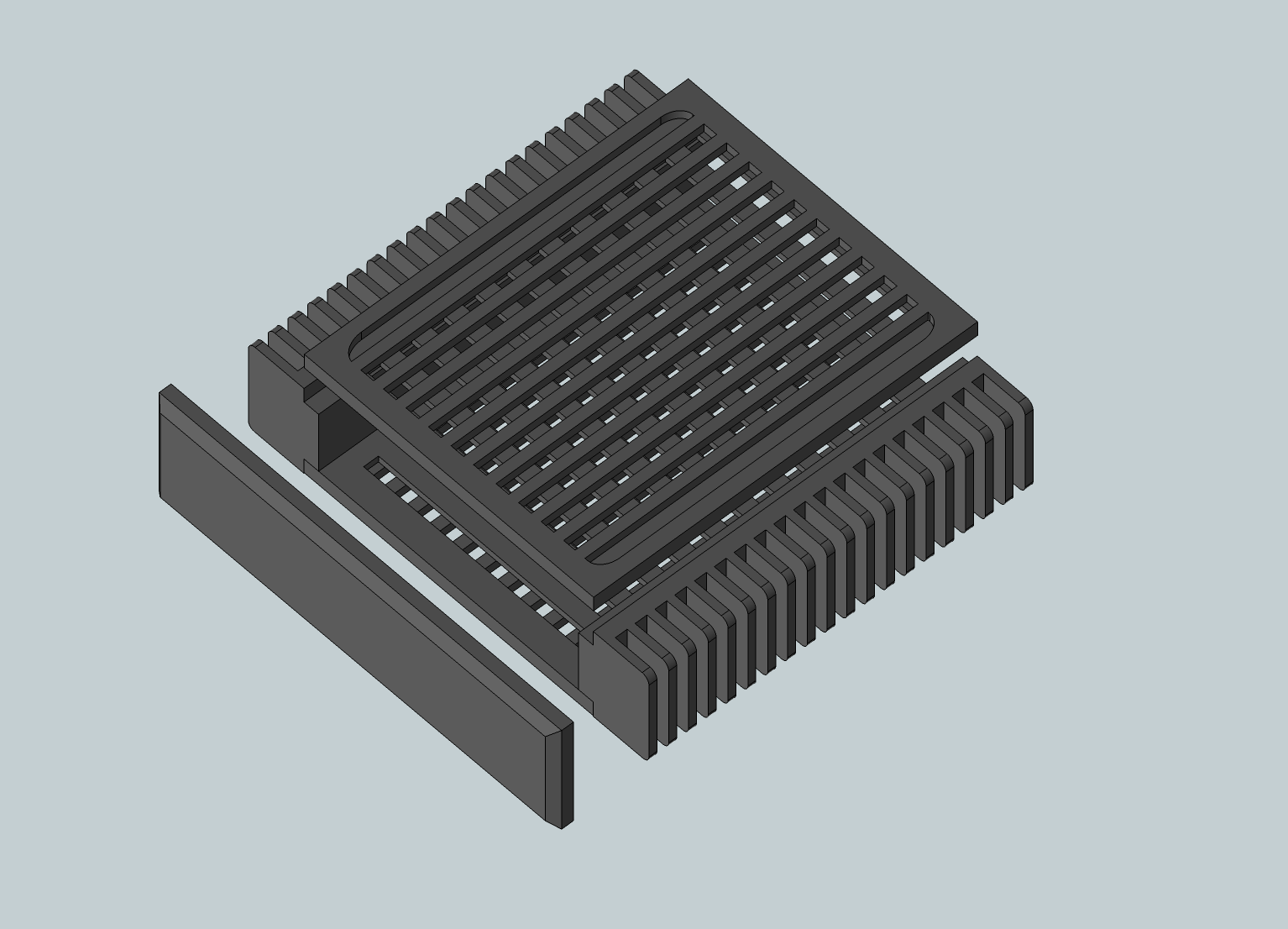

Nice case Hypertune.

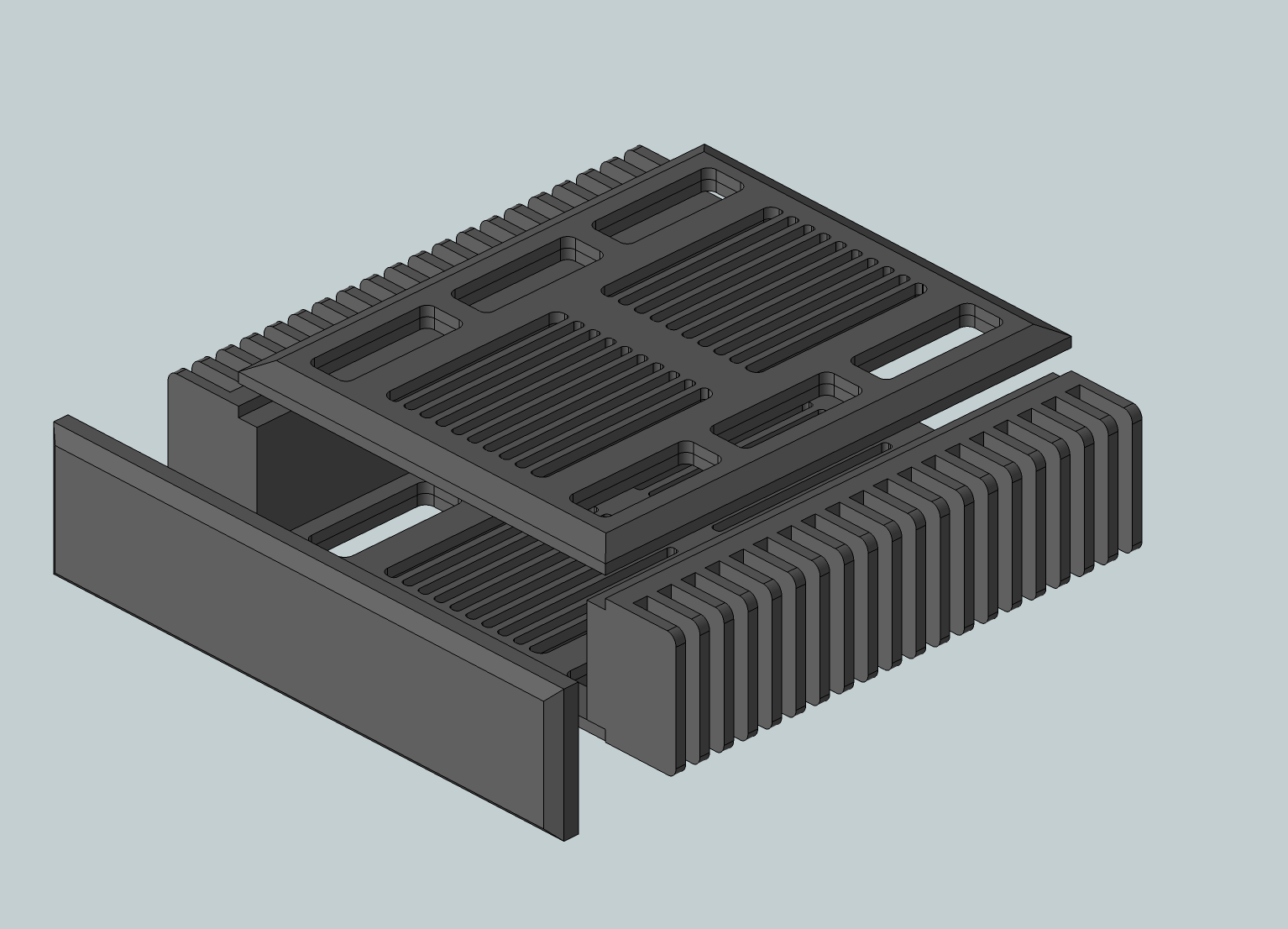

I got inspired by your design and came up with my own interpretation. I would suggest to limit the extension of the grill partern of the top and bottom plane near the corners to provide a plain area of aluminium for better thermal coupling and perhaps a bit more solid construction.
Not sure if I express myself correctly (english is not my native language).
Here is an example, what do you think?

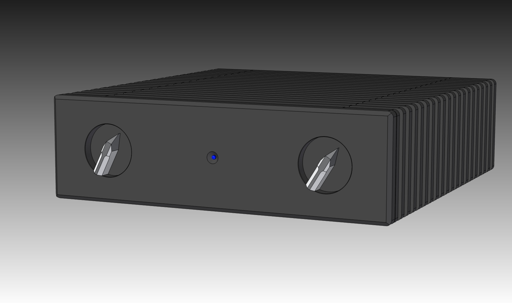

Made some slight mods to give an indication of what my crossover/control unit will look like. I have shamelessly copied NAGRA's design for the knobs.
One knob will do power & mute, the other volume. This unit will also trigger remote turn on/off for the amplifiers and possibly mute of the LME's.

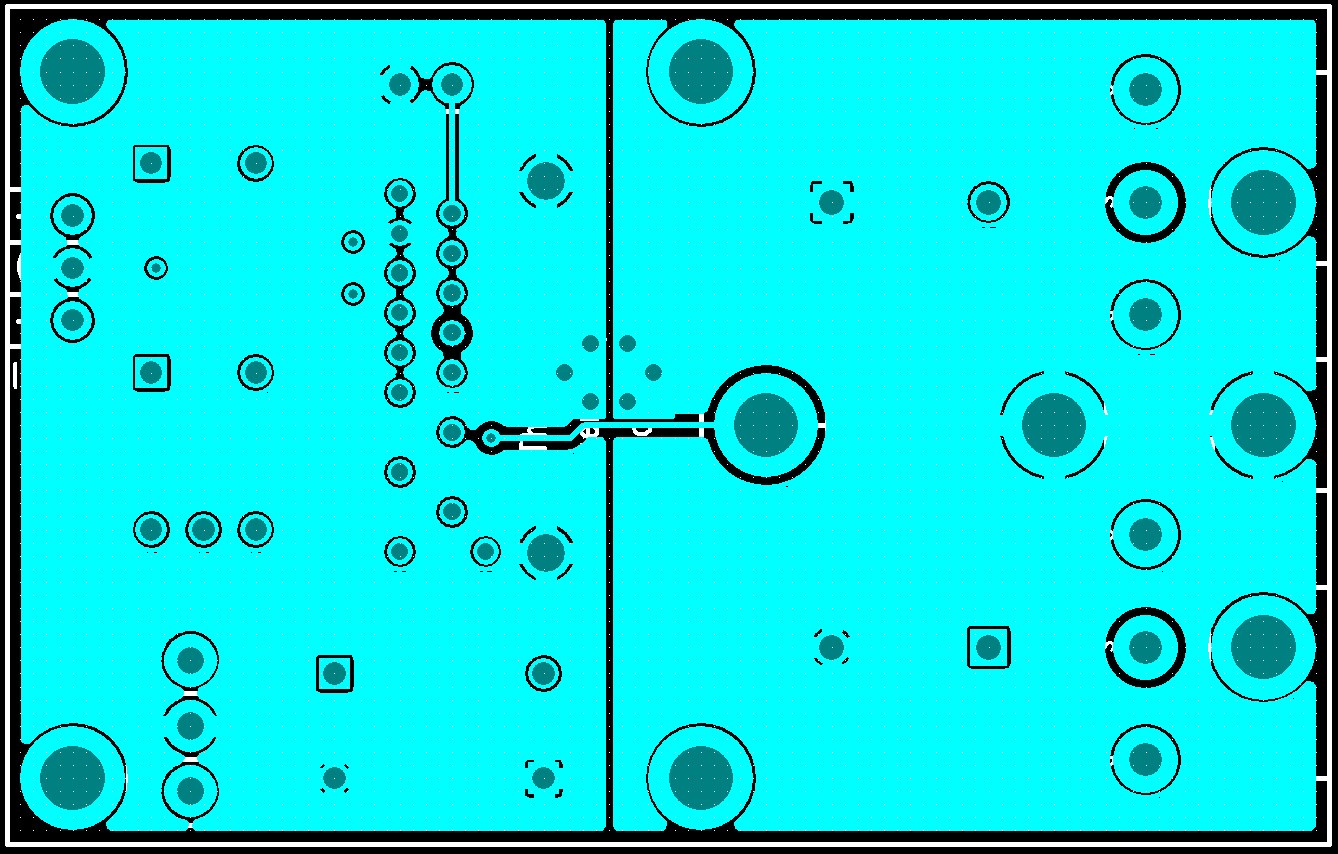

Hi Guys,
Sorry for the slow week... I've been trying to get some of the front end work out of the way with the large parts order so I can reduce the time it'll take to complete the group buy after I've finished testing the boards.
Some of the items have longer lead times when you need several hundred of them 🙂
As for the boards themselves, I won't be able to pick them up from the US until Saturday morning, but it won't be long now!

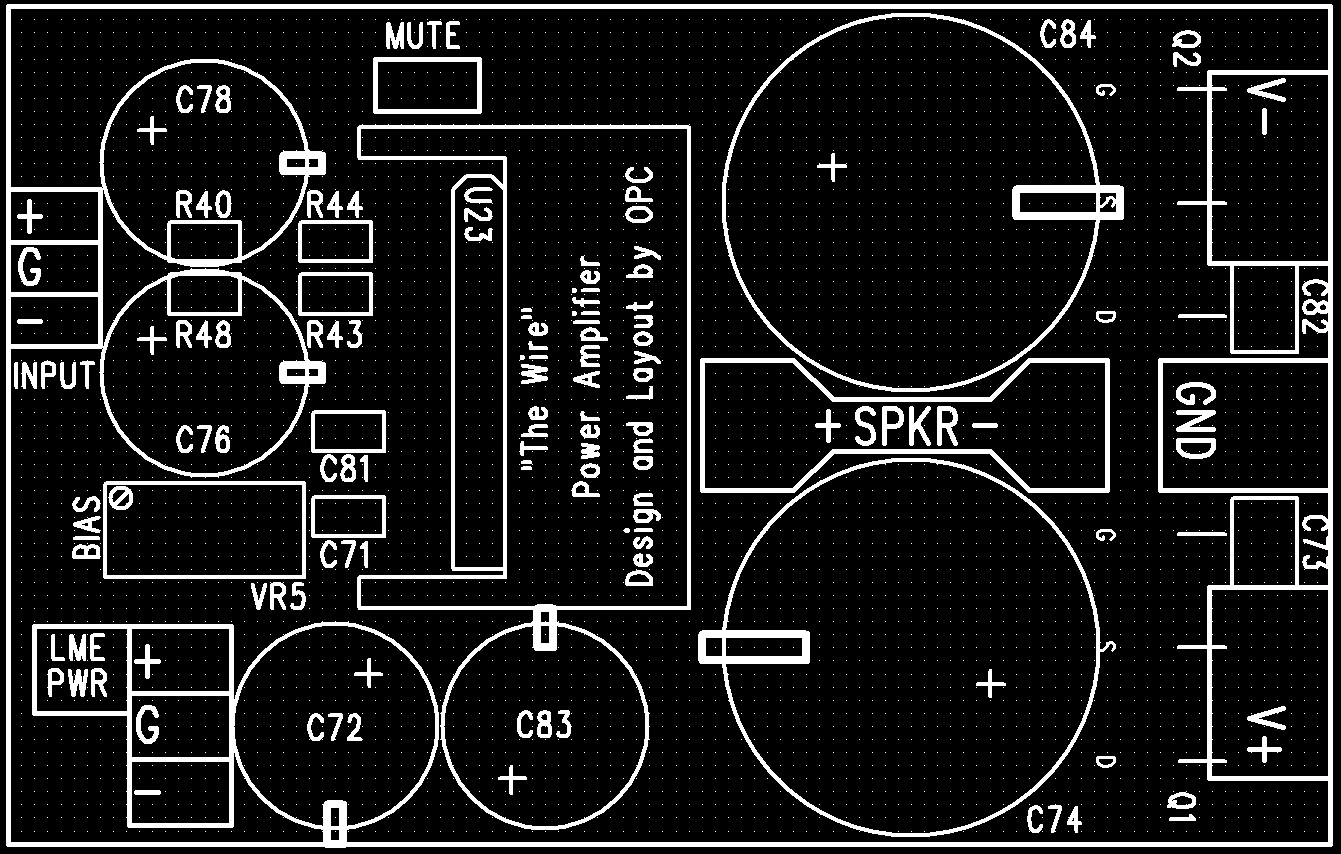

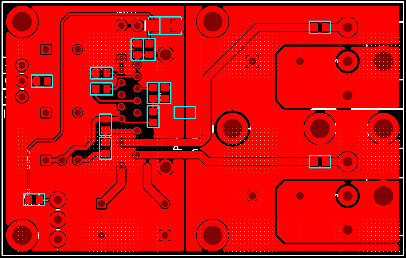

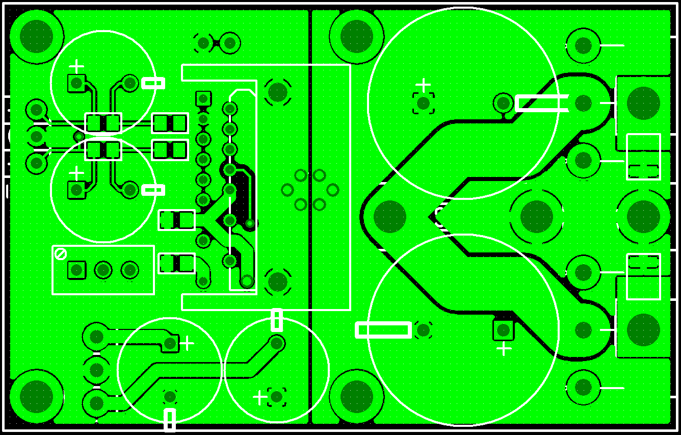

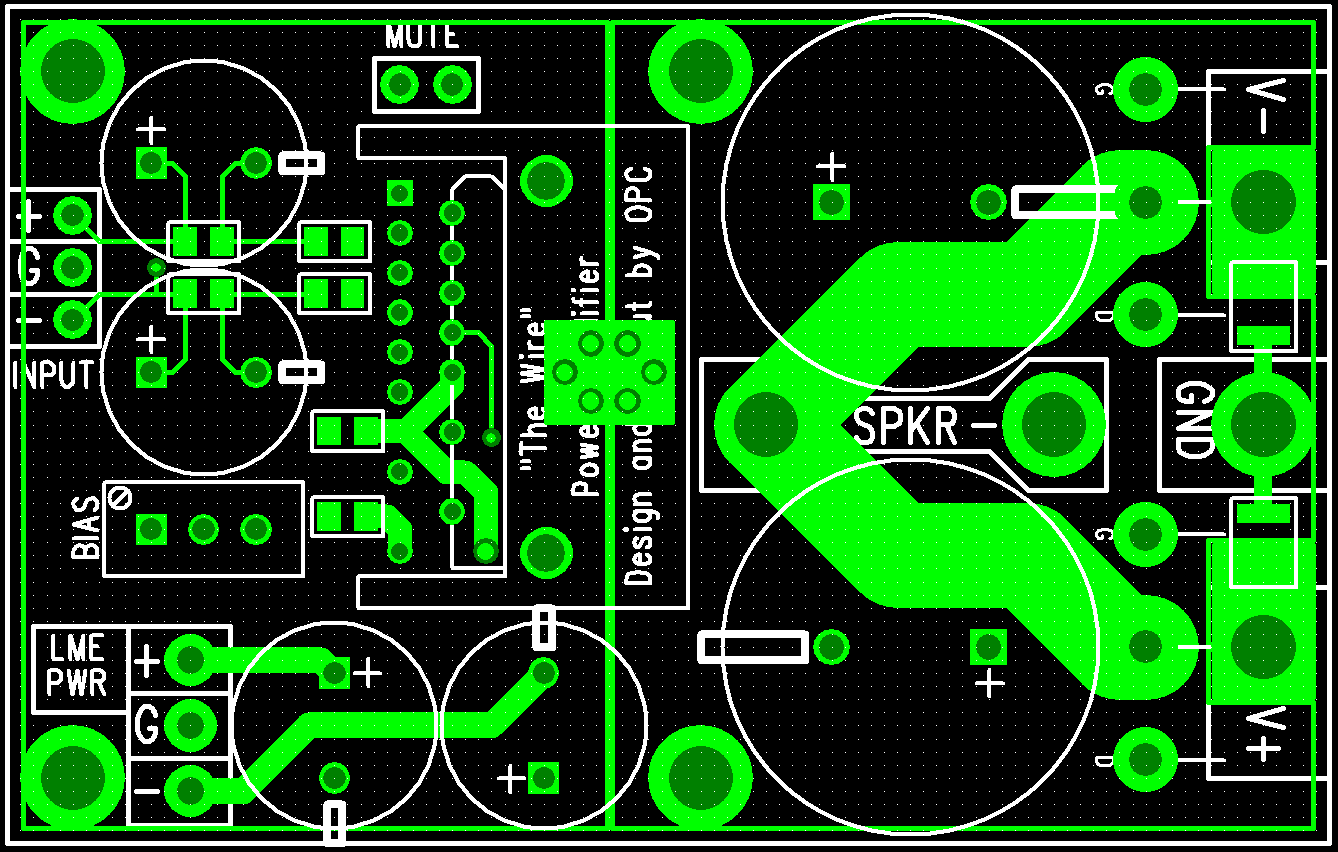

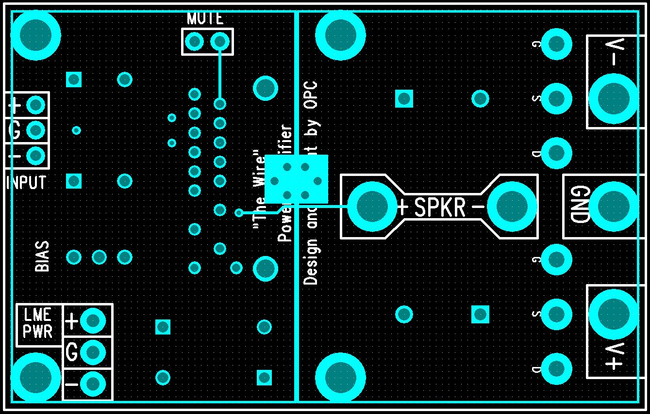

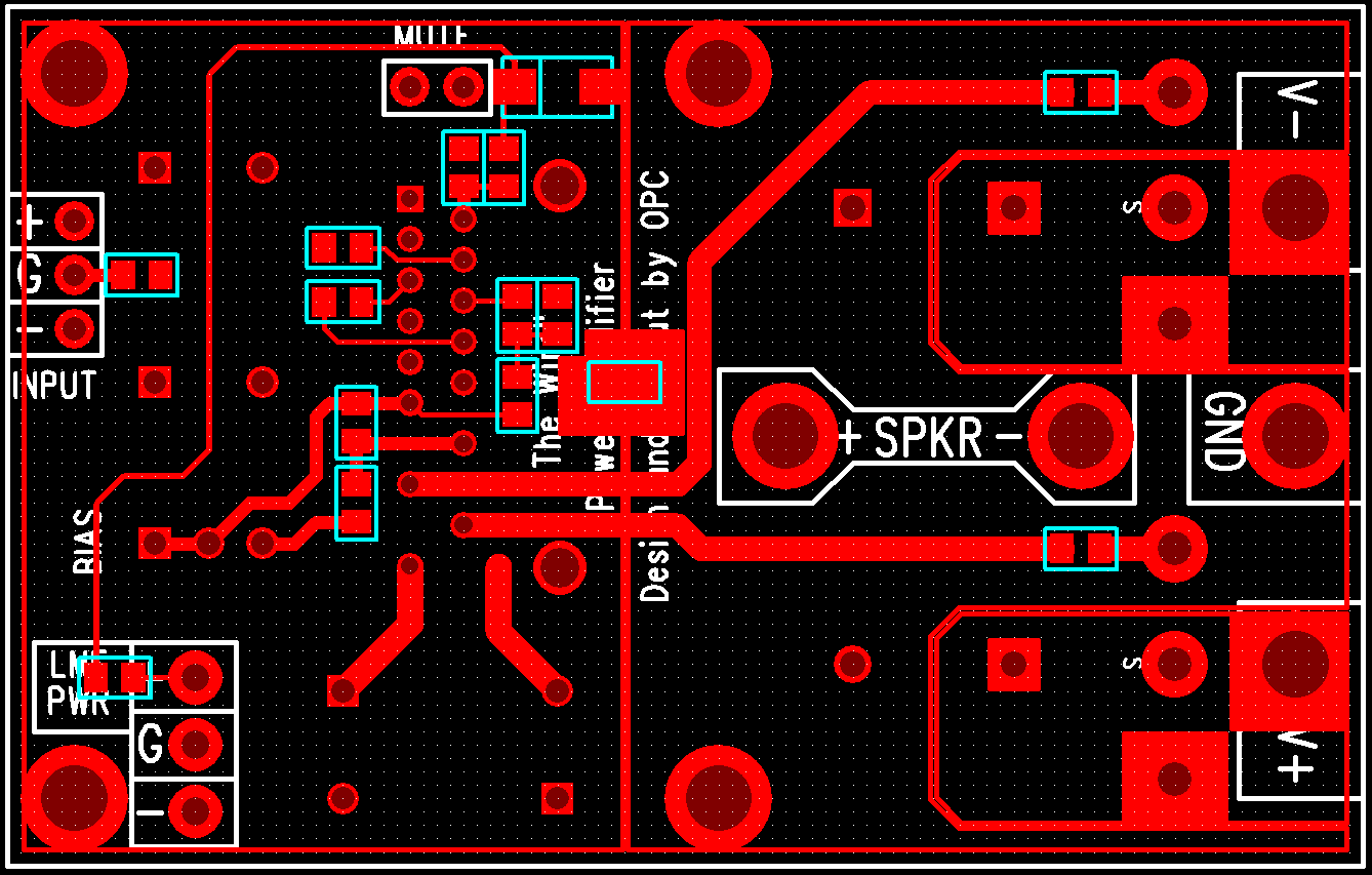

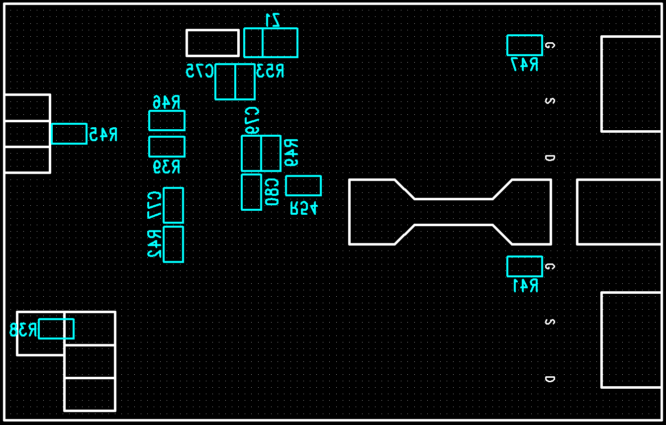

I also forgot that I posted the final layout for all the headphone amps and the PSU over in the other thread, but I never posted the final amp board in this thread. It's attached below. Final board size is 2.525" x 1.600"
It should also address this clever question from AKN:
I did indeed split the ground planes between the low level LME front end and the high power output transistors. These planes can be tied together beneath the LME with a 0R, or they can be routed separately back to the PSU and tied there. I wanted the user to have the most possible flexibility in grounding since there will be several different supplies used with this amp. I made sure that it's possible to implement all the grounding tips in the LME documentation.
I also added a better mute pin implementation that doesn't require different resistor values for every supply voltage. It's the same implementation as the reference design from National using a zener. I've also added an easy tie point for a switch for those who want access to the amplifier's mute function. Just add a switch and closed = mute while open = on.
Hopefully this addresses your concerns 🙂
Owen

Owen, earlier in this thread you mentioned a three layer PCB including a ground plane. Is this ground plane divided in more than one area like small signal ground and decoupling ground? If so I'm delighted 🙂
Owen
