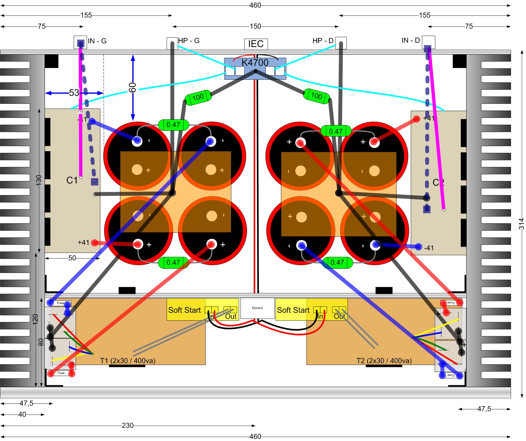

Ok, so I just want to make a dual mono integrated power amp. Everything in the same box. I've got most of the parts, including two +-50V unreg PSU. I just need your amps and the remote volume control.
http://imageshack.com/a/img41/3971/amplir.jpg
My idea, perhaps stupid, was to keep separate grounds on all the signal path. But as you say, the sources surely don't have this skill. And you are right, I've just check my IVY3 output stage of my Buffalo3se and L/R grounds are shared... Did I mention I'm a rookie ?
1) Is it still better to have two separate power supplies, even if the grounds are shared elsewhere in the signal path?
About your question, I think The Wire is the most suitable to me. I own now a Rotel RA06, which drives B&W 684, but I think I'll soon replace them by true 3-way, perhaps sealed ones with a 10" bass driver.
I just want the best amp, because I don't think I want to redo another one every 2 or 3 years...
2) I'd like to know if the Dantimax RelVol1C volume control (with 20K resistors) would fit the Wire perfectly ?
3) When will your PCB be available again?
Thanks a lot for your time, cheers.
Manu 😛

And just to prove I'm not crazy, look at the design of this guy, a "little" higher skills than me...
http://www.homecinema-fr.com/forum/ressources/image/134161
He uses 100R at the only place where grounds are commons, in the DC protection board K4700.

Hi Manu,
To answer your questions:
Absolutely. Using dual supplies will give you an improvement in channel separation as long as you implement the common ground correctly. Use good grounding techniques (covered elsewhere) and it will be a great arrangement giving exceptional crosstalk performance.
If you're planning to run SE inputs, then it will work perfectly. If you plan on running balanced inputs, then you will find that the amp's low input impedance will require a buffer between the output of the volume control and the input of the amp.
Should be back in stock in about a month. Demand outstripped supply on this particular board, so I need to order more.
Owen
