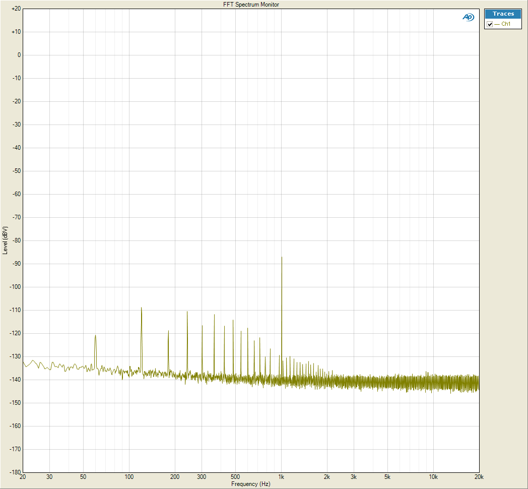

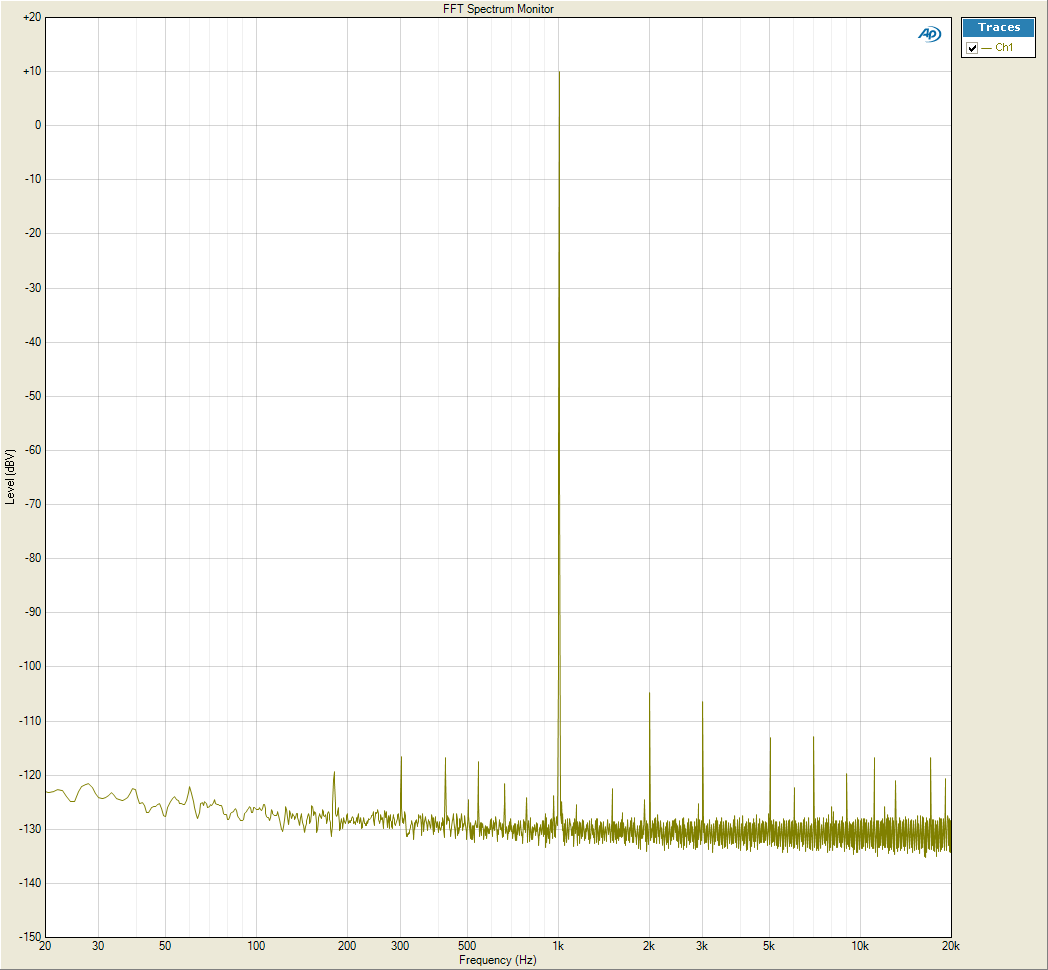

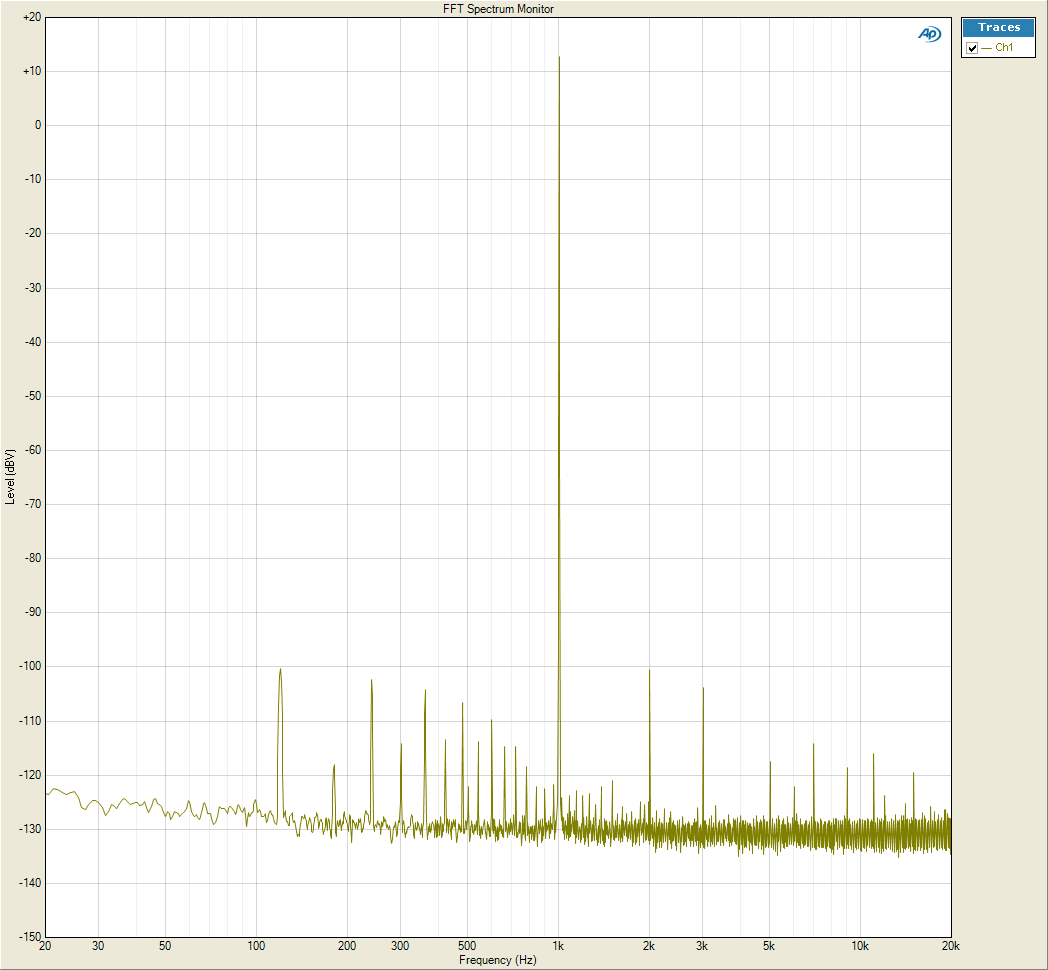

Hi Guys!
Sorry for not popping in lately, I've been working hard to get the boards finished up and sent off.
They are officially done, and I'll be generating the Gerbers over the weekend. That means the order will be placed Monday, and I will be getting a 1 week turn on the board which puts me about a week behind the original schedule. Sorry for the delay, but I really wanted to make some more measurements on the balanced input amplifier before sending off any boards.
sooo... the low input impedance on the - terminal shouldn't be a problem, and the only downside will be reduced gain if you happen to have a very high output impedance source driving the amp. CMRR is around 87dB and it remains unaffected by source impedance. Distortion is also unaffected.
I tested with both a 50 ohm source and a 1000 ohm source, and performance was identical with the exception of gain which went from about 27dB to about 18dB when the source impedance goes from 50 ohms to 1000 ohms. That means the balanced input scheme gets the green light, and anyone planning to use the amplifier in this fashion should be good to go.
I've also revised the ground scheme to give a little more flexibility without impacting performance. The end user will have a few options with 0R resistors depending of how they plan to implement supplies.
I also measured with a regulated front end, and as you would expect, most of the 60Hz + harmonics noise is drastically reduced or eliminated. Again, I strongly suggest using a separate regulated supply for the front end if you want the best possible performance. I attached an RCF 10" midrange directly to the outputs with the regulated setup (it's 103dB 1W/1m) and I couldn't hear anything with my ear right against it. That sort of performance is exceedingly rare from any power amplifier.
Measurements attached.
