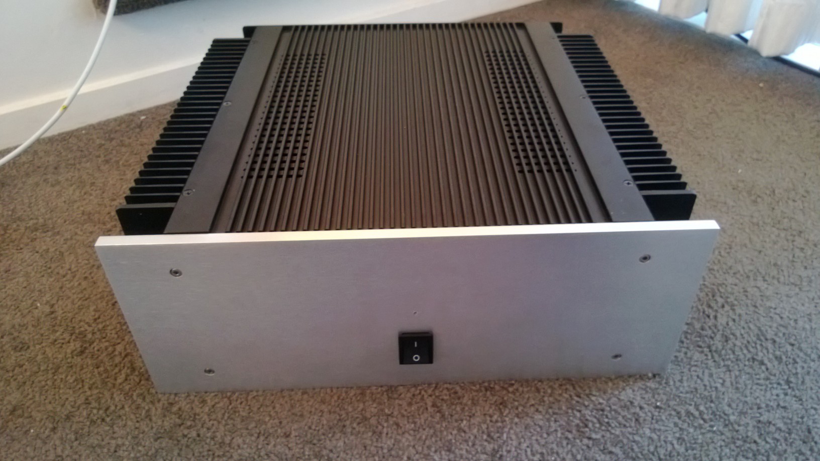

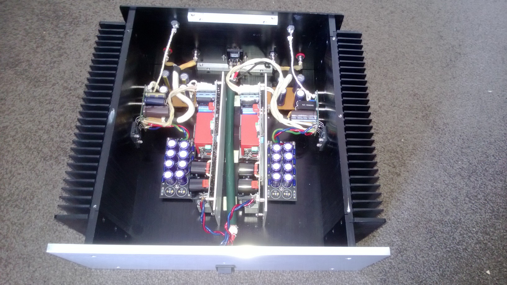

I have finally wired the modules into a dedicated chassis. Here are a couple of pic's the internal one is taken when near completion, there was still some insulation to be applied to mains connections and grounding of the switch mode supplies to safety earth.
The supplies are Audio Power DPA500 S-D, you can also see the additional capacitor board AP kindly provided me as a gift for slow delivery. As configured this provides another 4,000uf per rail of filter capacitors for the high current supplies, there is additional space for another 1,000uf per rail, but I wanted to be sure the supply was fine with a more conservative addition first.
So far I am delighted with the sound and it is virtually completely silent as long as I don't connect my sub woofer which appears to create a ground loop.
I would like to be able to bias the amps further into Class A but the DPA500 won't allow it on start up. Nevertheless the amp sounds better than when wired into my previous monoblock amp chassis. These had a 300va transformer per channel for high current and a 60va transformer per channel for the driver stage supplies. These supplies had a dual secondaries per transformer, electrostatic sheilds and Jensen 4 pole capacitors.
Rob.

Rob, is that a grounding wire or a garden hose?I have finally wired the modules into a dedicated chassis. Here are a couple of pic's the internal one is taken when near completion, there was still some insulation to be applied to mains connections and grounding of the switch mode supplies to safety earth.
Rob.
It is the mains wire direct to the front panel mains switch🙂 The actual individual conductors are 11 ga so much of the overall diameter is cotton fill, but yes the overall diameter is substantial. I have run ground wires from the aluminium panels on which the supplies are mounted to the safety ground on the iec socket (not done at the time the pic was taken).
Regarding the remote control, I am l am leaving that for later🙂 The WIRE board has 1000uf local capacitance which is why I didn't fully populate the capacitor board.Hello, sometimes it seems that something is moving on this thread..
@ Robert-F: I see cables delicious in the assembly, as well the vertical mounting of the two DPS-500.
From the picture I see you have the "S" version, this includes the remote control, you have not used? works well and is easy with 2-Pin, just "open / close".
The connector (CN4) is located near the vertical module.
As the DPS-600, this remote control in accordance with EEC regulations, has a very small absorption and can keep the stby for a long time.
maybe you can replace the switch on the front, with a circular 23mm diameter with double switches (one for each remote control).
For additional filtering capabilities, 5000uF per side is the maximum stated on the datasheet, I think you'll have a timbre very dry, especially on percussion hehe!
regards

Nice job. 🙂I have finally wired the modules into a dedicated chassis.
sounds better than when wired into my previous monoblock amp chassis...300va...60va transformer per channel
How much capacitance did you have after those previous transformers?
How much output device quiescent current have you been able to achieve with the SMPS?
What was the delivered price of the pair of SMPS? I don't recall seeing that anywhere so far. I think in the UK I'd pay no VAT. I might want to try a pair at some point in the future.I'd be curious to know what happened to everyone else with the DPS-600 GB
Nice job. 🙂

Hi IanAS,
I ran them at 360ma with the old supply. I couldn't get the power supplies to start up at that idle current and so reduced it to about 280 ma or so. I must see if I can implement switchable higher bias but the last thing I feel like doing right now is pulling the amp to bits again!
I was running 15,000uf per rail on the old high current supplies.
