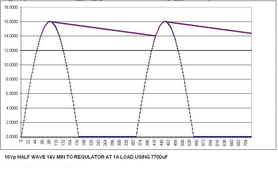

i'll let some one else do it for me.Care to explain my error?
Unregulated Power Supply Design
the center tapped transformer example i discussed above is shown in fig 3. look at fig 8 for your 1/2 wave rect example.
I've already studied that information. I still do not see my error.
You assumed that I missed the fact that "peak" voltage is what matters, not RMS. I already know that, which is why I use the 1.414 multiplier in my calculations.
If full-wave rectification of 30VAC results in 42VDC output, then half-wave rectification will result in 21VDC. It is that simple, and the calculation is based on peak-to-peak, not RMS.
IMHO your error is in your understanding of "half wave rectification"
But this should be discussed on another thread.
Apologies ,GM
I agree that it is off-topic, and I will study this closer now. I do realize that I misunderstood it. I guess I shouldn't rely too heavily on randomly googled info. Apologies to rsavas for being stubborn.
Yes. If it is centre-tapped 30v, then Gary's solution works perfectly.
Gary's solution isn't paralleled, is half wave as it is using the outer taps. Parallel would be both orange to one side ~, yellow to the other ~.
cool how about stubbornly confused !🙂Apologies to rsavas for being stubborn.
wow more confusion.Gary's solution isn't paralleled, is half wave as it is using the outer taps.
so it would technically be called a "full-wave,half bridge rectifier, using a center tapped transformer"Technically you only need two diodes to make a half bridge rectifier,
That would short the transformer output. Doable if the transformer had two separate 15V windings (just parallel 'em) but with a single center tapped 30V winding, the two orange leads are out of phase.Gary's solution isn't paralleled, is half wave as it is using the outer taps. Parallel would be both orange to one side ~, yellow to the other ~.
True story, please forget everything I said. 🙂
