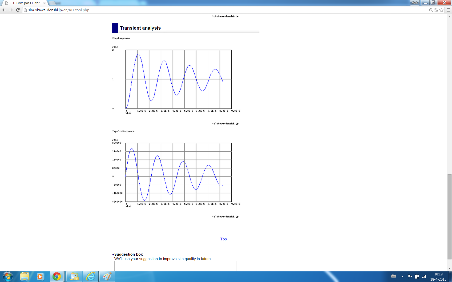

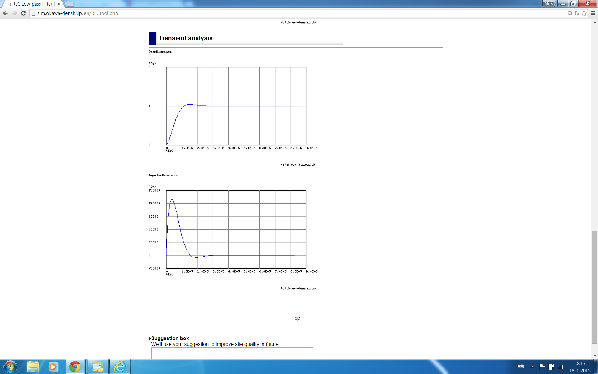

Just LC parts outputfilter combined with higher speakerload than designed for cause transient ringing too I would think
The output LC on the 4 ohm wiener is 10uH/1.5uF, which has a 41KHz resonant frequency. Unless your speakers look like a 2uF or bigger capacitor (I seriously doubt it) and effectively lower the corner frequency of the LC, it's not ringing you hear.Hi,

You might be hearing HF peaking, caused by your speakers being >4 ohms at high frequencies - what are you using for speakers?
Oh, I don't disagree that the output LC rings with a larger value of R. But the frequency of the ringing is going to be the LC natural frequency, which is >40KHz and inaudible.
Potentially HF content at >20KHz could intermodulate with that 41KHz ring and create new content below 20KHz, but the LC filter on the wiener is pretty close to ideal (negligible L droop vs current, no C change vs voltage) so that effect should be insignificant.

Even if filterfrequency is 100khz you hear a difference, even when simulated/theoretically there is no rise in frequency respons below 20khz. So I thought the Q affected audioband too, maybe not, maybe it is just something folowing from the higherfrequency ringing. Damn, more reading 🙂
How?Even if filterfrequency is 100khz you hear a difference
If filters ringing at superaudible frequencies bother you, you really don't want to look at the step response of your average digital interpolation filter...
It wouldn't bother me if there wasn't a audible part.
If TI states 33uH inductors have less harmonic distortion than 10uH, and dampening is just at inaudible frequencies, why would they select 10uH here?

I thought I heared a difference between under and overdamped filters, but can't be according to gmarsh unless frequencyrespons is affected. So I must hear another part of load interaction maybe???

Frequency response is affected by the speaker impedance, as it determines the damping factor of the output filter. Too high a speaker Z = underdamped = peaking, too low a speaker Z = overdamped = early roll off.
How much depends on the output filter values selected. Download a copy of Octave and play around with the MATLAB code I posted here, it'll plot the frequency response.
