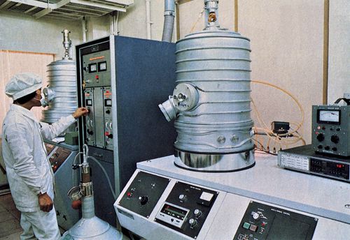

You are totally wrong in stating that a Yamaha beryllium dome-clone could be made for a few dollars.
At the time Yamaha built their own equipment to manufacture these domes. Google a bit and you will find a picture of equipment that will not fit in your garage. The beryllium was vaporized and vacuum deposited. A very dangerous procedure because vaporized beryllium is very poisonous (beryllose kills much faster than asbestose, and the technique is forbidden in most western countries).
Up to this day these transducers are state-of-the-art.
It is no coincidence that JM Labs/Focal and now Usher try to pick their grain of beryllium.
In my opinion and experience much innovation in audio is done in Japan in the seventies and eighties, and quality was at a very high level. Not only loudspeakers, also electronics. Think of Sony and Yamaha with their VFet amplifiers; Nakamichi made cassette a listenable medium; Luxman; Accuphase. Each of the major Japanese brands had their flagship models at the time. Many of these did not make it into western markets.
I totally agree with you that audio in general took the wrong direction. Yamaha now is not Yamaha thirty years ago and the same is true for many more brands. Like you I am professionally active in the DIY market so I know what you mean.
Comparing beryllium and non-beryllium drivers attached to horns or waveguides does not tell much about differences in transducers, agree, because much of the sound will be blurred by horn colorations.
Comparing a direct radiating Yamaha midrange dome to some other direct radiating midrange dome or cone tells a lot more but I guess that only NS1000 owners understand what I mean.

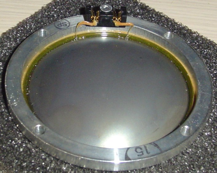

If Scanspeak uses a so called pure Beryllium diaphragm in ther driver shown below, I certainly can't see much change in breakup frequency location, let alone damping.gedlee said:Not to steal Steve's response (he can still respond) but the idea is a simple one.
Breakup is bad. Basically once a diaphrgam begins to break up it will start to color the sound - it can no longer be flat and smooth. This is very tru I think, but is most true in the frequency range of say 800 Hz - 8 kHz. Above about 8 kHz it seems to me to be a highly suspect argument.
I would never use a driver in the 800 - 8 k range if it had cone breakup there. Thats what crossovers are for.
The higher the speed of sound in the material the higher the breakup region will begin. But damping is more important than the frequency location. A well damped breakup will be much less audible than a underdamped one, even when a crossover is used. So a material with a high internal damping is best because add on damping lowers the breakup frequencies due to added mass. Paper and some plastics excell here.
http://www.scan-speak.dk/datasheet/pdf/d3004_664000.pdf
