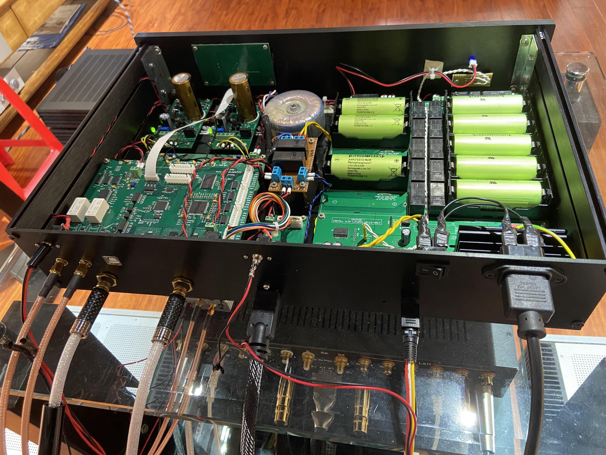

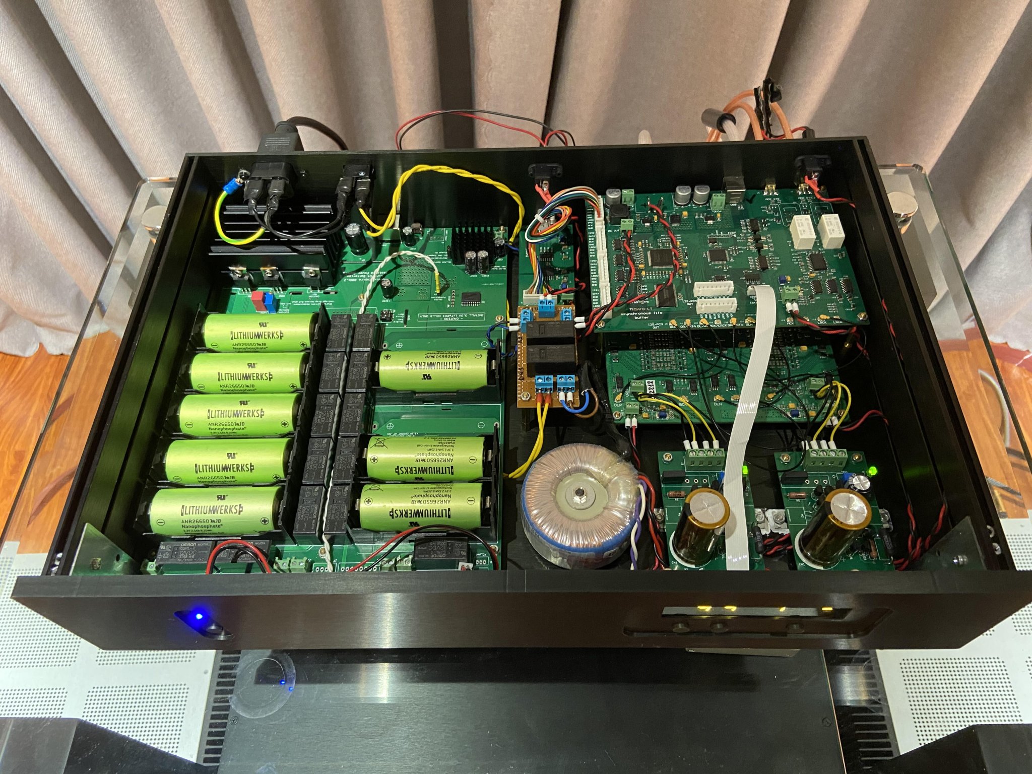

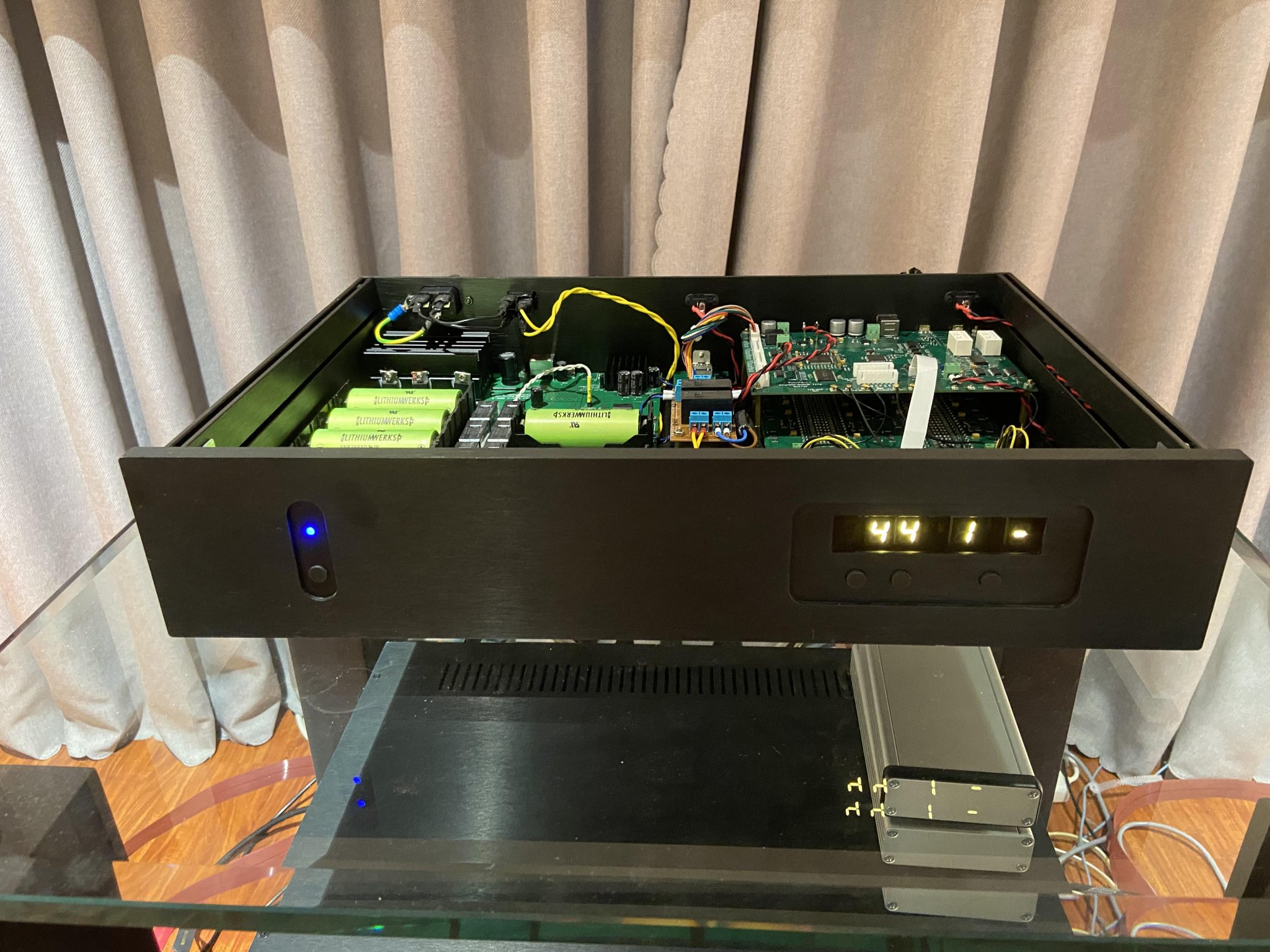

Even if very happy with my latest PCM1794 DAC with SEN I/V from Patrick I was intrigued by the design of Andrea Clocks, FIFO and LT DAC.
Was a long journey with many logistic problem (I live in Vietnam and it's very hard to import anything) plus some technical issue that Andrea kindly help my to solve.

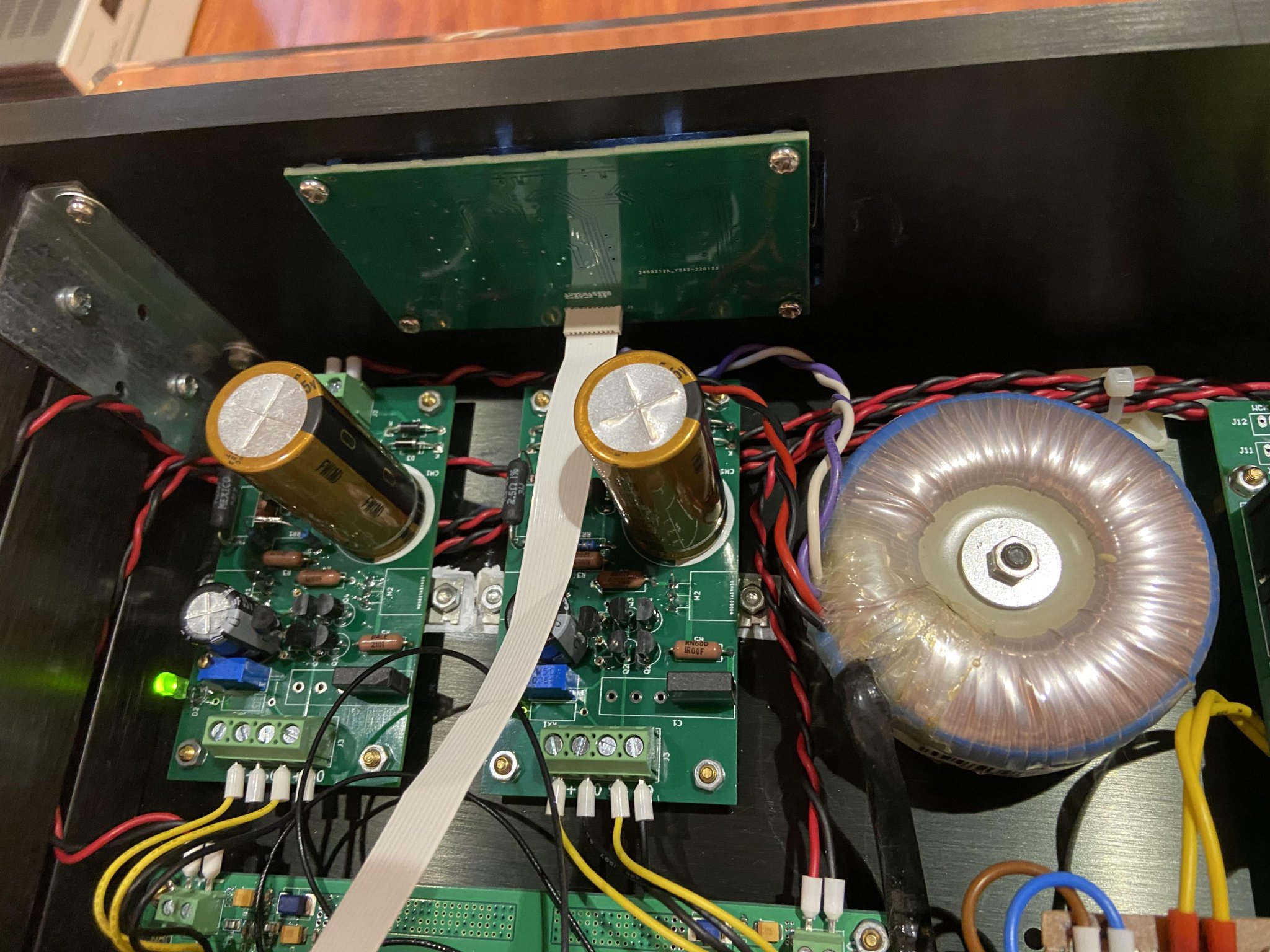

I attached few pictures, practically the whole DAC is based on the Andrea boards including the PSU with the exception of the 4V for the LT analog side that are the Salas Reflektor that I was obliged to redesign to fit in the chassis.
The clocks are the Driscoll 5,6 and 6.2Khz

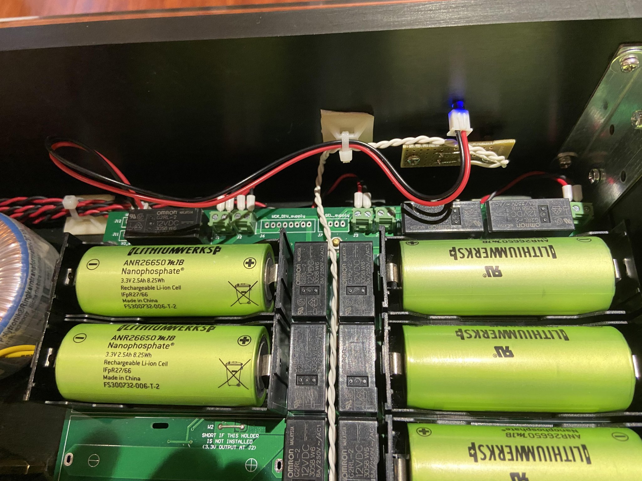

I added a small board with 2 relays, moved by the 5V available in the battery board. One relay switch the 220V for the Reflector, the other one switch the FIFO supply from the PSU.
Regarding the sound... at the first listening I was impressed by the 3D presentation and the quality of the mid-high section but I also noticed the lack of low "punch" compared with the other PCM1794 DAC. I discussed this with Andrea and he suggest to give some time of burn-in. I have to say that he was right, just after few days the low level show up. Today, after almost one month that I play the DAC almost 3/4 hours every night the DAC is playing really well, the mid-high are impressive, the low are all there without being invasive, not to mention the 3D and the definition in the space of all the instruments.

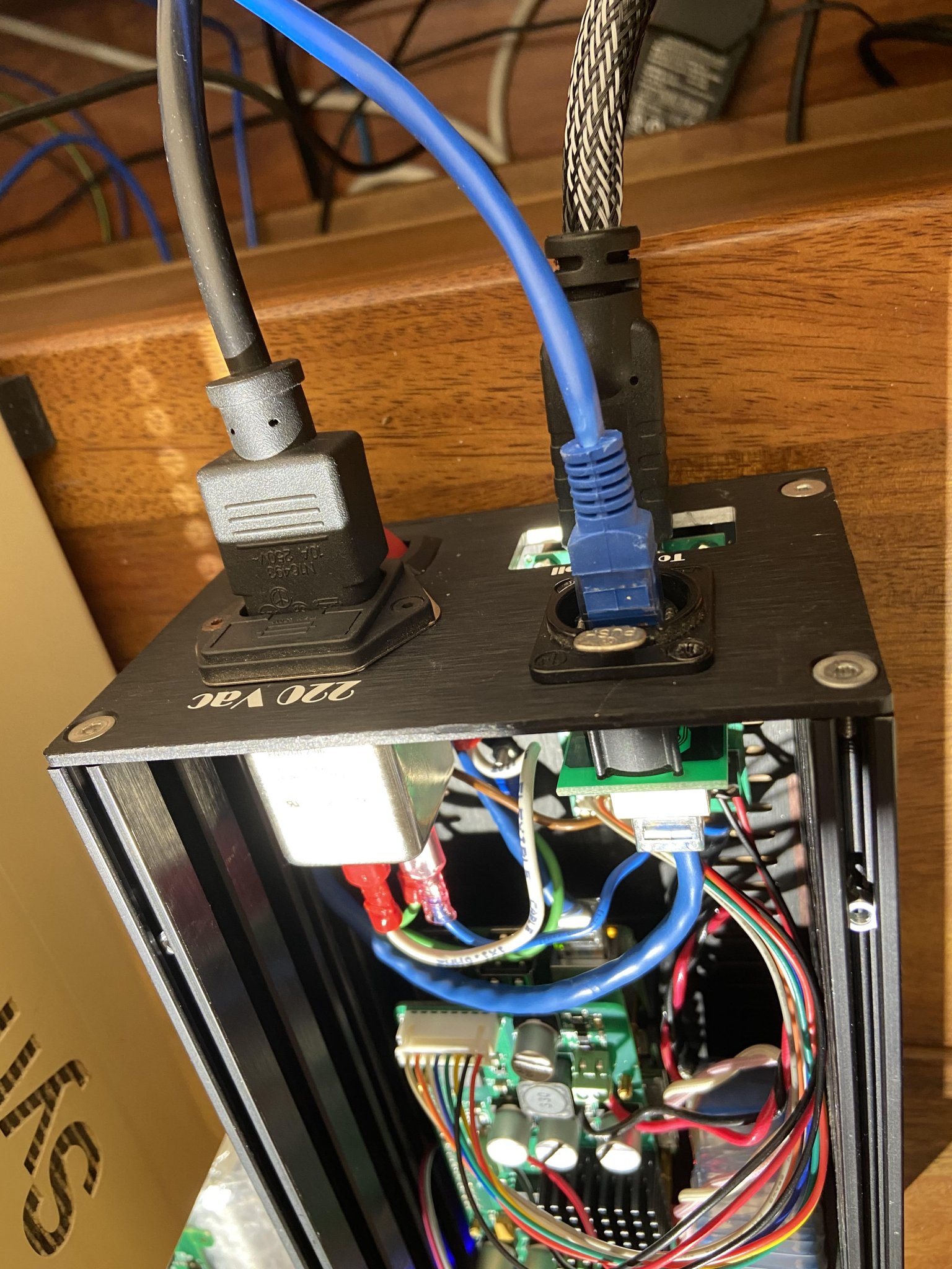

Almost forgot to mention, the input is from the RPI that was laying around from some experiment that I did some years ago and abandoned. I give a try to the Andrea RPI interface with the TX-RX modules to connect the RPI through HDMI cable. I am surprised how well is playing, also thinking all the trouble that I get years ago with the RPI and Volumio.
Thanks Andrea for the incredible design you did!

Enrico, I have made the same jump as you, from heavily tweaked DDDAC to Andrea's gig.
I have quite a comparable setup, standalone Rpi with HDMI transmitter, FIFO with Driscoll clocks, ultracap for DAC analogic Vref.
I have to admit that this setup sounds better in almost every aspect than my beloved DDDAC.

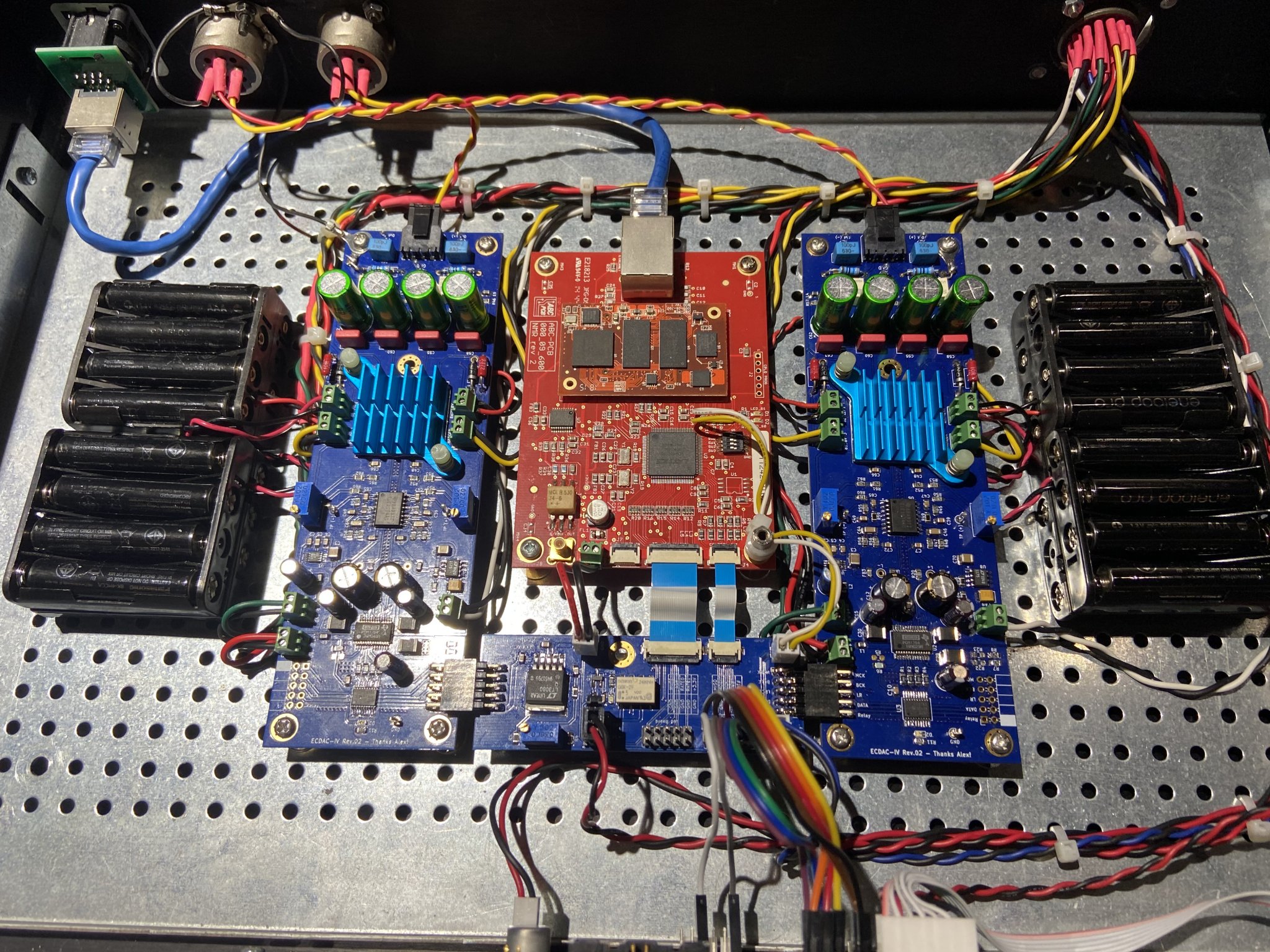

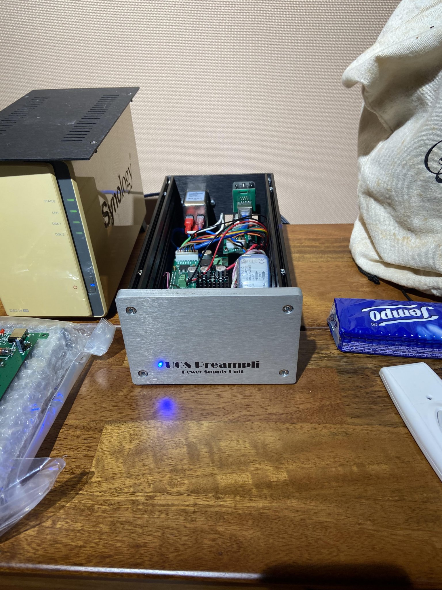

which Andrea DAC ? What is LT, please ? What is the one of the picture ? Pretty red digital front end btw !
For LT I mean the TWSDAC-LT - The Well Segmented DAC Lite.
The one in the picture is the DAC that I designed based on PCM1794 with the SEN I/V.
The red board is the EDEL-NMR, the Network Audio Media Rendere from Engineered. I attacched here the datasheet
