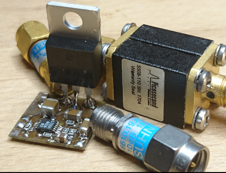

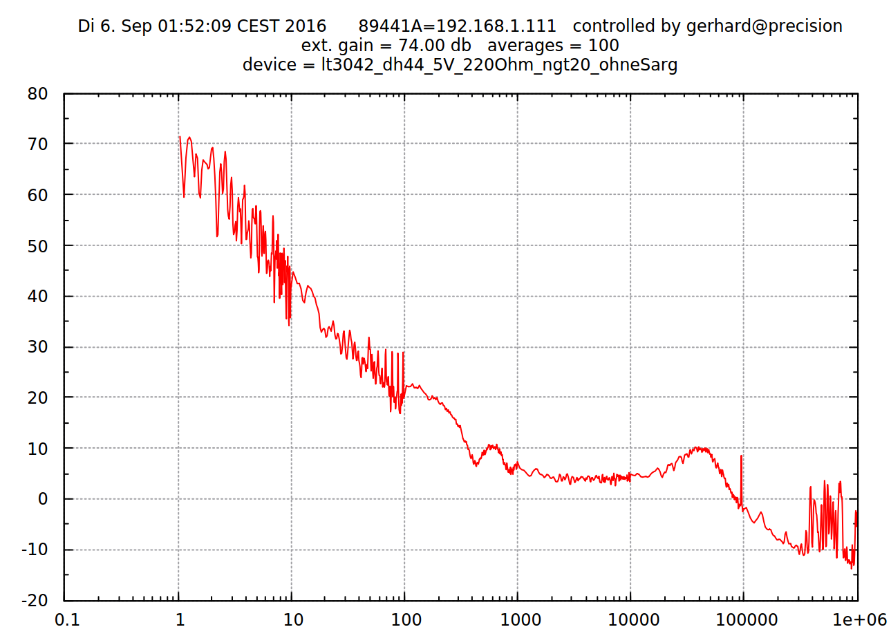

There is no need to bolt the regulator to the engine of a helicopter.
This board was done from A-Z on a rainy Sunday. Circuit is directly
from the data sheet, measurement is limited by the preamp below 100 Hz.
Completely unshielded, open on the lab table, next to the computer screen,
under the switched LED microscope ring light and in the front of a 2*4
square meter array of 19" scopes, generators, spectrum analyzers etc,
each with a switching power supply of their own.
Fed by a R&S NGT20 via 1.5m banana cable.
X7R ceramic capacitors and still 2 nV/rtHz noise density, just as promised.
0 dB line is 1 nV/rt Hz, 6 dB more is 2 nV.
