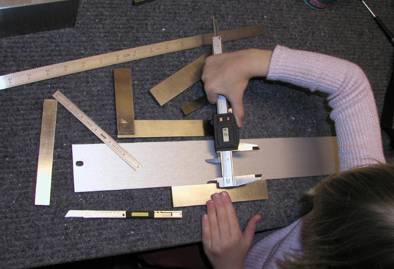

Peter,
Could you tell us a little about how you do the layout on the metal before cutting?
I’ve read your other thread on tools and such and it’s been very helpful. This might seem too obvious, but how do you make the cut lines, pencil? That’s easy to clean off but tough to see and easy to smudge while working.
I’ve taped paper on the panel for layout, or even directly attached a laser printed design, bit this always seems to tear and slip. Contact paper works a little better, buy catches fillings and helps scratch in spite of it self.

Those are about all the tools you'll ever need to do proper layout. I use a ruler and calipers and the lines are marked with that small knife, directly on pieces I'm working on. I found a pencil or a marker not accurate enough. When using calipers a metal slab is useful, because you can draw a perfect line with a caliper directly. Those stainles slabs of different sizes are really helpful when working on layout and doing anything else with metal. I'm not using any mitre boxes or guides, just a steady hand and sharp eye.😉

Ive got two micrometer calipers, The elder is a Fowler with a venire scale that was making me blind fast. The second has an LCD scale I just bought from Harbor Freight for $20. Seems reasonably accurate and not to shabby for a throw away price. It also kept me from having to explain the cost of a Starret to my wife. I gave one to my Dad, a recently retired machinist, for his birthday and he seems to like it, at least that’s what he tells me. Is that a Mitutoyo in the picture?

I think it is Mitutoyo, although it doesn't say the name on it. Digital calipers is the must, when working frequently with metals.

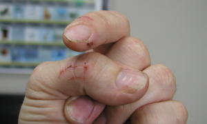

When I drill the holes I never clamp the piece, but hold it lightly, so it always centers properly.
Uhhh, better be careful, there
Real easy to lose fingers or even more important parts of your anatomy
if the part you are workin' on slips
Be careful

You are right about it and this is how my left hand fingers look now after I drilled all the holes in some acrylic blocks I used for feet in my Aleph amps.
It is true that one has to be carefull, especially with small parts made of steel and plastics when drilling. In this case I also recommend a vise or clamps. Yet with large aluminum panels and mostly anything aluminum, there is not much danger of the piece being spun by the drill. Use lubricant when drilling deep and use caution, sooner or later you'll get the feel and it's easy to predict when it becomes dangerous.
And I've been to hospital on more than one occasion as well.😉
