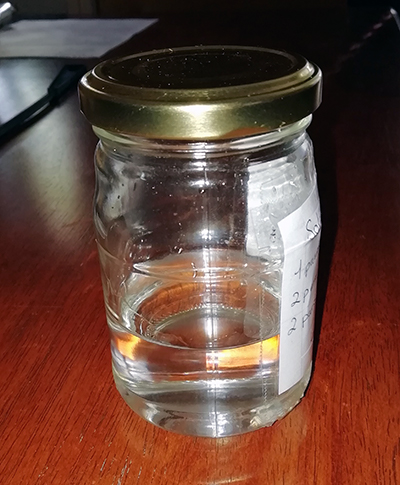

A few day's ago I returned to investigate how to make my own RMA - Rosin Mildly Activated - found some nice pine harts (rosin or kolofonium) and was looking for an acid. At that point I stumbled upon citric acid which some use when making their own RMA flux and everything was good. But it got me thinking. The reason we use flux is mostly two folded: 1. chemically clean the PCB traces. 2. Better wetting / flow of the solder.
So did some further research / reading and found that one can make a flux which use other carriers / wetting agents than kolofonium and that is what its all about.
Vehicle: It turns out that Glycerol is an excellent vehicle.- Glycerol also called glycerine or glycerin: is a simple polyol compound. It is a colorless, odorless, viscous liquid that is sweet-tasting and non-toxic. The glycerol backbone is found in many lipids which are known as glycerides. It is widely used in the food industry as a sweetener and humectant in pharmaceutical formulations. Glycerol has three hydroxyl groups that are responsible for its solubility in water and its hygroscopic nature.
Activator: Citric acid. Citric acid is a weak organic acid that has the chemical formula C6H8O7. It occurs naturally in citrus fruits. In biochemistry, it is an intermediate in the citric acid cycle, which occurs in the metabolism of all aerobic organisms and least but not last, its an excellent oxidizer and used in many natural cleaning products.
Solvent: This one is plain old water or H2O. This is the primary solvent for the citric acid. I used deionized.
The formula is fairly straight forward:
2 parts Glycerol. (300ml = ca $6)
2 parts Citric Acid (crystals) (100g = ca $1)
1 part Water. (Free or cheap)
1. Mix the glycerol and water to a homogeneous mixture. 2. Heat the liquid but don't boil, this will make step 3 go faster since heat act as a catalyst. 3 Add the citric acid and stir / mix until dissolved. That's it, you are now done.
Findings.
So I sat down with an empty experiment board to try out this flux. Using Sn60/Pb38/Cu2 solder. The reference flux was Weller Lötwasser (WS flux). The reference flux behave as a flux should, produce normal amount of smoke and has a "normal" smell during use. Cost $7.54 for 25 ml so not cheap.
The Citric Acid Flux (or CAF) has a nice viscosity, similar to warm maple syrup. Virtually odorless and is clear. I spread it using a cotton swab, it stays put thanks to the glycerin. Was using the KSGER V2.1S T12 Digital Temperature Controller Soldering Station which has a fast temperature ramping and recovery and the reason I am mentioning the recovery is that as the water in the CAF is brought to a boiling point, it will take with it some of the heat. The boiling water is what I would say the main difference between the CAF and Weller Lötwasser. Other than this, it is on par with WS or RME with the difference of being super easy to clean with either water or Isopropanol or a 50/50 blend. What a noticed after cleaning the board was that the CAF side did not have any dimples (due to shrinkage) in the solder while the Lötwasser side had. This could be due to the difference in how it cools or solidifies since the CAF has the water that is removing some of the heat, and hence transition from liquid to solid has a different profile compared to Lötwasser.
Cleaning the board from both fluxes was a very simple job, no residue to talk about and compared to RMA flux, a dream to work with.

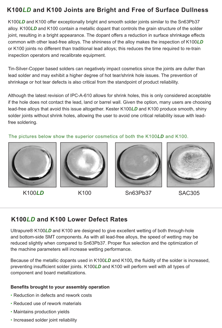

Kester K100LD
The Only Lead-Free Alloy that Diminishes the 5 D’s
1. Lowest Dissolution of Copper Prevents Copper Erosion, Reduces Pot Maintenance and Increases Reliability
2. Low Dullness. Produces Shiny, Smooth Solder Joints
3. Low Defects. Bridge-Free with Excellent Top-Side Fillets
4. Low Dross. Anti-Drossing Additive Results in 20% Less Dross than Untreated Sn63Pb37
5. Low Dollars. Silver-Free Alloy is Approximately 50% Lower Cost than SAC305
- K100LD is a new patent-pending lead-free solder alloy that can be used in wave soldering, selective soldering systems and dip tinning operations. K100LD has the Lowest Dissolution of Copper amongst all common solder alloys, including Sn63, SAC305, and other lead-free options.
- K100LD has been designed to give users optimal performance with minimal defects and maintenance costs. By preventing the Copper level from increasing in the solder pot, the alloy remains eutectic and the solder performs consistently over time. Other lead-free alloys dissolve Copper much more quickly, causing the alloy to become sluggish and create additional defects, such as poor hole-fill.
- The low rate of Copper dissolution makes K100LD an ideal product for applications such as fountain rework, where contact times are longer and other lead-free alloys completely erode Copper terminals.

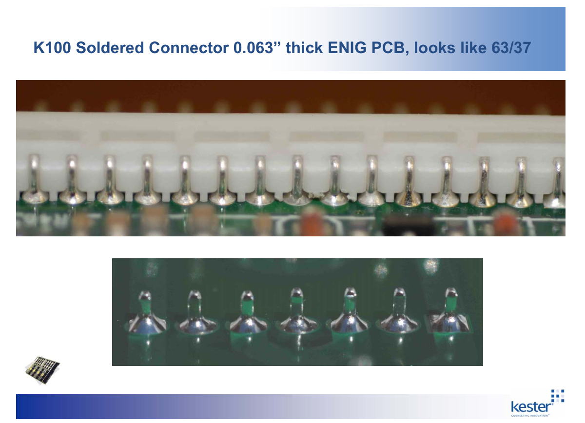

I have attached several documents covering basic info and evaluation of Kester K100LD as well as tracked down the K100LD solders in the available 275, 311 and 48 series which use different fluxes. The series contains SOC305 solder as well, so make sure to match what you are looking for compared to which are the K100LD versions.
One info sheets was to large to attach as a file, so please use the provided links for download.
1. www.amtest.bg/products/Kester/Flux/K100LD_brochure.pdf
Depending on where you live in the world, it can be easy or difficult to get hold of K100LD, Mouser sell them among others, look for distributors on Kester's homepage. One version that is frequently available is the 275 series 0,037" / 0.8mm - 1lb spool which has has part number 2495747618, but you can find other sizes in the Info and Parts Number.pdf I have attached.
