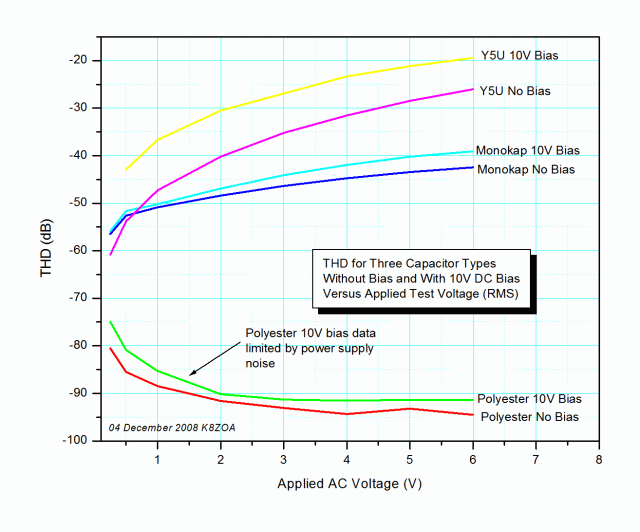

It is well known that capacitor distortion is minimised by minmising the signal voltage across the capacitor. Therefore, enormous capacitors are actually better. Even the worst capacitor dielectric will introduce unmeasurable distortion in the audio band if it is enormous enough...

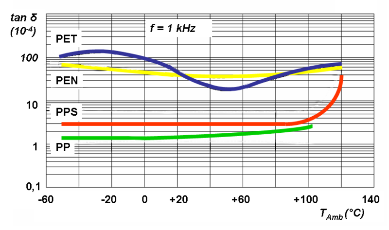

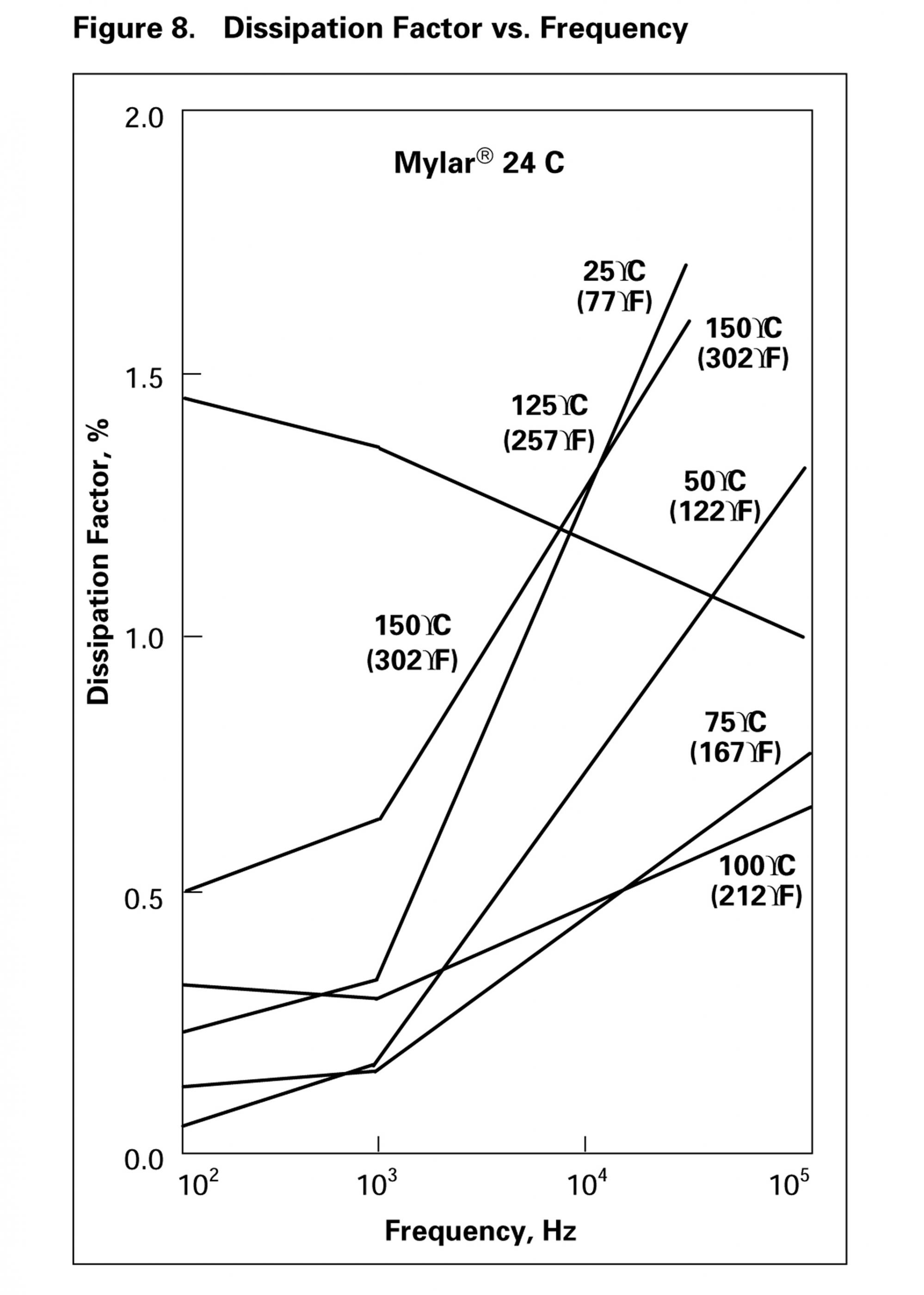

Sorry, but this is wrong, surprisingly, capacitor linearity only depends on dielectric properties, capacitor geometry and frequency.
b/a ≈ [ε(ω)tan (δ)] / ω
Or even worse
b/a ≈ ε(ω)ESR C
Capacitor linearity decreases with capacitance, and has nothing to do with applied voltage, however we must be cautious to not exceed manufacturer specs, but some dielectrics have a favorable behavior with a slightly increased on temperature.
attachment.php
attachment.php
Things like this are strange, but possible.
attachment.php
Seems that polyester capacitors doesn't know too well that capacitor distortion is minimized by minimizing the signal voltage across them.
Of course, if you minimizes the signal voltage applied across the capacitor, you are minimizing the applied field E, then the dielectric hysteresis loop D=f(E) will be thin, the area inside it will be small too, and the device results quite linear.
I was wrong too!
Electric field E also depends on capacitor geometry, real world capacitors are complex beasts and it is very easy to believe on an audio myth, but a more deep analysis can clarify a little this matter.

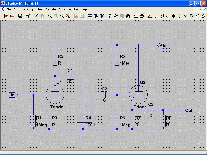

Achilles heel of my original proposal of post#1 is that it needs more capacitors
attachment.php
Even worse, roughly
C1 ≈ 10 C2
Not to mention C3, so, we must be very careful with capacitor selection. 😉
