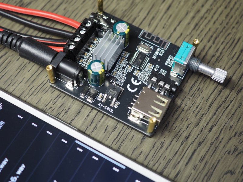

I played a 1.2 ohm speaker on a Bluetooth amplifier base for about 2 hours.

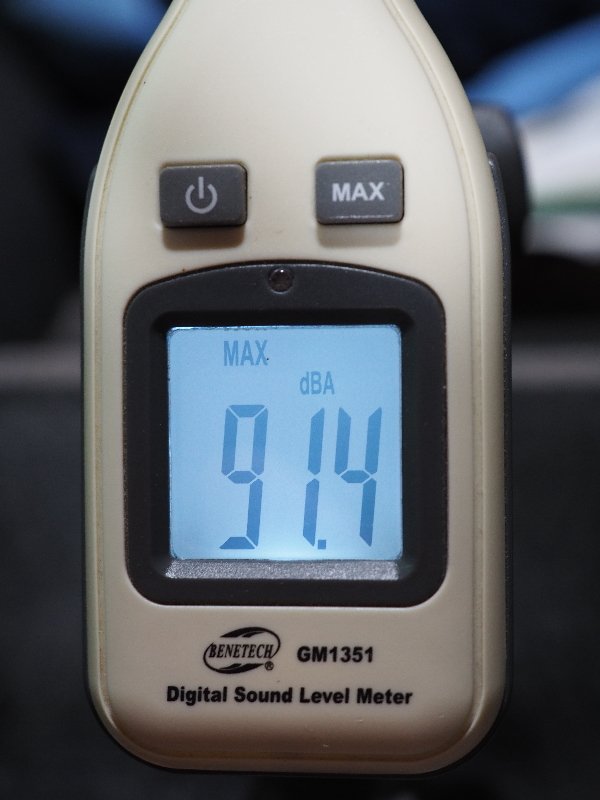

The sound pressure during the air recording was measured with a sound level meter (Benetech GM1351), and at 2.5 meters it was 91.4 dBA max.
The average sound pressure of Iron Maiden and Metallica was high, but it was surprising that Andrea Zonn's max sound pressure was higher.
The amp sounded without breaking, although the heatsink was getting hot with a lot of distortion due to the 1.2 ohm load on the low-cost amp.
