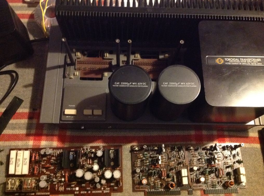

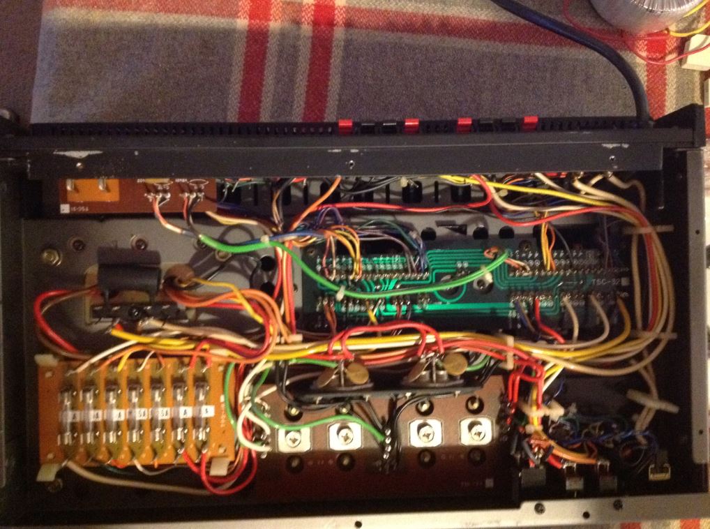

Last night I pulled apart the JM-S7 to see how it was constructed. The underchassis just looks like generic electrical wiring, no electronics at all. It was an untraceable mess because everything goes to a pair of finger sockets, into which two PCBs plug from the top of the chassis.
According to the sound at background levels I was expecting el-cheapo components, and I was not disappointed. Lots of disc ceramics, low-end electros, polyesters and carbon resistors. There are also at least three dual diode packages, although they are not the same unreliable parts that killed so many Sony units thankfully.
I won't be performing any mods. The only way to do that properly would be to trace the whole circuit and design new plug-in PCBs and frankly it would be more productive to simply design a new amplifier from a blank sheet of paper, tabula rasa.
Enjoy the happy snaps.
Extended listening continues. I'm pretty sure that in the days of vinyl with its inherent backround noise this amplifier would have seemed perfect, but on most low-res digital source material the overlay of the amplifier's character becomes annoying, even if it does sound sweet. I prefer something more accurate myself, but for that I'll have to personally design something better, which is a tall order.
I've also discovered that there's a channel disparity and I've had to push the right channel volume preset about 20 degrees further than the left. I've eliminated all else, it's definitely the Victor. It probably needs a good alignment, but of course there's no data on how to do that anywhere online.
On hi-res sources (24/96 and better) or on low-res sources at reasonably high levels it is as good as anything I've heard. Definitely a keeper, this one.
