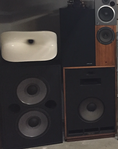

Some 1"s can pretty comfortably go lower than 1k, too- I specifically use the JBL 2426 for its midrange capabilities, but it's not a great option to EQ for a 2 way, the top octave is well damped but not clean (so if you EQ it up it sounds bad). I use a supertweeter but the 2374 horn if you can find them are quite impressive for anything 1" throat, I can actually very comfortably cross at 700hz with the right driver (like the 2426). Extended low frequency capability and the smooth profile with good directivity (not really CD in the top octave, duh) makes it a real winner. Even when you're not crossing low, extra bandwidth at the low end helps ensure all frequencies behave well (30"W mouth good)

I can see your processor is a dbx. What are your woofers? Paper, no ribs, M115-8As? Have you combined two horns back to back ? I see the lower one is upside down (downside up). Maybe you're trying to undo the asymmetry of 2374.

The woofers are BD15- underhung high efficiency low-mms 16 ohm dealies from BD-Design. They are among the flattest cone transducers I've measured with a high end with narrowing beamwidth but flat up to near 5k- without notable breakup, like the also excellent and much less efficient JBL 123A/2213.
The horns are arranged that way to maximize pattern overlap between the two- it's a supertweeter on top. There's very good overlap at about 6' out from the baffle face, and the driver selection and a bit of tilt provide reasonable physicial time alignment (the 2426 has an extremely long throat and is the lower driver, closer to ear level typically). There is comb filtering but not bad at all.

Nice Badman, and a good example of the size needed to attend to the issues that are compromised when crossing around 700Hz with a smaller waveguide.

The passive XO is at about 3500hz, it's an opportunity for refinement as it's currently a simple setup that wants some love. A slight tilt is applied for time alignment but really it's not a big issue. The 2426 has a natural mass falloff above 4k and the little ring radiator doesn't want to reach low at all, so they kind of play nice. By 6' from the baffle anything over 30" in the room has good coverage. The width is misleading on these horns- the aspect ratio is not extreme and the vertical pattern defined by the horn is about 12" tall BEFORE the mouth roundover. Because the drivers are further back on the larger horns, they have already developed a pretty robust vertical pattern size to work with by the mouth. The overlap area probably doesn't maximally overlap for a good 20' if you wanted to be obnoxious with an energy analysis, but most of the pattern is overlapped by 6'.
