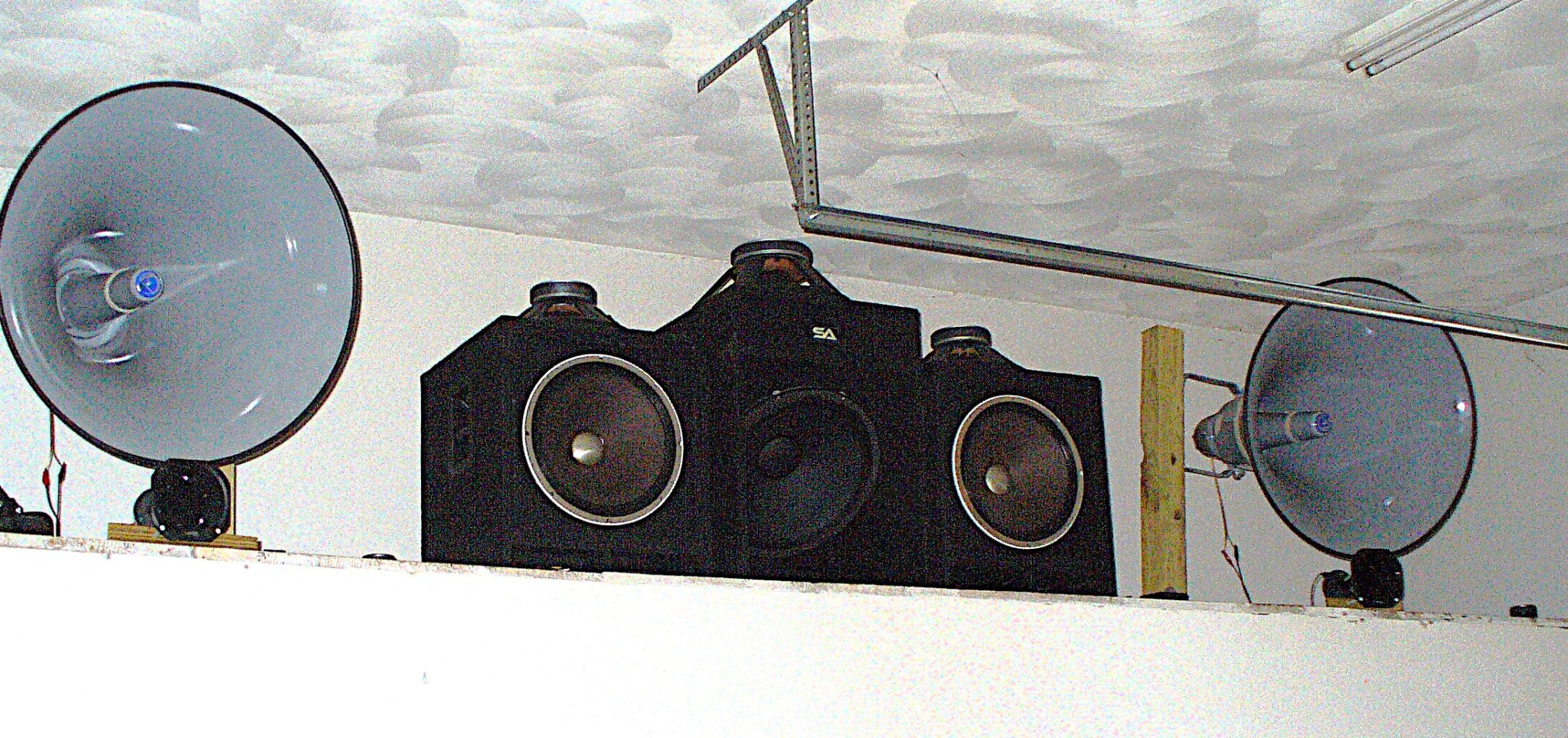

a. Speakers
Loudspeakers are as follow.
Subwoofer (1): This has not changed from 2020. A Peavey 18" Pro Rider is mounted in a Seismic Audio 18" downfiring (about 20* from vertical) sub cabinet with internal crossover bypassed.
Woofer (2): Also unchanged; each woofer consists of a vintage Altec 421A mounted in a Seismic Audio 15" slot-loaded cabinet, again with internal crossovers bypassed.
Midrange (2): Each mid is an Atlas DR-72 re-entrant horn loading an Atlas PD60A driver. The horn has a very long 61" path length and a big 30" diameter round mouth, enabling a very low horn cutoff. Rope caulk is used on the exterior to damp ringing.
Tweeter (2): The very affordable (~$30) Dayton D40T driver, which was modified by bypassing the transformer, is loaded by a DS18 PRO-H110 exponential horn with a 5.43" diamater mouth and a roughly 6.43" path length. Like the mid horn it was chosen to load the driver effectively to a low range. Like the mid horn it is damped with rope caulk. Its near-0 price belies its performance. And the D40T has been enough of an eyeopener that I have replaced my Atlas PD5VH with it. It has me taking a 2nd look at all Dayton equipment.
Supertweeter (2): My Beston RT002a ribbon tweeters have been replaced by a pair of Fostex 025h27. Despite the excellent performance of the Bestons, I was forced to cross over higher than I liked so I decided to give the Fostex tweeters, lying around for a couple of years, a shot. Despite the fact that they needed more equalization than the ribbons (which needed almost none) they permitted me to drop the xover point by about 2khz, and I am tickled with their resonant frequency (1.9khz) being another 2k or so below the range for which I use them.

That's it in a nutshell. Here's a pic of the speakers. Note that the small horns don't show the D40T drivers, nor are the Fostex tweeters evident; I'll update the photo at some point.
