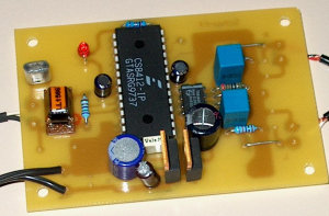

Regarding PCB vs. p2p, I agree that pcb provides more convenience and better look and I don't think that wiring p2p has such tremendous advantage as some people try to portray.
But I also believe that going into 3D layout has its advantages and in many cases simplifies connection and make them much shorter (and actually "looking better"). That's why I will continue using combination of PCBs and 3D layout.
My thanks to Jonathan Carr for inspiration 😉
PS: Especially in case of CS8412 and TDA1543 connecting I2S lines is not that simply and placing the DAC on top of receiver makes things much easier. And the length of that lines is important, I presume. Same goes for shared and compact ground plane.

Sorry, no groundplane. Some parts are under the board in case you think it is underpopulated. This was my very first prototype PCB of a TDA1543 DAC as discussed on the Amp board. I2S lines are very short. I am 15 versions further ( not all actually built ! ) in time but still not totally satisfied with the final version. That one features some 3D as well ( you'll need the special 3D glasses however 😉 ).

What a lovely build, as usual for Peter!
You might try 1000R i/v resistors, found to be nicer by the "attack of the clones" tda1543 project.
I guess resistors values depend on supply voltage as well. I've built 5V DAC with all 3 resistors being 1000R, but I prefer the sound of this one with 8V supply and 3K for I/V resistors. The DAC seems to be more dynamic and 3 dimentional.

Doesn't that 1543 run rather hot with an 8v supply?
Just peeking at the data sheet ,I note a max dissipation of
250mw...
I do not recollect seeing any measures being taken to
keep single chips cool.
[ well, other than the dead bug on a ground-plane approach ..hehe]
..Seems like a cue for one of my excessive heatsinks!😉
But I do worry though...

I didn't notice any particular high temp of the DAC chip. It is also attached to the ground plane, which being made of copper foil, also takes some heat away.

It is to avoid "latch-up" at power-on. This occurs when one of the supplies is slower at power-on than the other. Chances are small that it happens but when fed with a transformer with separate windings chances are bigger. I had it once with a first version of a DAC ( chaos-wiring, some power transformers etc. ). The differences in power on leave the chip in an undefined state when it happens. In the case of CS8412 you'll notice that it won't lock.
With the older 78xx regulator series this "latch-up" happened quite often when a symmetric supply was realized with them. In older schematics of symmetric supplies with IC regulators you'll notice the diodes ( in reverse of course ! ) from output pins to ground to avoid "latch-up".
If you add the antiparallel diodes you'll never have the phenomenon, they don't add much to the total costs and they won't bring significant negative influences AFAIK. BTW it wouldn't surprise me if newer revisions of the CS8412 have those diodes already built in to avoid damage to the chip.
