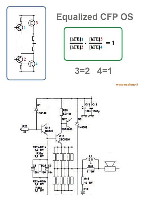

equalized CFP Output Stage
ciao
inside CFP there is a big gain
that is an "HIDE GAIN" because at last global gain is 1
but if you see the single gain of each device
this are different and different is the speed in each rail
my idea is using the same devices of final as driver
that build an equalized CFP Output Stage
in picture there is an axample of Suplifier Modification😎
ciao
